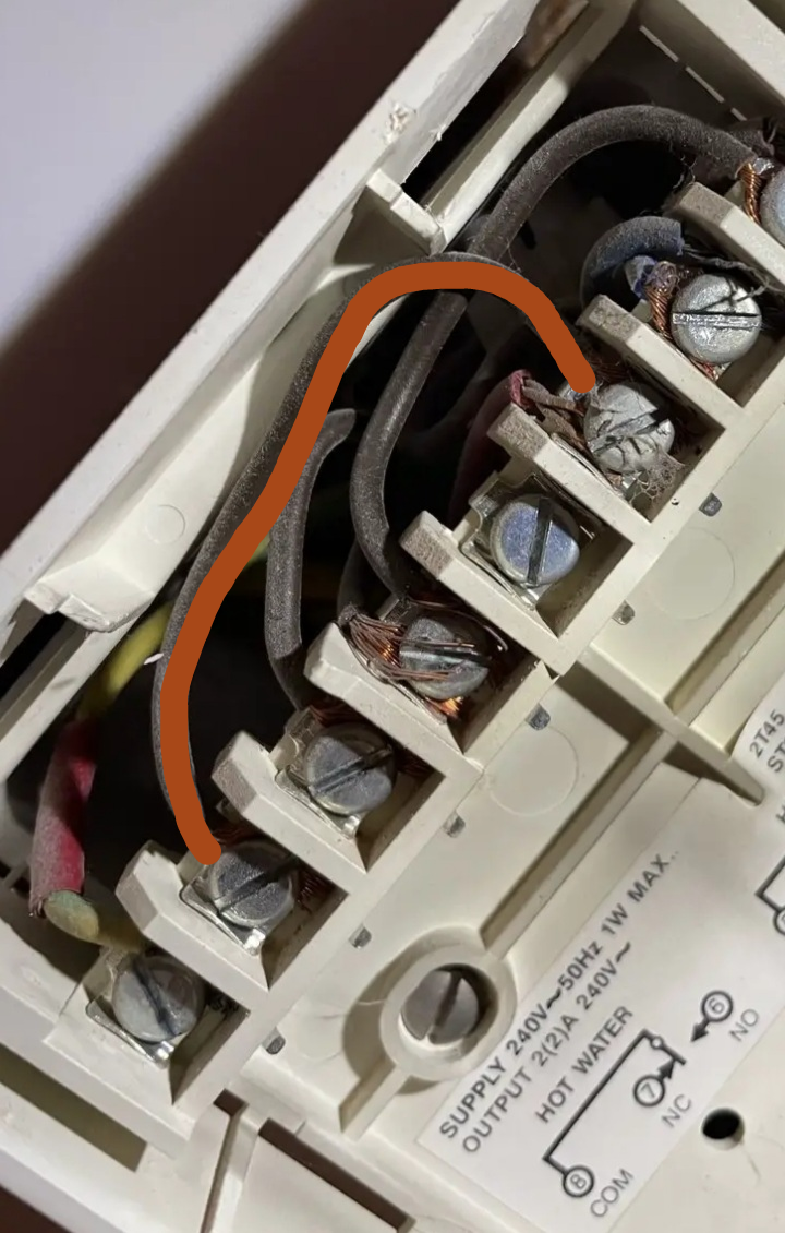

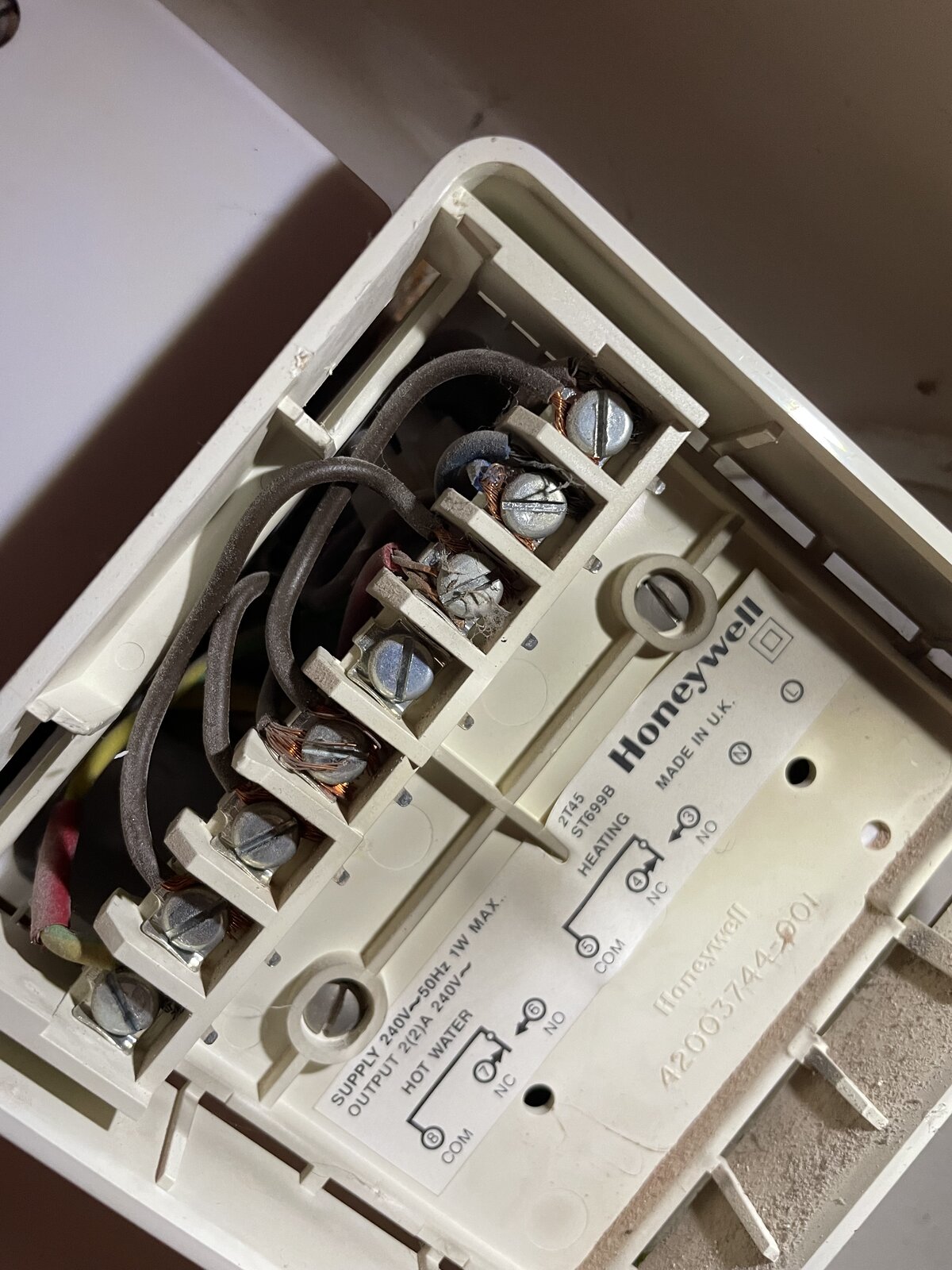

Hi How would you wire this new programer to the old wiring for an oil boiler
Terminals don’t match up

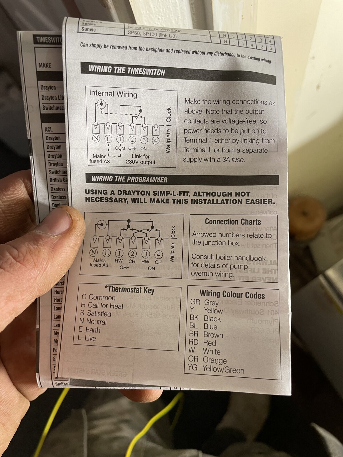

the oil boiler only fires for CH when HW is on if you go by the instructions for new programmer
Which instructions have you followed? There’s 2 diagrams there.
You only need L N, heating no, hot water no and hot water off.
I went by the diagram at the bottom so I guess that’s correct for a programmer that controls heating and hot water but when you leave hot water off and just turn on heating the oil boiler wont fire but other way round and it does fire so I’m confused
Trace and draw out what you have at the moment then compare.
Don't assume the existing stuff is as you think.

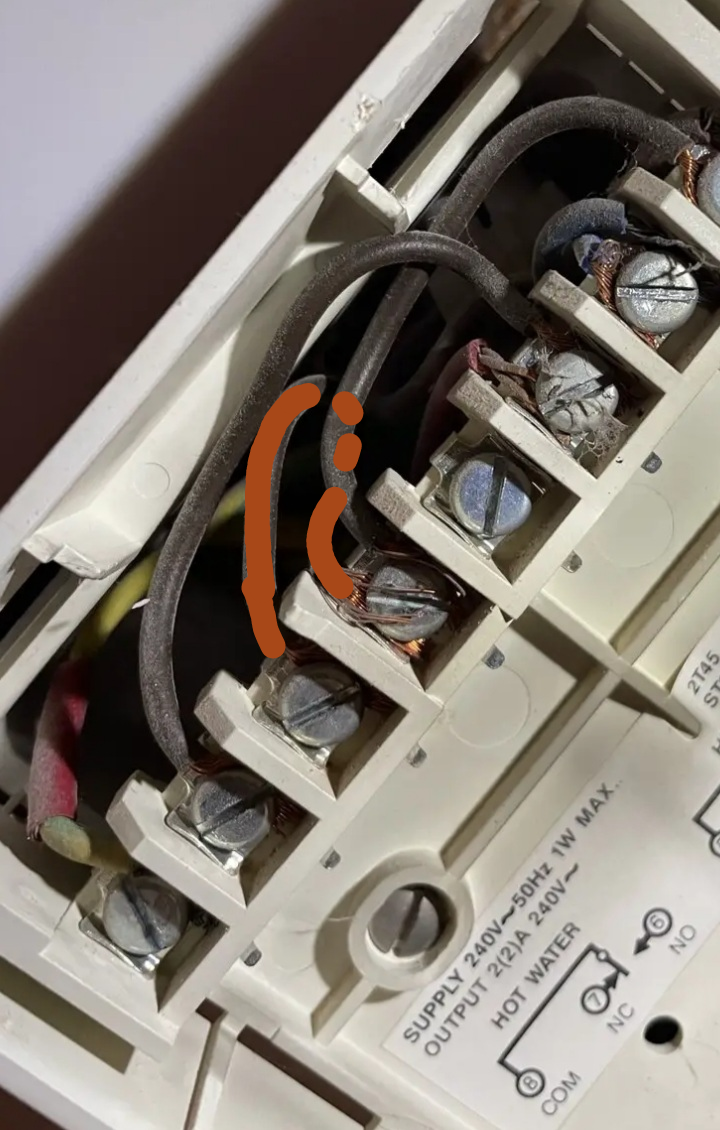

Based on how it’s previously wired number 3 and number 8 cores may not be hot water and heating?

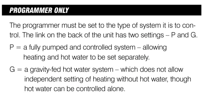

It appears you may have a gravity system, with the wiring set up as in this thread...
What is the model of your new programmer?
Some have the option of a 'gravity' mode, some don't.
New programmer is Drayton LP522 I believe
It looks like the LP522 has a gravity mode option on the rear...

It's difficult to fully see the wiring in your programmer, so it will be up to you to confirm how it is connected up.
As I see it, there appears to be:
Two blue wires in N, these would move to N on the LP522.
L to L
Yellow (oversleeved red) in terminal 8 to H/W ON (3)
Red in terminal 3 to C/H ON (4)
There won't be a need for any further link wires, as the gravity mode of the LP522 should take care of the switching.
But again, as earlier, you will need to confirm your existing wiring looks something like...

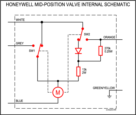

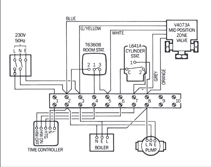

There seems to be a connection to DHW N/C so to me that points to Y Plan. With the Y Plan the motorised valve doubles as a relay for central heating, but DHW goes direct to boiler Y-Plan.jpgmid-position-valve.jpg so if one of the V3 micro switches stick in the motorised valve then often you can get it so the CH will only work when the DHW is called for, often latching the motorised valve to the bleed position will allow CH to work, but then during the summer when DHW is called for the radiators get slightly warm, so only a temporary cure.
What I am saying possibly you have wired it up correctly, and in the past some one may have latched the bleed lever on the motorised valve and you have knocked the lever unlatching it, so the fault has become apparent.
Question must be what motorised valves if any have you got? In general C Plan no motorised valves, S Plan two x two port valves, and Y and W Plan three port valve, the Y plan the three port valve has a mid position, the W plan DHW takes preference, the W Plan is normally within the boiler where stored DHW is very small.

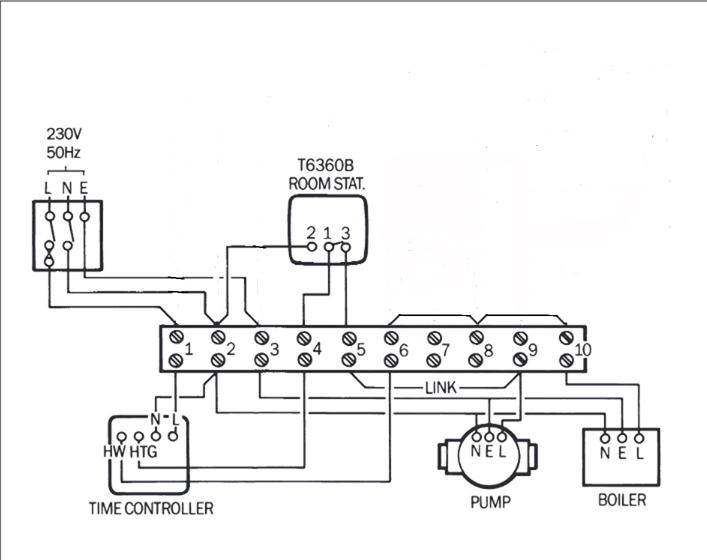

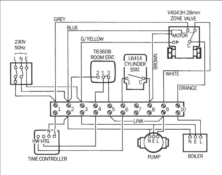

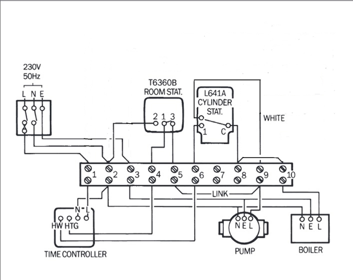

There do seem to be three versions of C Plan, C-Plan_old2.jpgC-Plan_old.jpg C-Plan.jpgeach one uses gravity, but first no DHW temperature control, second summer DHW temperature control and it also allowed boiler to be active 24/7 without it cycling all the time, and the last also gives winter DHW temperature control.

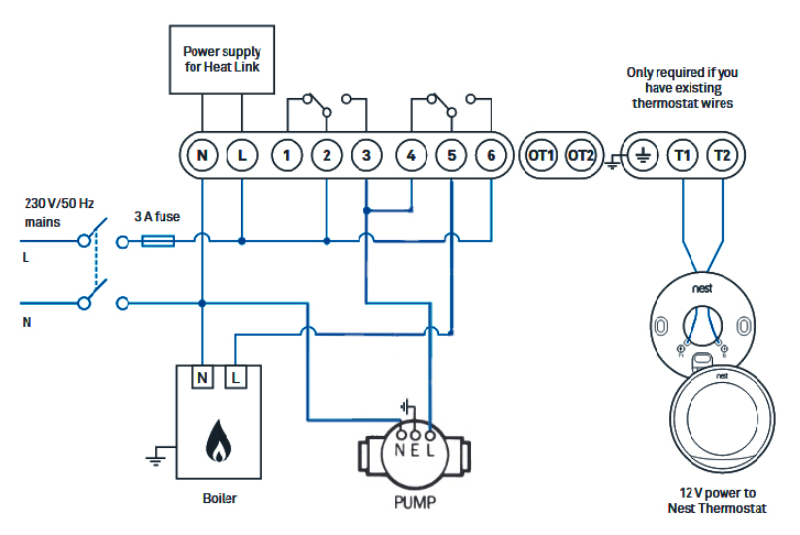

I have the first system. to combine the programmer and thermostat there are two methods, one needs volt free contacts C-Plan_basic_Nest.jpg shown here with Nest the other uses a software fix inside the controller so two independent supplies for pump and boiler this is done with the Hive system.
I have not done a truth table for the second two variants of the C Plan, never needed to, so not looked into it. Had enough problems getting the first version with twin pumps to work, had to add motorised valves and relays to stop reverse flow and get the two outputs from motorised valve one to boiler and one to pump, hence two relays.
But no variant seems to use the N/C contact. Only the Y Plan seems to use the N/C contact as with the Y Plan DHW is default, and the valve needs powering to stop it.
I have never seen a link N/C DHW to N/O CH before, and can't off hand work out why, unless already using a combined thermostat/programmer as shown with Nest Gen 3 wiring where Com is output rather than input, but seems likely if no motorised valves then it is C Plan, but as yet don't know answer to that.
