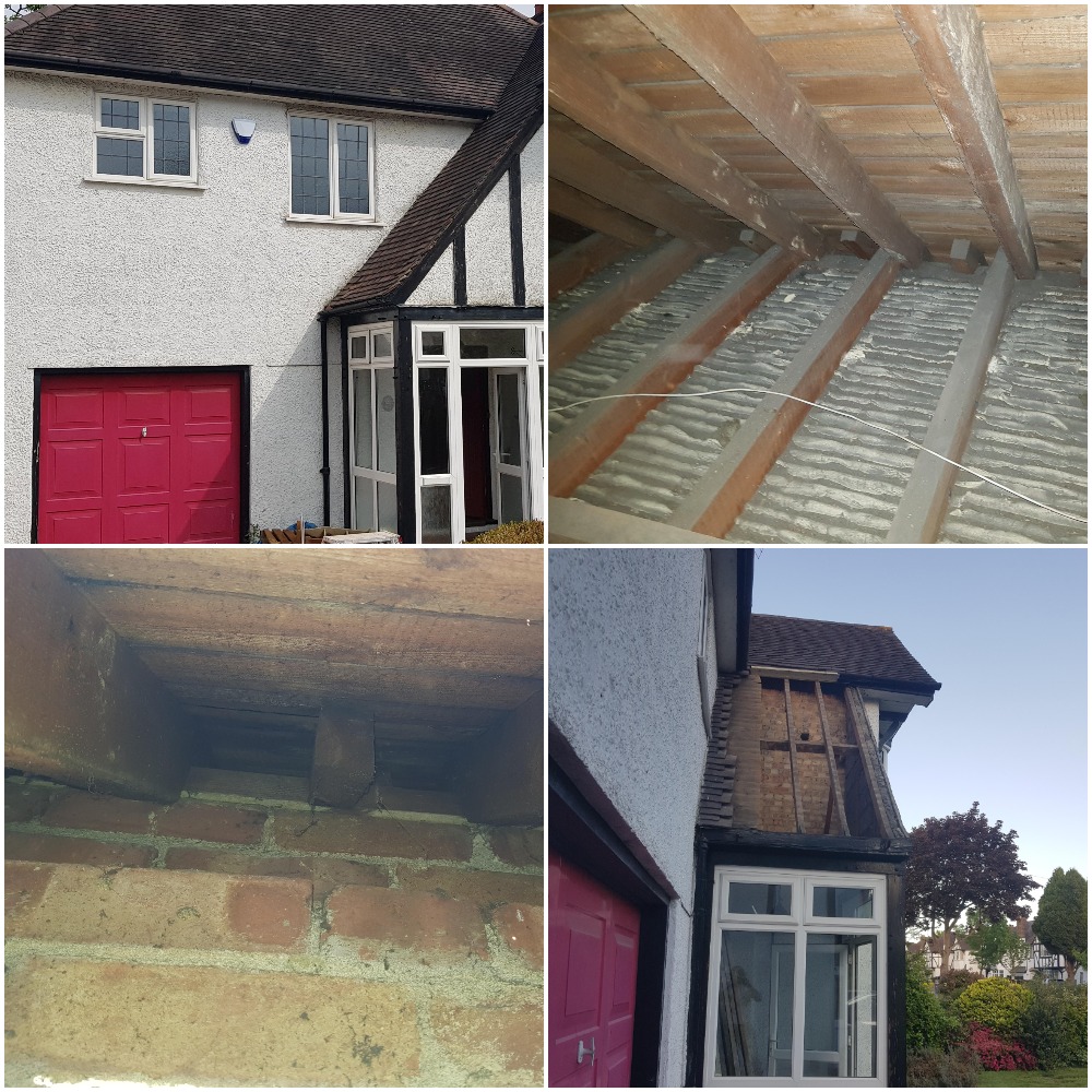

I need to remove the existing porch to dig foundations for my front extension. I had originally planned to prop the rafters forming the sloped roof over the existing porch whilst i removed the timber frame below dug my foundations and rebuilt the roof structure into the extension blockwork.
I will be having the entire roof re tiled as part of the extension, nit just the new bit of roof.
I am now thinking should i just remove them and have rebuilt along with the new roof that will tie into it after the new walls go up rather than try to work round them.
There are 4 timbers in total. The images show how they connect to teh main building within the loft and then from below within the porch area.
Will these give any structural support to teh main roof ro external wall or can they just be cut out. Once the main roof has had the tiles removed i assume fitting replacements will be a simple exercise?

Thanks - So ok to cut them out for the time being?
We are fairly restrained by the planning officer as the road is all similar design. Whilst we have to keep the "slope" this will then be tieing into a roof at 1st floor level when the extension is built. We are thinking of ways to put our own spin on it whilst maintaining the original look.
At the moment the ceiling in this area is standard 1st floor height. We definately want to open that up to follow the roof line and give max ceiling height.
