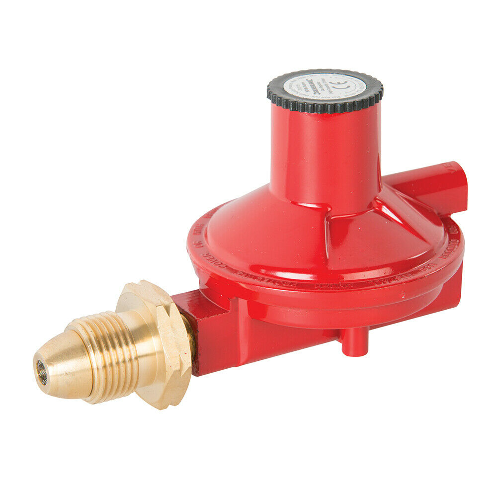

I had a canister operated gas weed burner for years which worked well, but was costly to run as the canisters did not last long.
I decided to buy a more heavy duty propane gas wand which connects to a large propane tank on a trolley. This is the sort of set up roofers would use whilst working with tar etc. There are plenty of these on the popular selling sites.
However, I cannot get it working correctly at all. There were no instructions covering the issue I have.
I have it connected to a new calor propane cylinder via a 35mbar propane regulator. The flame is very weak, and only slightly stronger when I pull the handle.
Are these meant to be used with a regulator or connected directly to the cylinder? Having said that, I cannot see any connector of the POL type that would be suitable to connect directly to the gas hose I have so I presume they are meant to connect via a regulator. Basically, the flow is poor and I am not getting the blue flame, nor jet like effect I was expecting, which is what these burners are for. The pressure and flame I get is orange, and probably more suitable for a barbecue.

What do you mean by screw the regulator down? Whilst on the regulator subject, Im a bit confused. I have mine connected with a standard 35mbar regulator for propane. If I look up regulators for roofer torches (which these weed burners essentially are), I see reference to regulators like these,

Yes, I know about the thumbwheel. However, when I turn mine up or down, its goes from a small weak flame to a larger weak flame. Im missing the jet thrust and blue flame I should be getting. Starting to think it might be the regulator, although I can't for the life of me see how changing the 35mbar one I have for a 0.5 - 4 bar one would improve things? Surely that is reducing the flow even more??

Got to the bottom of this myself, and maybe a note of icaution for others buying these for the first time.
They will not work on a typical 35mbar propane regulator, the type you would use with say a bbq or patio heater.
They need a high pressure regulator of the type used by roofers. What threw me was seeing 35mbar on my regulator, and 4bar on these high pressure regulators. I missed the "m" in front of "bar". Of course, this means a standard reg is 35mbar and the High pressure is effectively 500-4000 mbar (or 0.5-4 bar)!
I wasted money on a second hose and 2 new regs before I caught on. Even the manufacturer hadn't the wit to advise on the type of regulator. Ah well, waiting on the 3 rd reg now, hopefully all well after this.
The top one here is the correct type, the bottom is a standard propane reg and not suitable.
