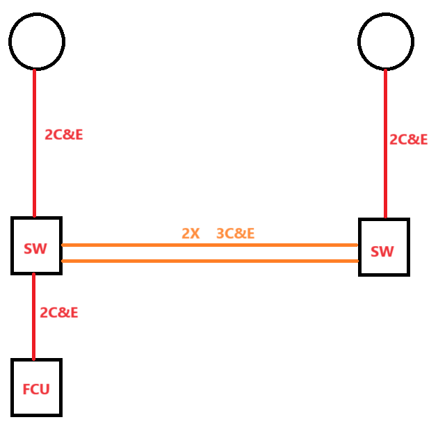

I'll suggest that for the sake of one extra cable chase, one extra switch position and 4m of cable you will be more comfortable being able to switch either from either side of the bed. Think about hotel room arrangements.

Supply each light from the fcu and use wireless switches

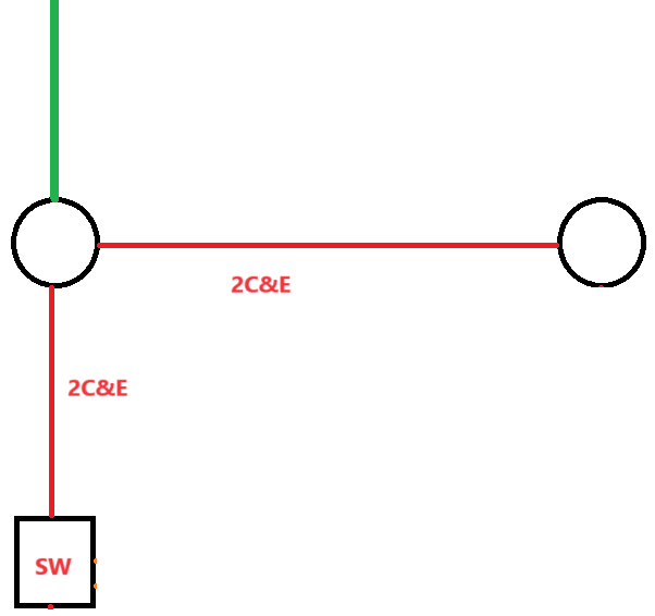

So I guess this is the preferred layout:
And the problem is the piece in blue,
One answer could be to drill at an angle from both directions into the brick behind the dot:
The grey being the plaster board and the pink being the dot.
Second would be to cut a chase in the plasterboard and plaster the cable into place.
And third, if you really dont mind the look, surface run the cable.

I swapped the main switch for a three gang switch (two-way), then two switches either side of the bed two gang (one two-way and one intermediate) and two spotlights either side of the bed, and the main light. So main light switched from any switch bank, and bed lights side they were on and door switch.
