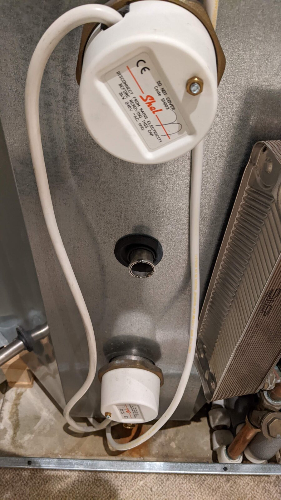

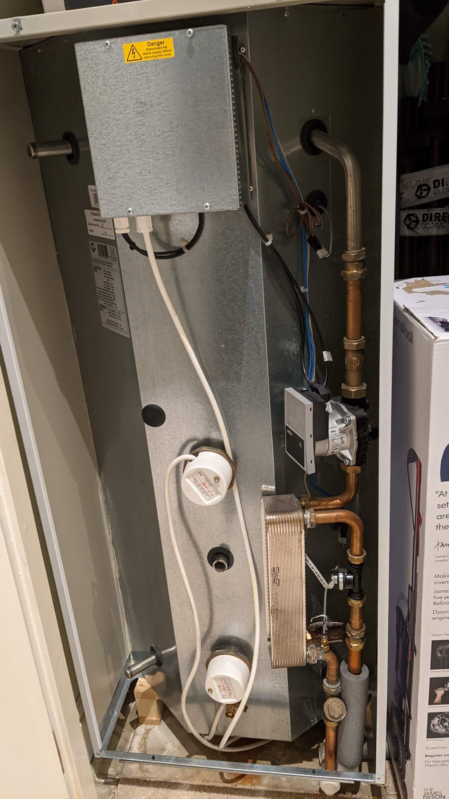

The lower of the two immersion heater elements has failed so only the top half of the tank is heating up ( hot water rises)

A 3kW electric immersion heater raises cold water to hot at a rate of about 1 litre per minute. Due to thermal convection and stratification it will only heat the water at or above its own height.
It is normal to turn on the lower element, often with a timeswitch, to store enough heat for 100 litres or more which is sufficient for a bath. The upper element is turned on, often manually, when only small amounts of hot water are needed, or if the water heated the previous night has all been used up.
Your description suggests that the lower element is not working. This might be because it has failed, or it might be that there is a timeswitch only providing power at night and you did not switch on the element during the night. Or it might just be turned off. These are the usual reasons.

There are no switches or other controls I can see in your pics. Photos would help.
Sometimes the boost button is wired to turn on the lower element, this is not usual.

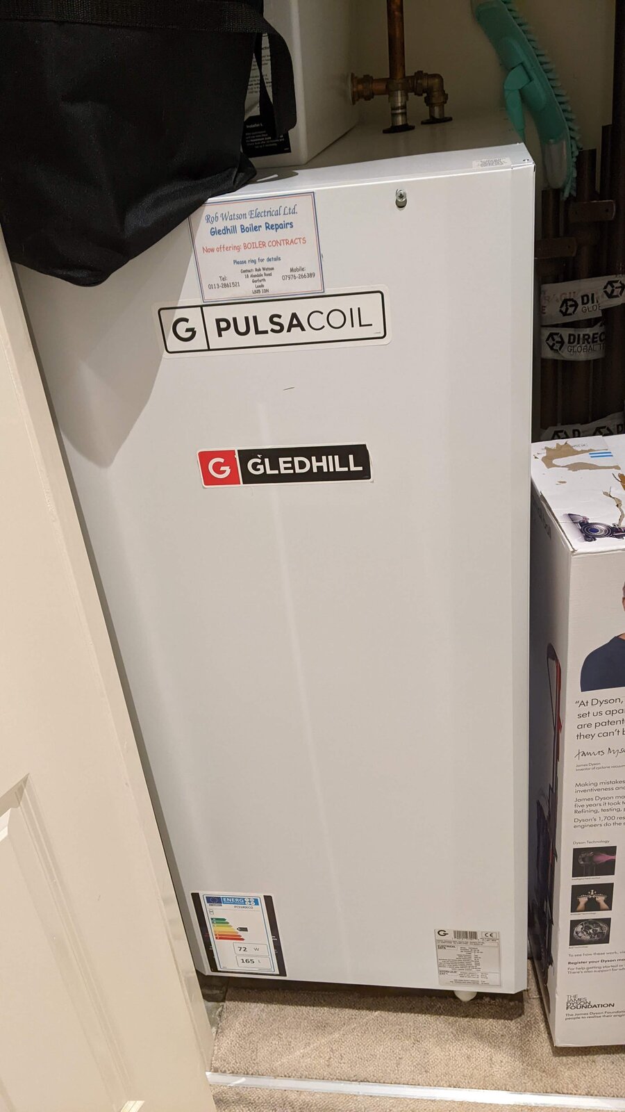

BTW I don't know how big your bath is or how big your Pulsacoil is.
If an immersion heater provides enough heat for one litre of water per minute (which it does, approximately)
Then three hours would be enough for 180litres, which is more than an ordinary bath. Do you have a corner bath or something?
The insulation is very good, so there is not much to be saved by keeping your gledhill cold. You should lag those bare copper pipes, though.

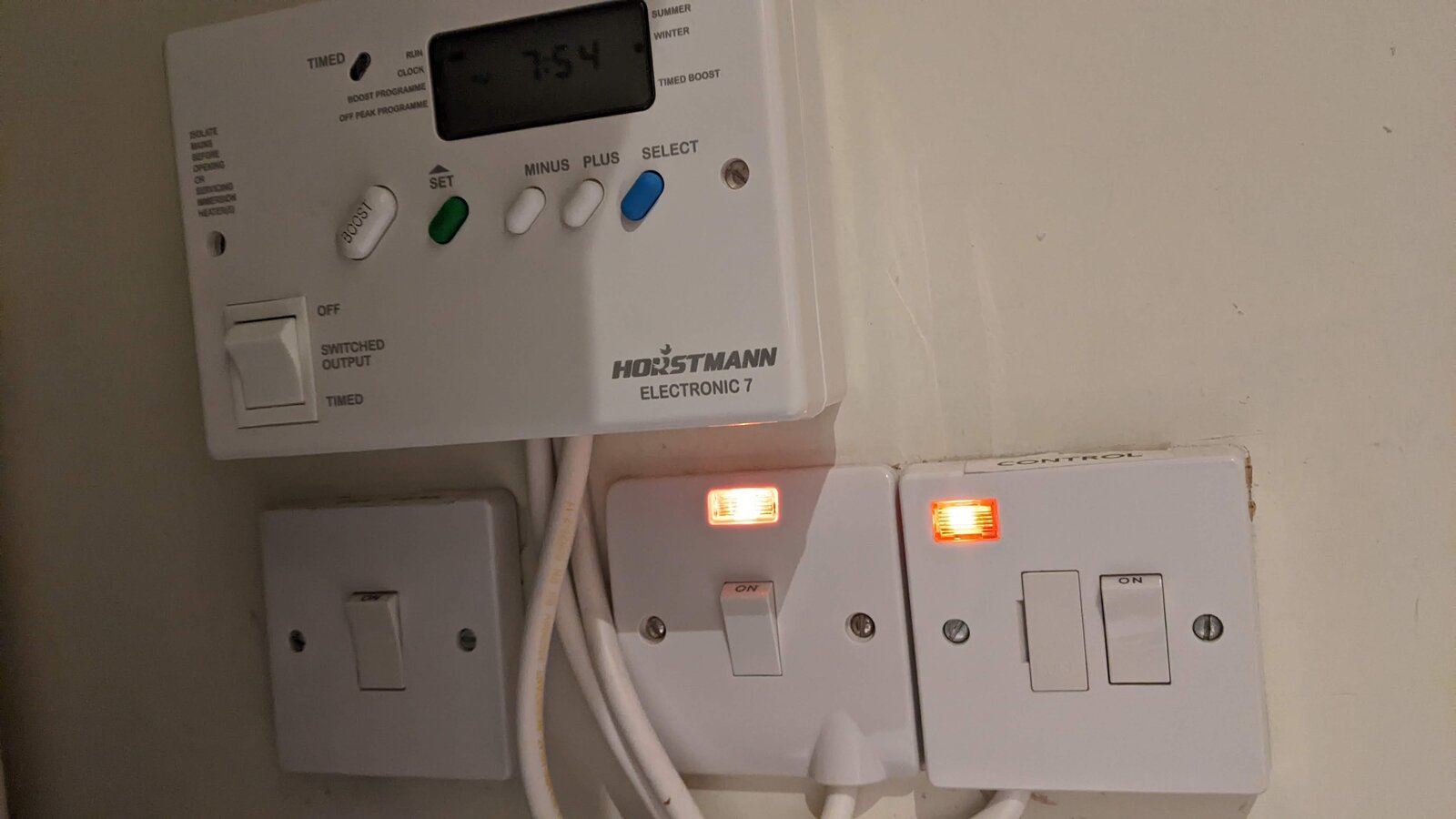

And, I used to have it turned on and run for an hour ever morning then have enough hot water for a shower every day. But as I work from home and live alone I don't take a shower every day and with electricity prices skyrocketing I decided to turn off the three power mains switches below the timer so I only need to flip them and set the timer when I want a shower or bath. The rest of the time I was my dishes, face etc with cold water.
Cost per litre of hot water is the same.
Unless the OP has E7 or similar, and then E7 off -peak should be usually be set to power the lower element, to heat a full tank, at cheap rate. It seems the cheap rate system may not be working.
Show us a pic of the switches and timer please
I don't have E7. It's the same cost day or night for my electricity.

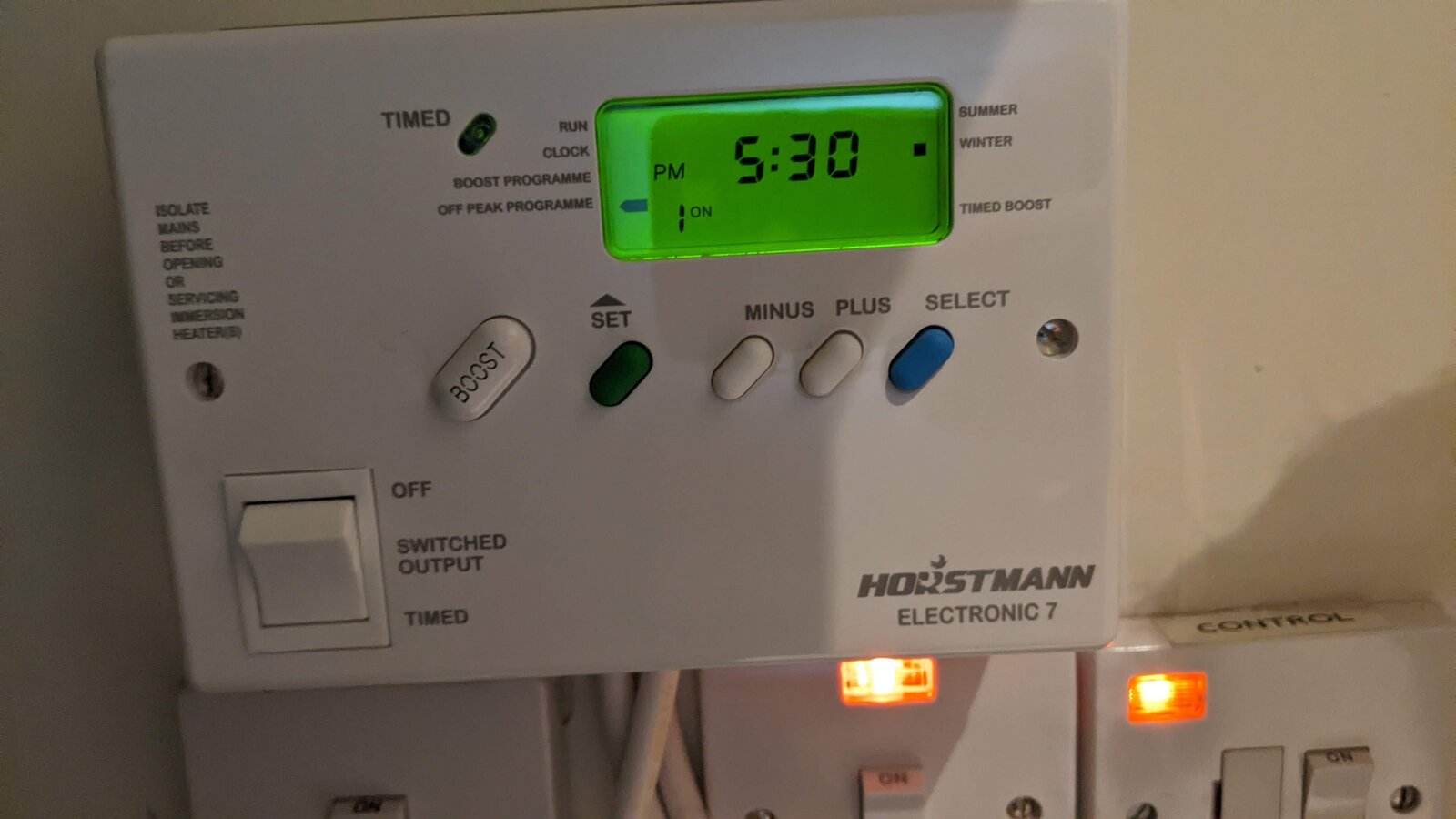

The reason I turn the three switches off when I'm done with my shower or bath is that the timer has three timer settings. So I usually have the 2nd and 3rd one set to something like 'on at 8am and off at 8:01am'. I don't not how to just turn the 2nd and 3rd one off and I was concerned that if I set them to 'on at 8am and off at 8am' they might run for 24 hours. So I figured having them on for 1 minute won't waste power if I forget to turn off the three switches (which I do in fact forget about on in five times).

By the way, when the bath is full and the water from the tap has turned cold, I sometimes put the boost on and quick heat it up while I take a bath so I can shower off after my bath and it does heat the water up again.
I don't know if the boost uses the lower or upper element though so I don't know if this refutes the idea that the lower element is not working.
The boost normally supplies the upper element.
By touching the plastic cap, you may be able to feel the extra heat of an element that is working
