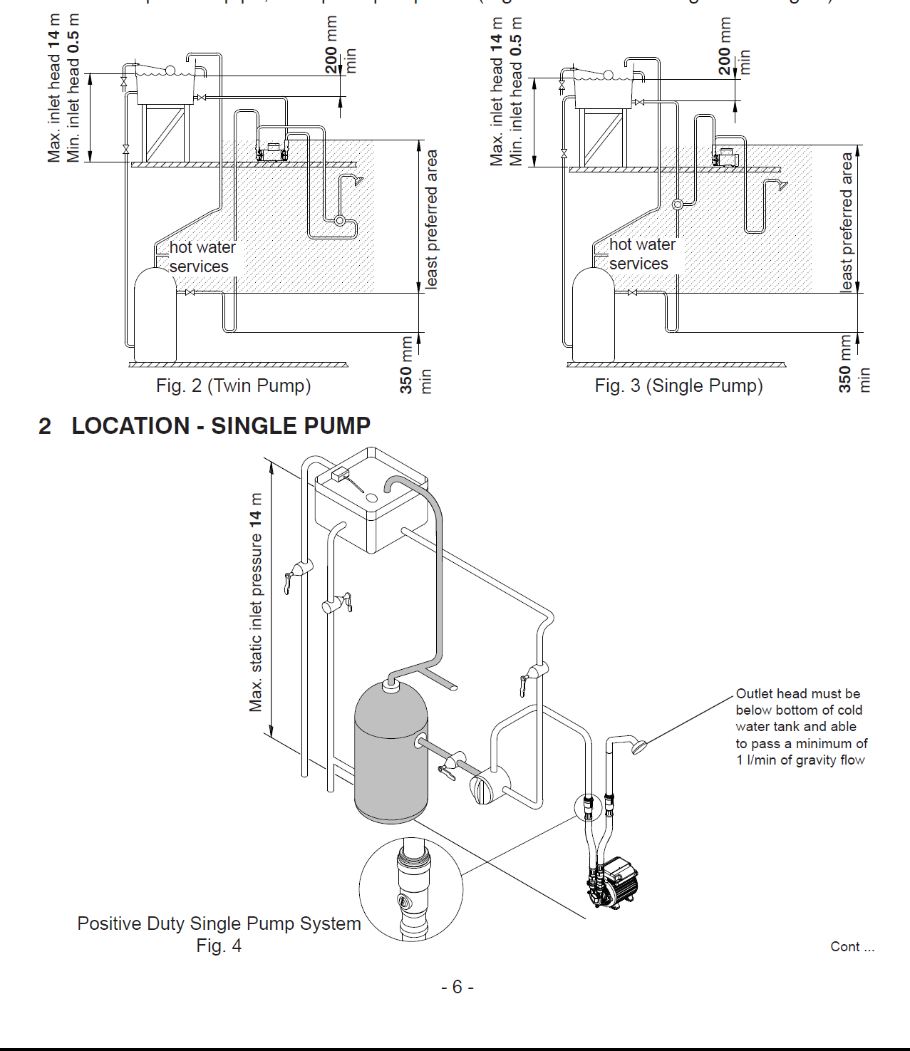

I have recently had to lower the height of my cold water tank (in the loft), which has resulted in a lower pressure feeding my hot water cylinder, which is on the 1st floor. I have a pumped shower at roughly the same height as the top of the cylinder. This now seems to be pumping water out of the cylinder faster than it can fill, resulting in a very poor showering experience! Is it feasible to install a small pump next to the cylinder to pump water from the cold tank to the cylinder (which would stop my daughter from constantly complaining that she does not have enough time in the shower to wash her hair without having to wait for the cylinder to refill)? If so, would this need to be a positive or negative head pump?
Thanks for any advice!!

Can you show us pictures of the vent pipe position over the loft tanks.
Where is the hot water take off point to the shower pump from the hot water cylinder.
A sketch showing distances from CWSC water level when full and when air starts to be drawn, fom the HW Cylinder, pump inlet etc would be useful, is there a Sussex flange (I think its called) installed in HW cyl?
