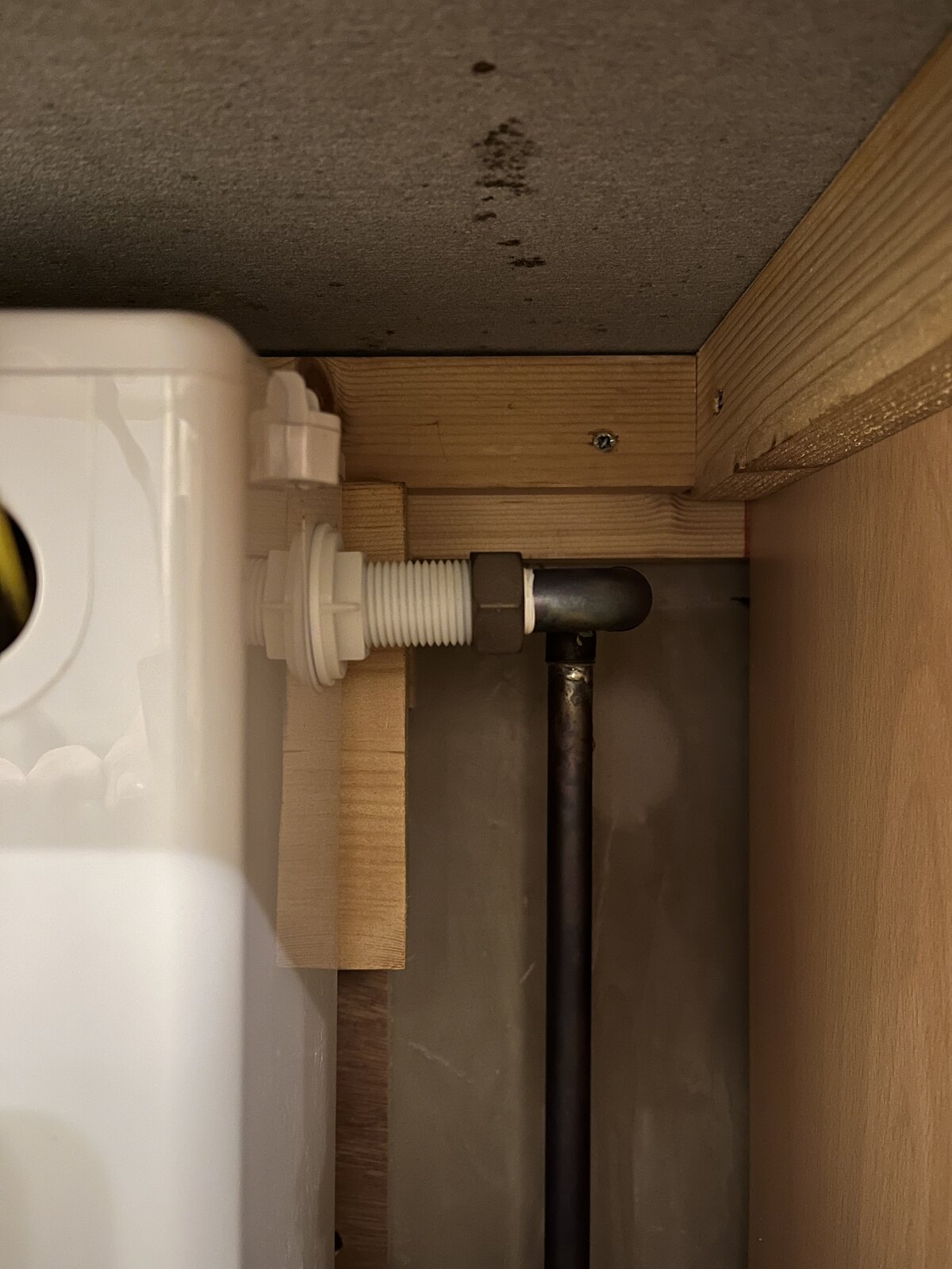

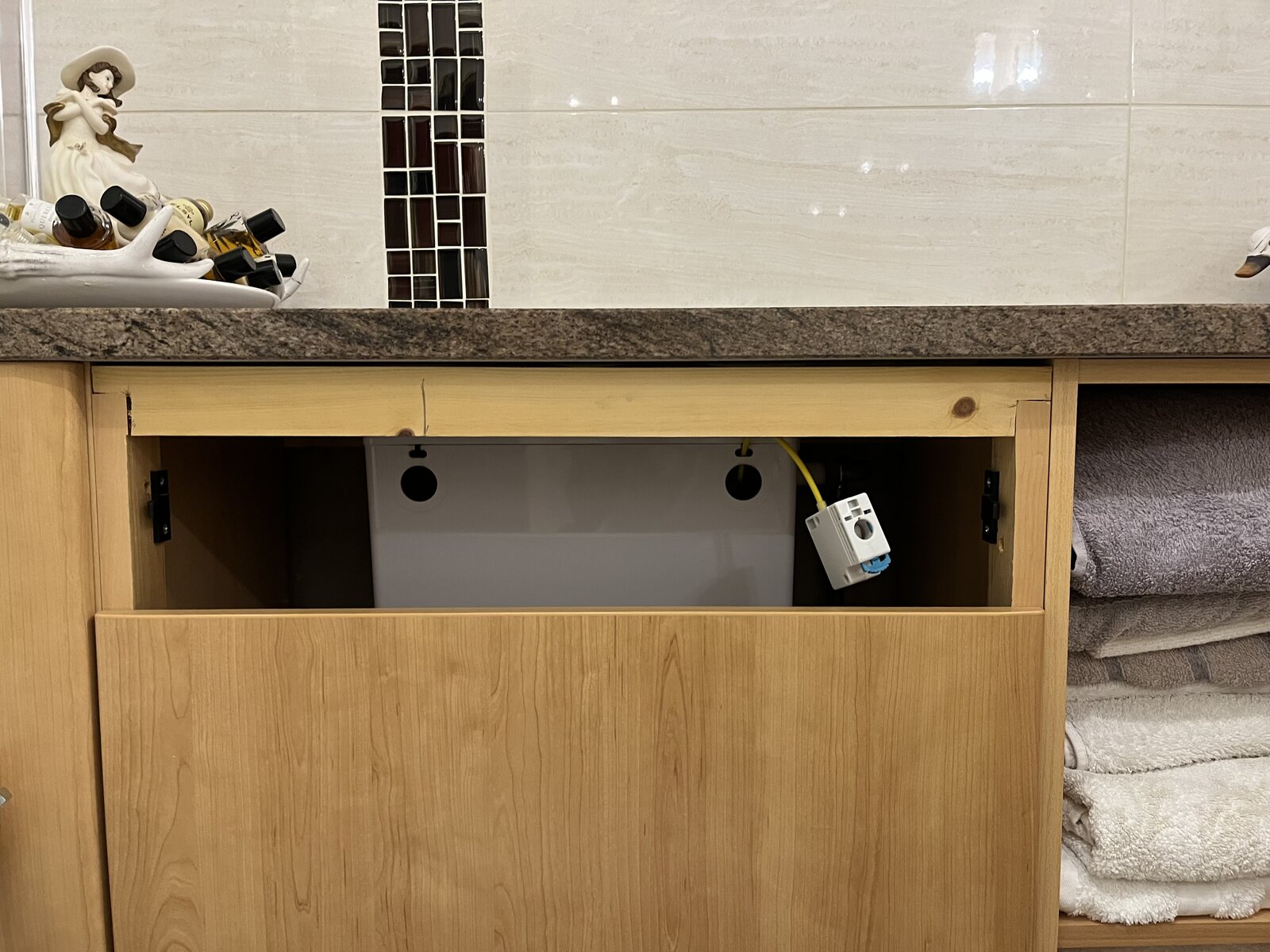

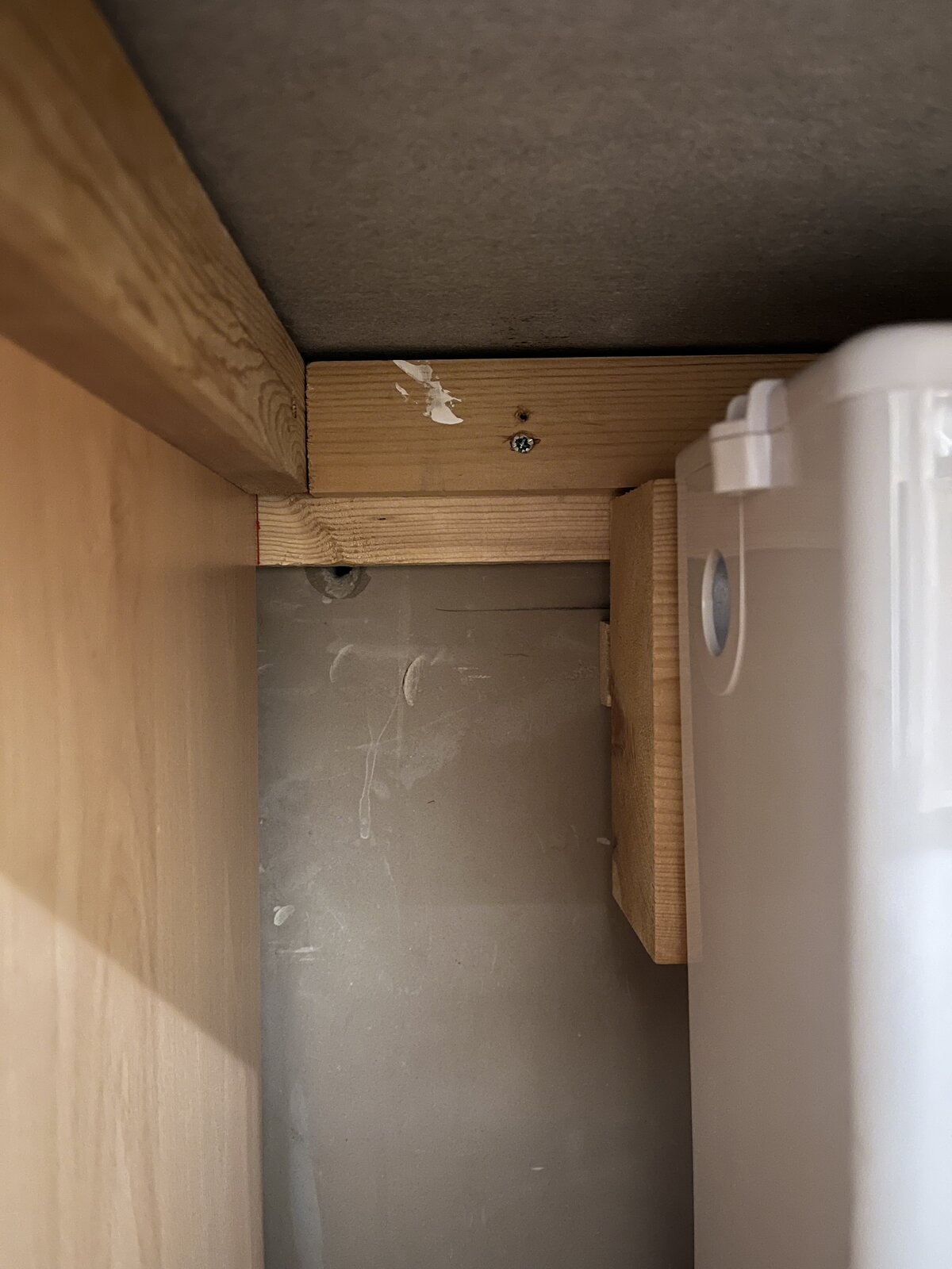

I agree, but
Laughing, you already have a hole! Counter should just lift off no?
No, it appears to be glued - was in when my wife bought the place. Looks nice, but can’t get to anything. Certainly don’t want to risk breaking it
If I could, I would try your idea, but I think I’ll have to try a thermal switch and valve unless we get any better ideas
Thanks,
