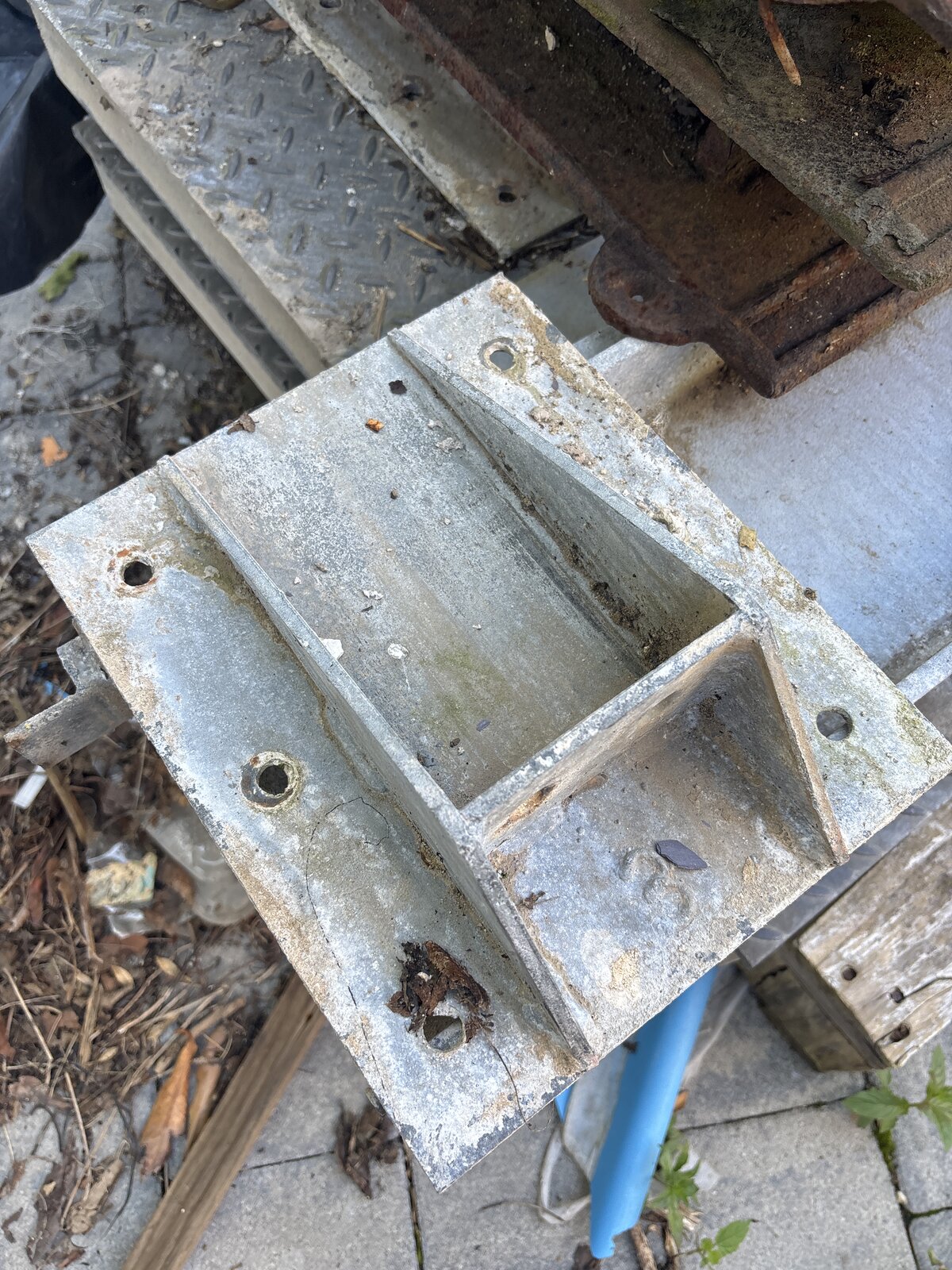

I think I'd have something fabricated that was more like a metal plate with an L or U shape welded to it that went round the purlin end but didn't screw to the purlin so it's supported how a wall would have supported it originally, something like this thing I just happen to have lying around:
Not really but if you are concerned about that just don’t screw the Perlin to the bracket, this will allow sideways movement and expansion in the Perlin, any vertical heave will be taken up by the roof itself.
