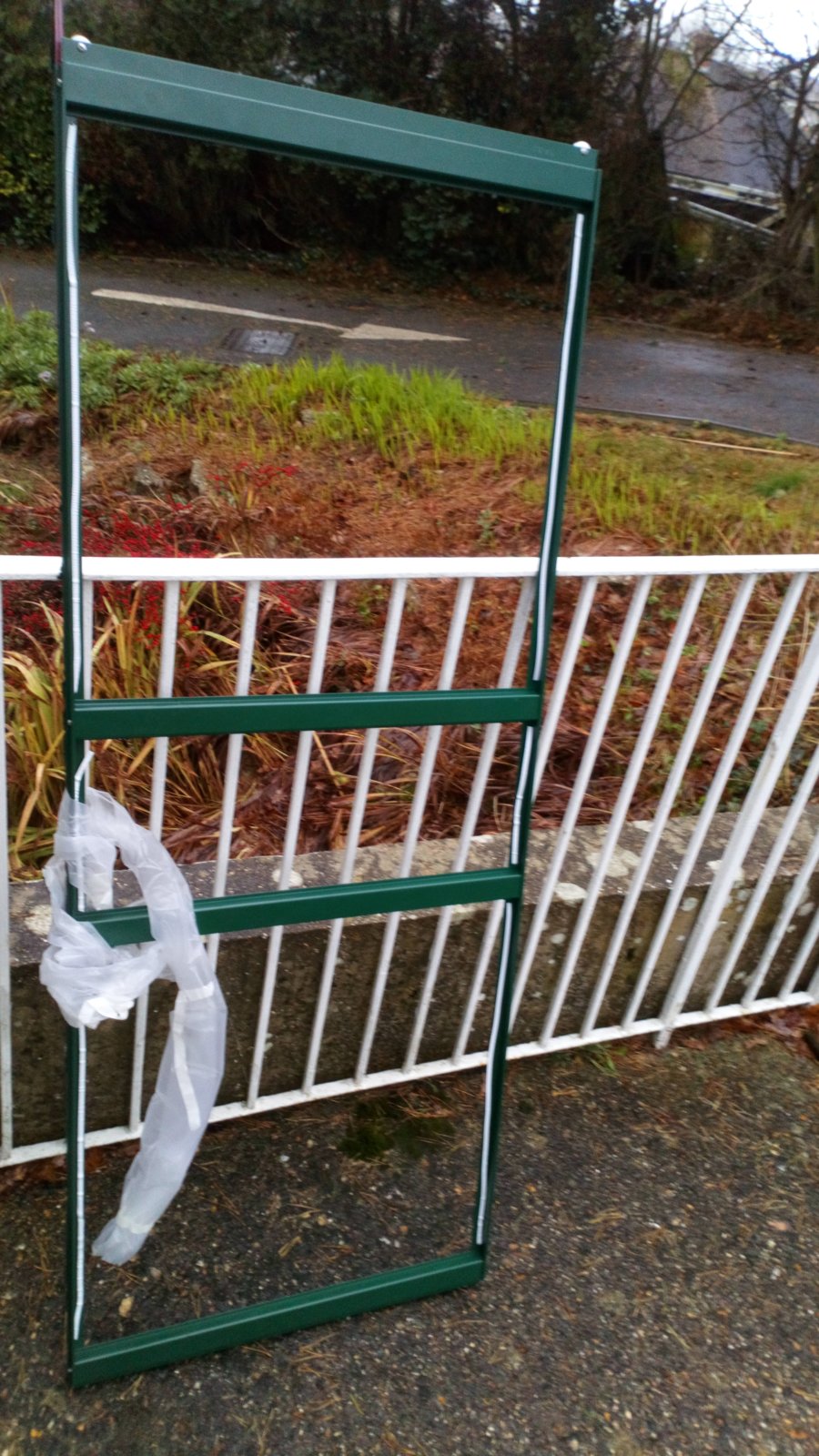

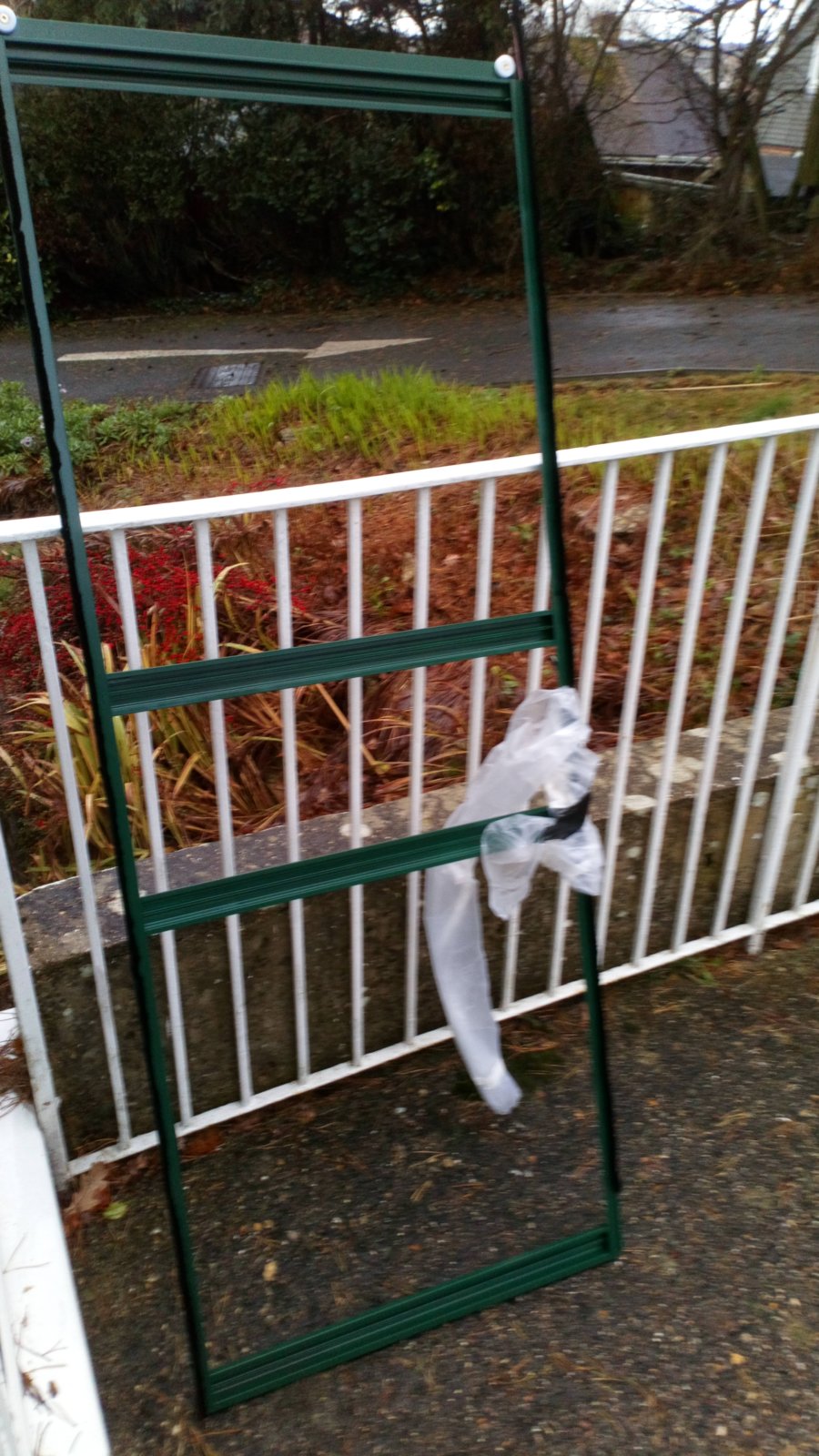

Have found the instructions not too clear. I have found the pictures not in clear in showing which way round the bits go etc
I have assembled 2 sides and a vent and the door in the pix. What's the sticky tape stuff for example on door? Just can't work out if I've put things round the right way etc
it
Foam tape will be to protect glass form contact with metal.Is it double sided tape.?
Tape should be wherever glass makes contact with frame, once you remove tape cover to add the glass must be done accurately as it sticks quickly and does not allow repositioning , ideally two man job with large sheets of glass.

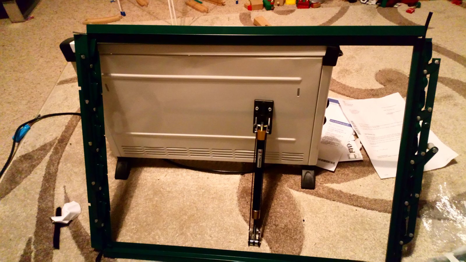

This is a one of vents and opener things. Does it look assembled correctly?

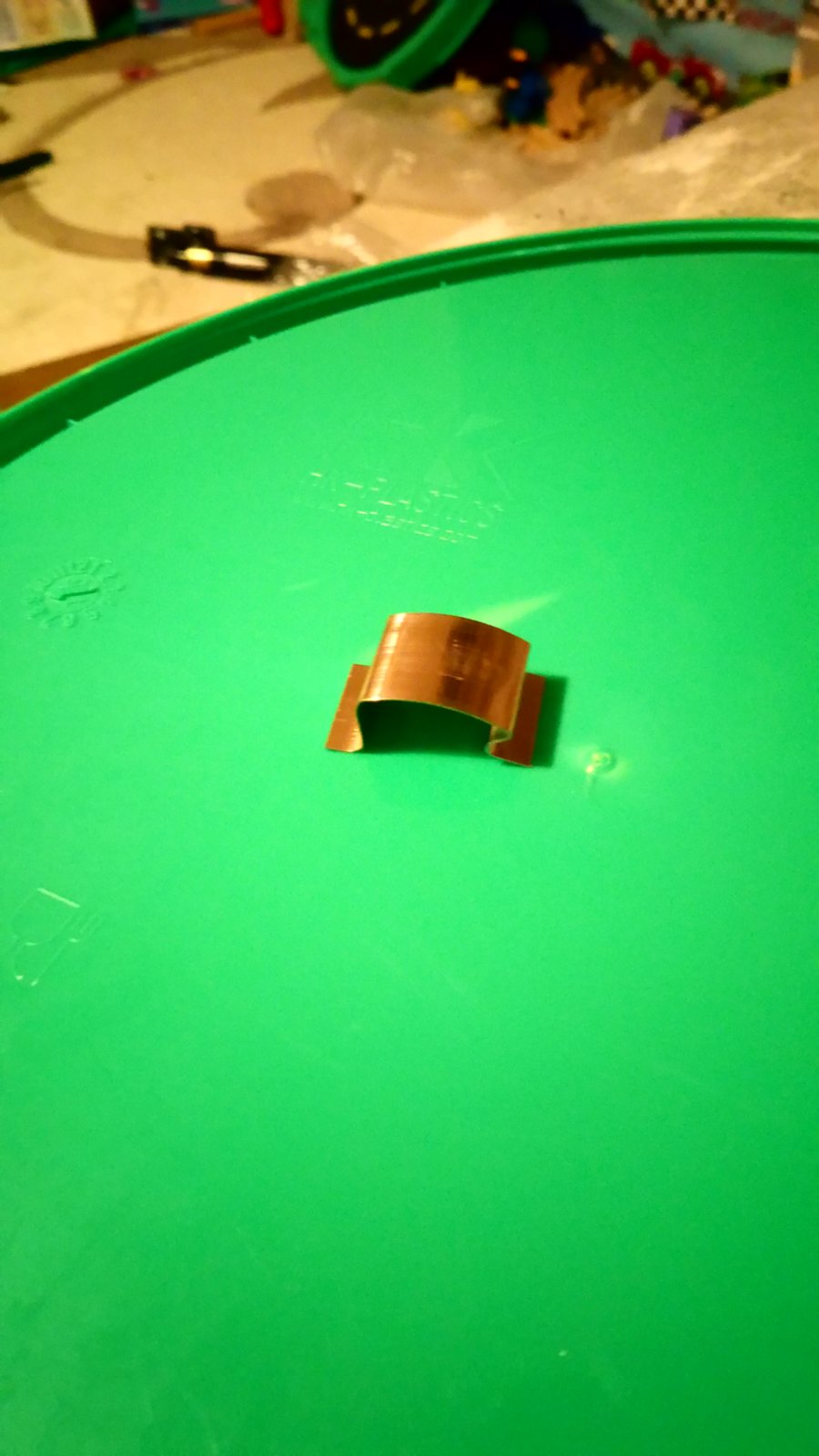

Think these are for holding glass in. Easy to insert?
