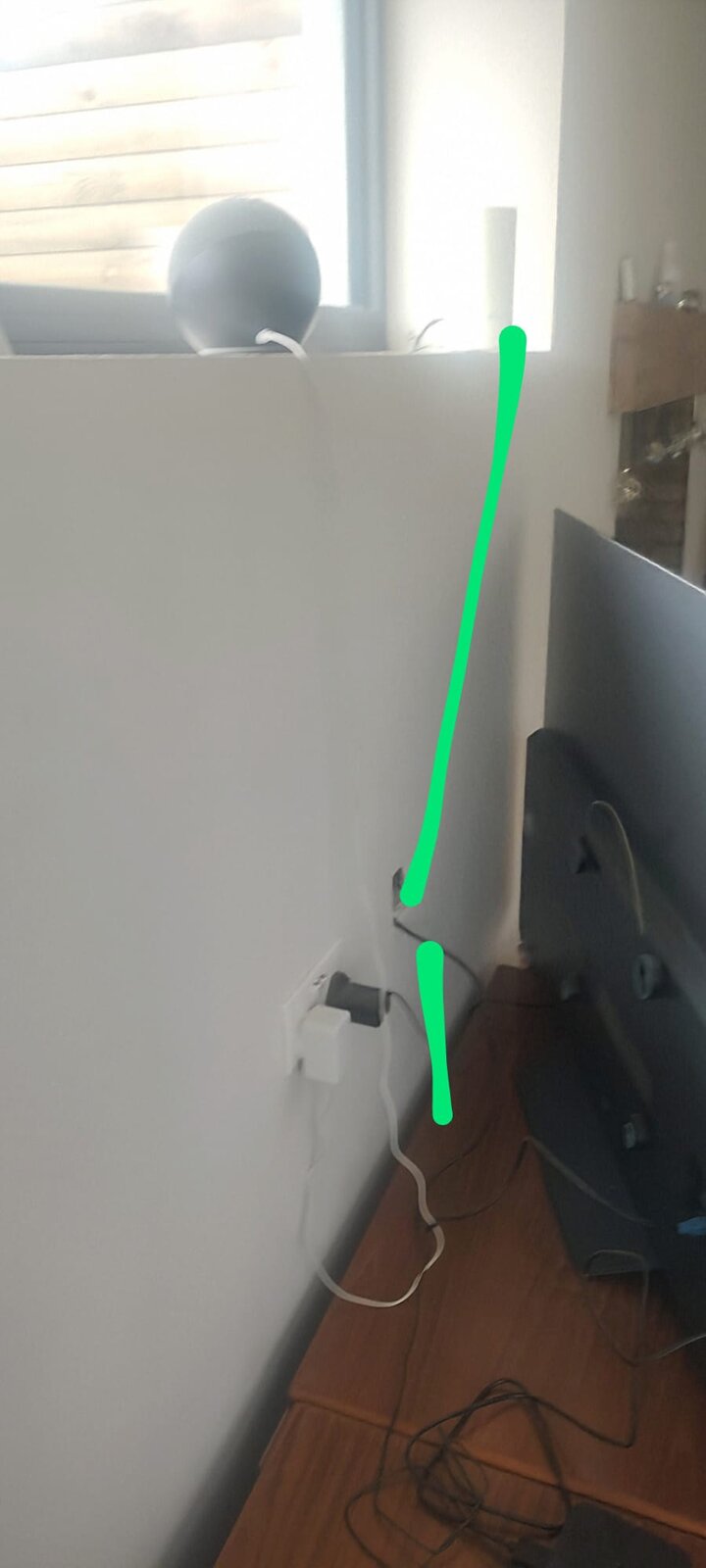

In my install I have a two low level power sockets plus a mid level double power socket.
I also have a low level "open" socket (with router connected Cat6) connected to a mid level open socket (with more Cat6) that then runs up to the window cill via a 30mm piece of flexible conduit. The aerial cable will run in via the window cill when I retro fit it (oversight - eejit)
This arrangement means that I can run low and mains voltage cables and any assorted cabling up and down to any present or future arrangement of required cabling for TV's soundbars and Freeview or Sky boxes etc
This preparedness is learned behaviour where I installed a massively expensive 3m SCART cable in 2006 without any ability to supercede it with any future technological developments
The attached pic show the arrangement with the green indicating the conduit. My TP Deco is hardwired and low-voltage hard-cabled for power. I haven't been brave enough to do the same for Alexa as yet

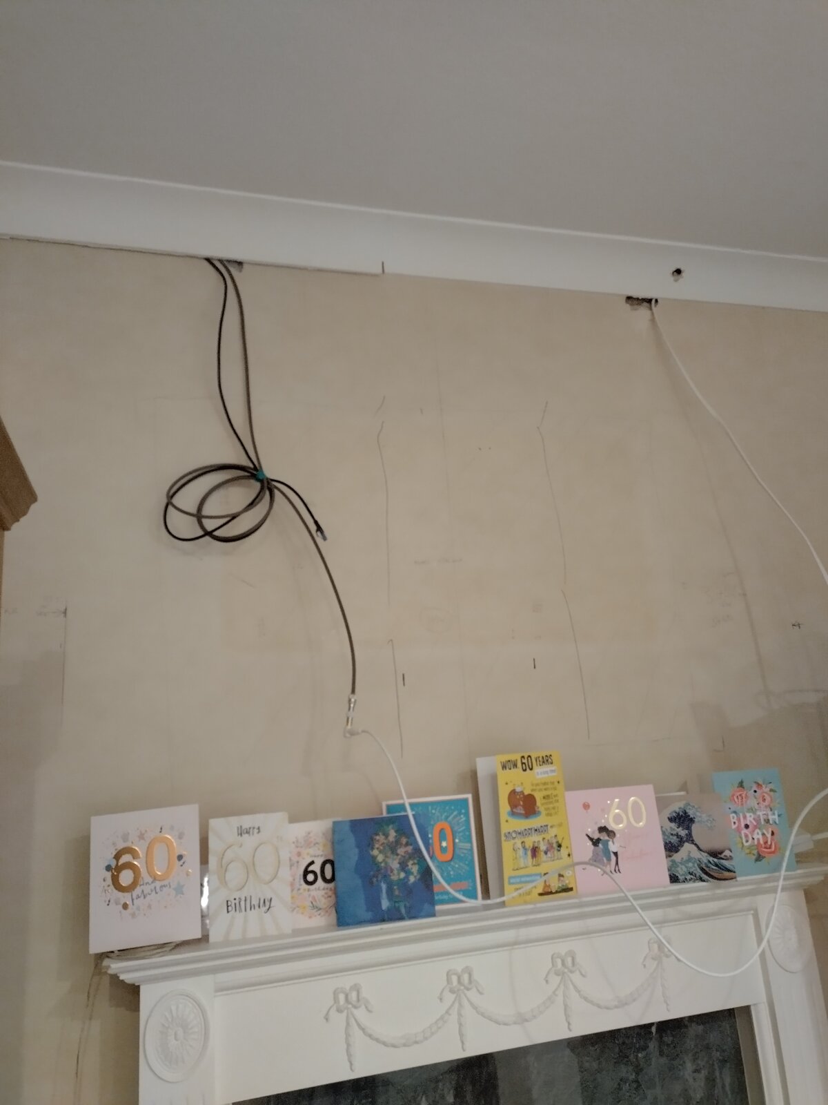

This is our new TV position in the process of being installed over the fireplace. I know some of you frown on it, but we are going to replace the surround with a lower one.
The 2.5 was brought up in the RH corner and across behind the coving.
The Cat 6 and aerial cables were brought up in the LH corner and across behind the coving.
Mrs S wants the soundbar above the TV, so a short HDMI lead will link that to the TV.
I don't want to go near the flue with the drill, so will get a piece of 25mm ply that will easily bridge the flue and will attach recessed bolts from the reverse side to mount the TV bracket to it with. Into the 25mm ply, I will cut a single and double box cutout, so I don't have to chop out the chimney breast. The single box on the left is for a brush outlet for the co-ax and Cat 6, and the double box on the right is for an MK socket with USB outlets. One USB outlet will feed a Roku stick. I know the TV has USB outlets, but I don't trust their output to be good enough to feed the Roku.
There were previously two aerial cables terminating behind the old TV position (in from the aerial and out to another TV via an amp), so I re-sited these outside in a weatherproof box, with a third new cable running to the breast. Here you can see it is temporarily attached to a flylead running to the old TV position.
