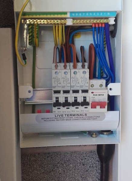

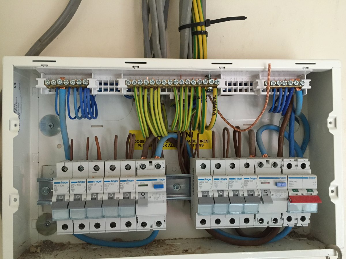

A question for all the electricians. Many on this forum seems to pride themselves in tidy work behind the scenes. Specifically how well managed the consumer unit is.
So, can a tidy behind the scenes work (something that the customer will rarely, if ever, see) be an indication as to diligence and the quality of the work they may do elsewhere? Or how conscientious in they are in heir work?
For example, two different electricians recently did work for family and friends. Out of curiosity I carefully had a peek inside the consumer unit.
Interested as you your thoughts on the work.
View media item 98663
View media item 98675

I don't think you need any help with looking at the CUs. It is quite clear, isn't it?
easy choice until I saw the exposed live conductor on the input to the top RCD. At least the messy one doesn't have anything finger touchable at 240v. Having said that it's maybe a factory installed joint, and it may not be as bad as it looks.

Might be my eyes but the lower example appears to have at least tried to use grommet strip on entry points and top man has used white tape

True, but you often hear about people removing kitchen cupboards or pulling up a floor board and finding horror stories behind them. I guess that consumer units are the most "behind the scenes part" so point taken. I can certainly see the second one is more messy. But, that is kind of part of the question, does the mess of wires matter or is it just an aesthetic thing. Or, would you consider an electrician who left a consumer unit that messy ...one to avoid.
For example on the first one. It has been attached to two wooden batons so there is a gap behind. It also had huge holes in the back surrounded by (as spotted above) white tape. If the latest consumer unit amendment is meant to make the consumer unit able to be more contained for fire purposes, are such large holes a standard thing?
That's ok. It removes the need to make top, bottom or side entry holes impenetrable.
Perhaps the holes could have been smaller and neater.
It actually isn't - the only requirement is that it shall be constructed of non-combustible material.

They both look pretty bad to be honest. Looks like cellotape in one. I hate seeing spare MCBs left. Cables entering both are pretty roughly done.
That irritated me looking at both photos, just grab a preloaded board, nail it to the wall and stick the wires in the holes that are needed, that is just so lazy. There has been a number of BG CU photos posted on various forums recently, all had random unused MCBs in them!
