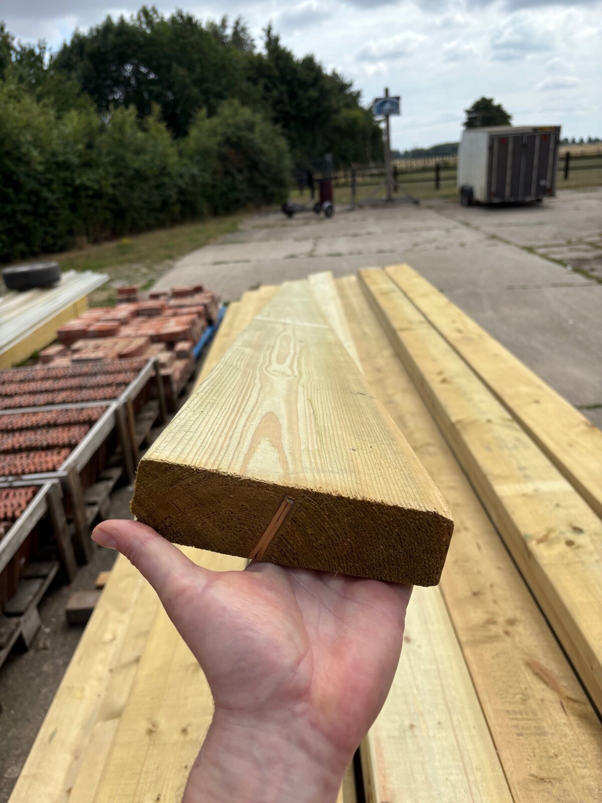

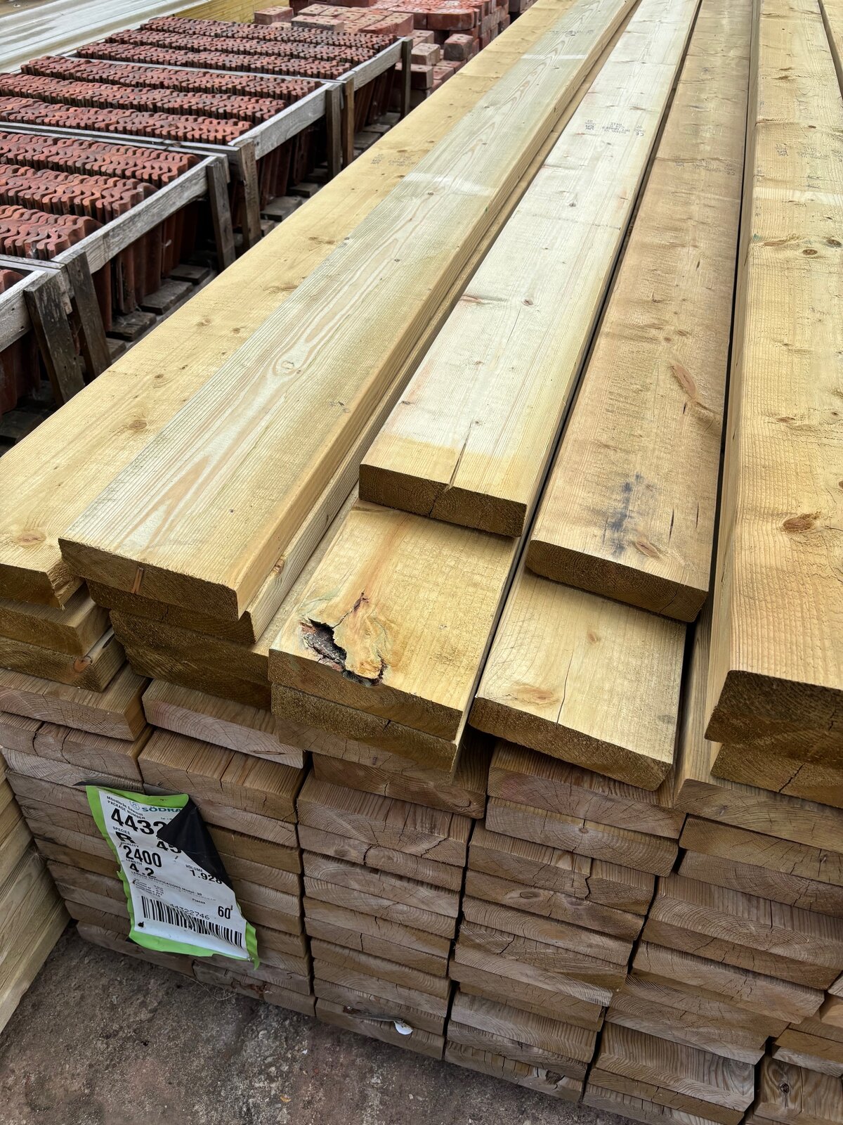

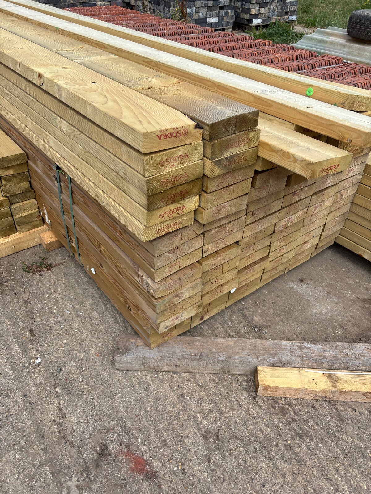

Bought a load of timber offline to build a roof on my workshop project. It was delivered by a local supplier. I’d like to know if what was delivered would be considered acceptable. It is all under size by Class 2 specs I found online. Some of it would appear to have been sat outside for some time and many of them are warped and have splits. Maybe this is ‘normal’! These days. Feel like they’ve used the opportunity to empty their yard of all the stuff their regular trade customers have picked over.
See pics below

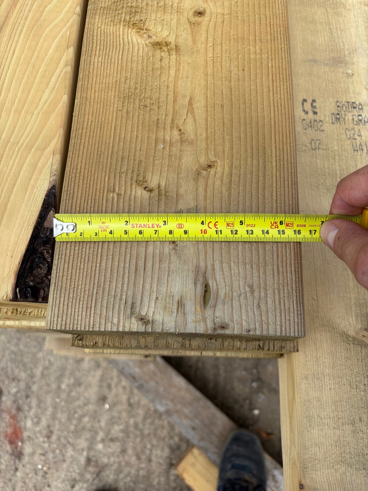

This is supposed to be 2x7 (47x175)

Also planed timber with a nominal size of 47x175mm typically has a finished, actual size of 45x170mm. This is because the planning process. Yours looks a little under. You need to ask what the actual size is

7x2 is the preworked stock size if its quoted in inches you need to reduce the size the machining will take off rough guide 1"= 21.5mm 2"=43mm 3"=69mm 4"=94mm 5" =119mm 6"=143mm 7"169mm
you should always ask "what is the actual size"
you should always measure the actual size a few inches from the ends as badly suported timber at the end off cut or plaining can drop a few mm as it drops off a roller or support
as an aside iff its quoted just in metric it will tend to be actual size
