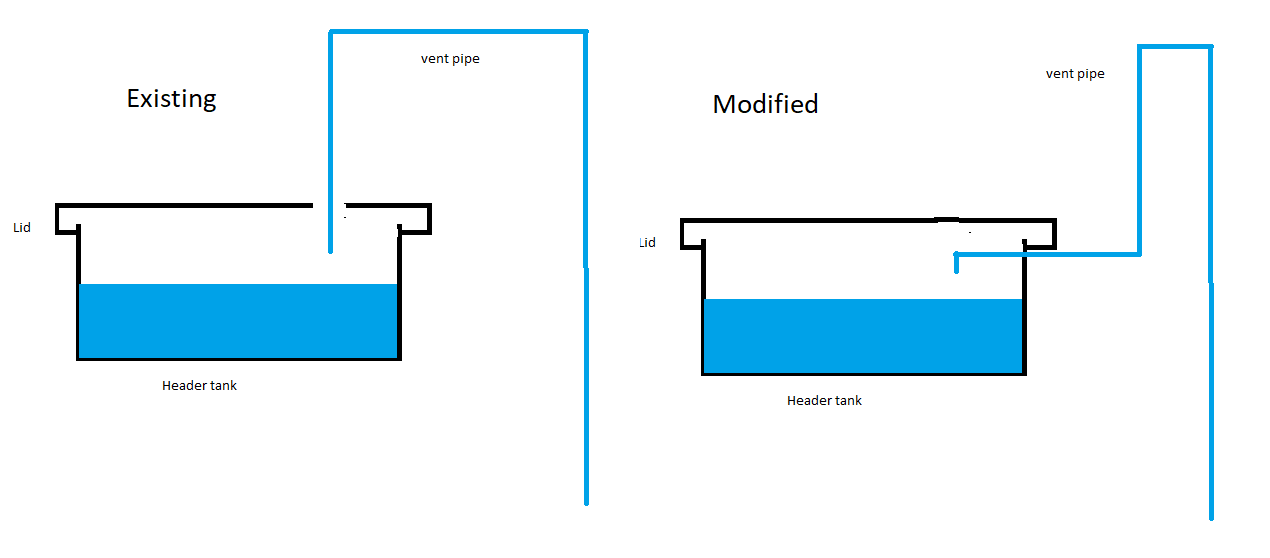

My central heating header tank did not have a lid (the builders missed it off for some reason). I've made a replacement lid from marine ply and covered with polythene. It fits snugly apart from the hole I've had to make in the top for the vent pipe to enter. I'd prefer to have this pipe enter from the side of the tank above the water level (so that there is no need for a hole in the lid). Is such an arrangement permitted by building regulations?

I understand that and my intention is that the vent pipe would enter the tank (horizontally) above the water level and remain above the water level. My question is whether this is permissible - or must the expansion pipe enter via the lid (vertically)?

No, it would not work adequately as a vent pipe. It needs to rise up, several inches above the tank, over, then down through the top cover, but end well above the water level.
Maybe a picture would explain it better....
1. Looks OK to me except that:
1.1 The vent inlet would need to be an appropriate distance below the overflow level.
1.2 You would need some way to let air into / out of the tank to cope with changing air pressure as the tank empties / fills.
Wouldn't the vent inlet be better above the overflow level?
The lid isn't hermetically sealed - so air ingress should be OK. Also air can enter via the overflow pipe.
I suspect the issue is no such much the hole as sealing the plywood top with its polythene covering.
Actually it is to avoid having to manhandle the vent pipe out of the way if I want to take the lid off.
