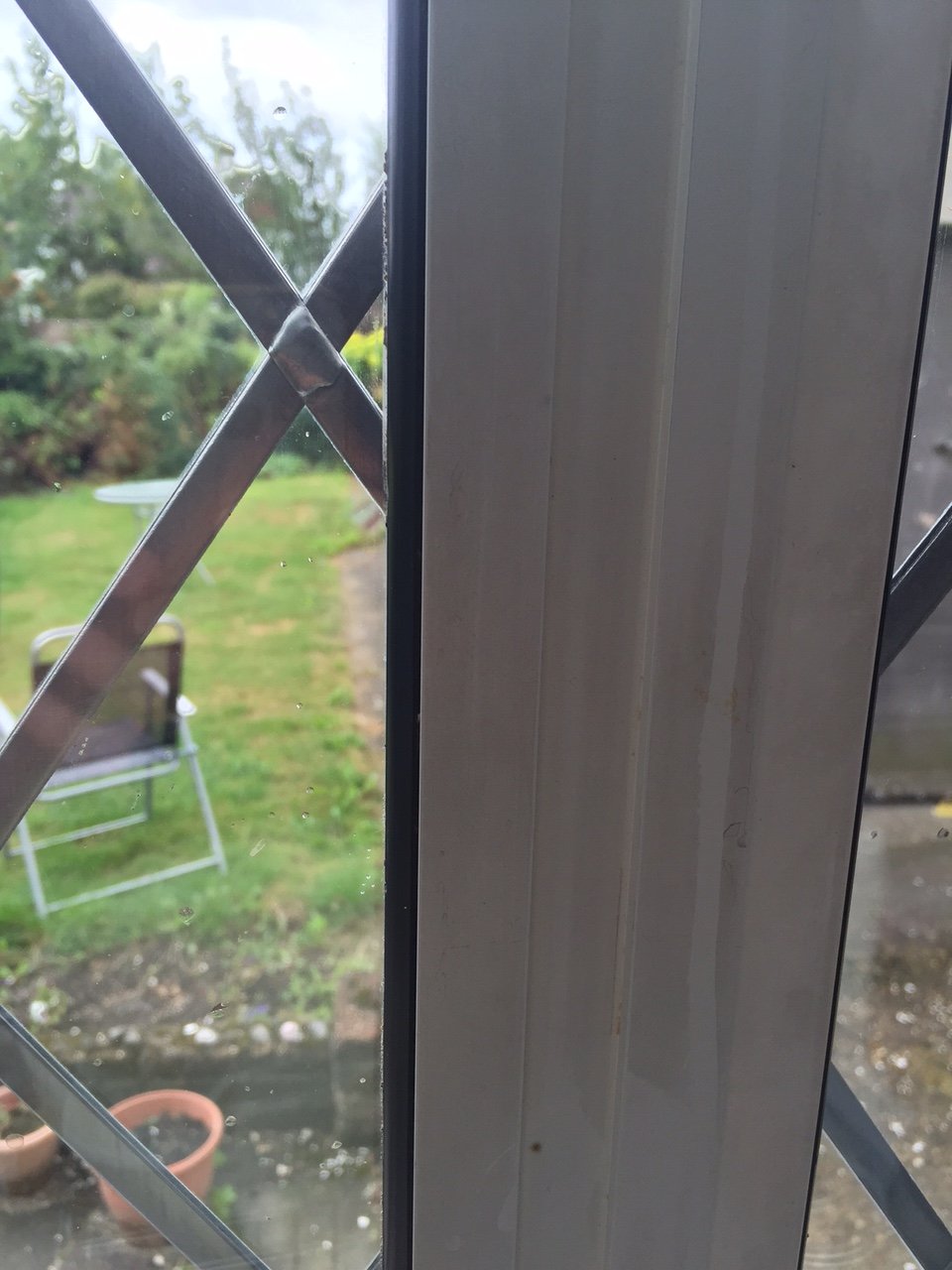

Which side the glass comes out? Do you mean your old windows? Pictures needed really but generally with ali you have a wedge gasket inside which pushes the glass outwards which in turn locks the glazing beads into position, pry out the internal gasket go out and press the glass inwards, you should now of loosened the beads enough to remove, there are other systems like Everest where each glass unit is set into a cassette which itself is set into the main frame, this has no beads but instead the frame is pushed/hammered onto to glass unit over a C shaped gasket called wrap around

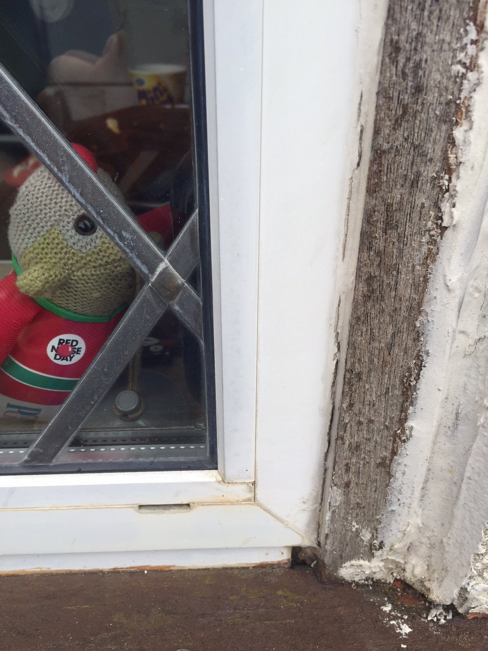

Just taken a couple of photos of the existing window. From looking at them it looks like the glass gets taken out from the outside.
That's it, flat scraper or putty knife inside to remove the gasket, if the gasket is in 4 separate bits then start in the corners, if it looks like 1 piece but folded at 90° then start in the middle other than that then as above
