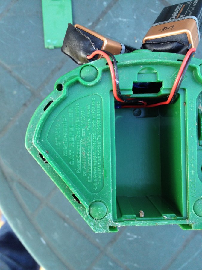

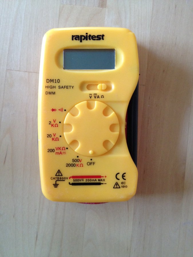

Draw: Not on specification, on box or website. Can anything be deduced from 2x 9v batteries? I do have a multimeter, but I have no idea how to use it. I can post a pic if you can suggest which settings to use!
We do need to have an idea of how much current they draw. Could you post pics of your multimeter and also one showing the batteries 'in situ# in one of the devices?

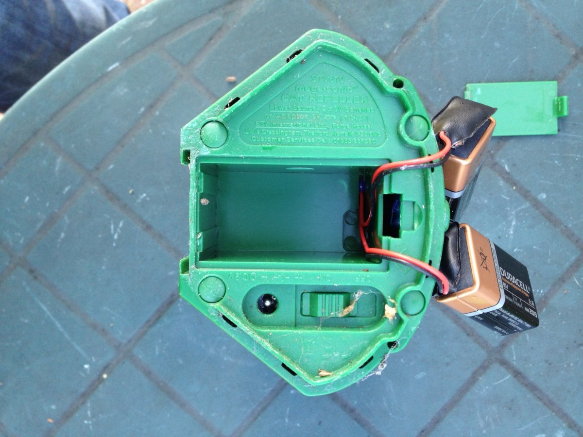

Multimeter and device images.
I did note the bottom of the device says 9V, 1.8VA... is this a clue?

Morning! ... Multimeter and device images. ... I did note the bottom of the device says 9V, 1.8VA... is this a clue?
OK, lets forget about the multimeter for a moment and assume that the 9V 1.8VA is correct - that equates to 200mA (0.2A) current draw per device (at 9V). Let's also forget about your 'ring' idea for a moment (although that would improve things). Assuming I've got my sums (done in haste!) right ....
