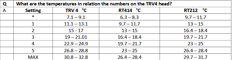

I came across this the other day.
Why one is able to set a TRV at 26.4ºC eludes me, or why they don't show degrees C direct, all my TRV heads are electronic and do show in degrees C.
I think the trouble with TRV's are that they really aren't an exact science. The analogue TRV's aren't really that accurate nor responsive, whilst digital E-TRV's are considered more accurate and responsive they are still ultimately, like all other TRV's, a slave to their immediate surroundings.
For true room to room control they should all really be controlled by accurate room stats that either talk to each TRV in that room or every TRV controlled via a central control. I know that adding in these extra controls would make the implementation more expensive but without that then again then can only sense what's around them and even with detailed hysteresis, it still isn't an exact model.
