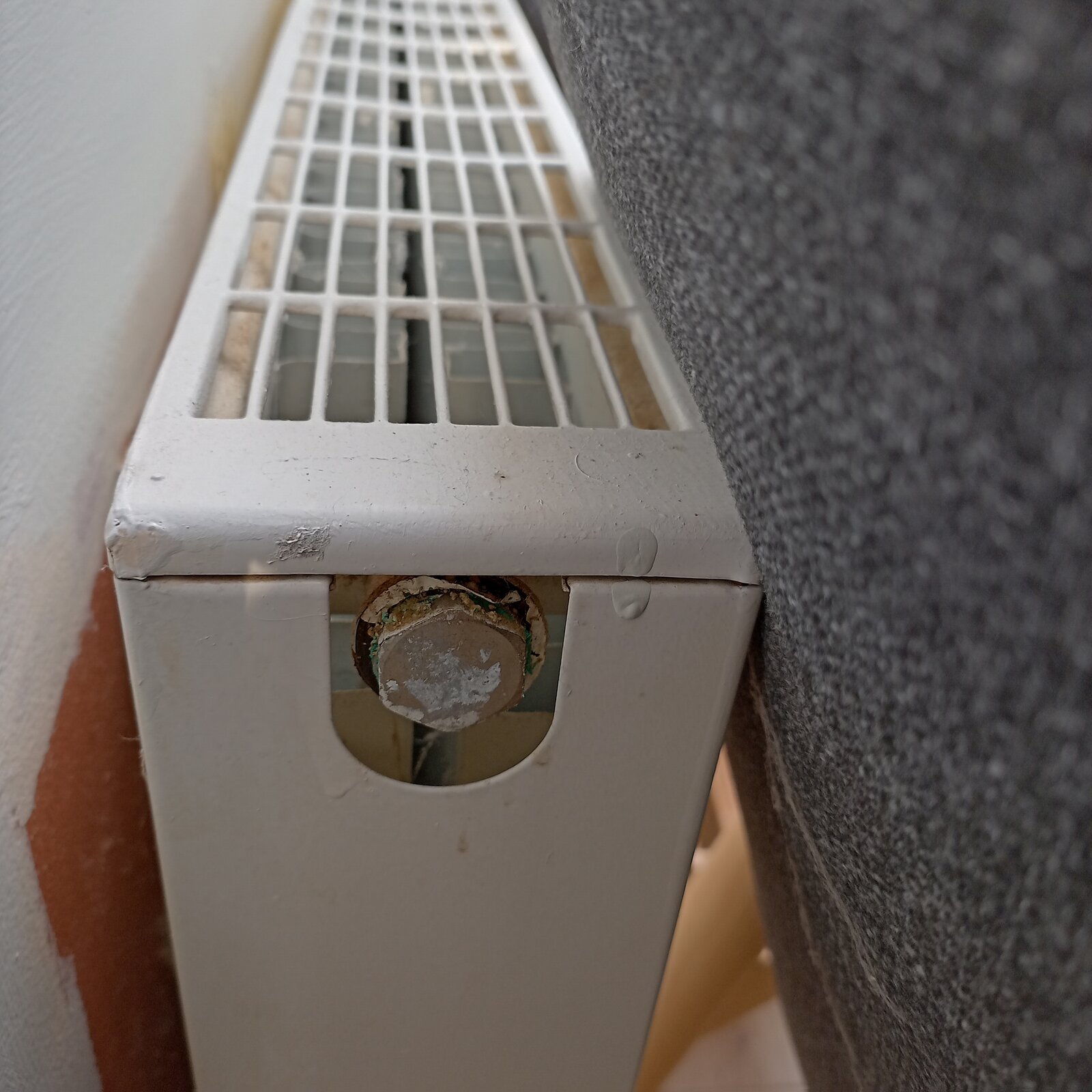

My radiator is a bit corroded around the blanking plug, see photo - flaking paint, green and white flakes. Do I need a new rad (soon? ) or is there a (temp) fix?
Lately there is some air in the system and I found this as the potential source.
Thanks, good to know I should not worry too much about the radiator's main body! (And you are right about the other end - last year I smeared some LX sealer around the outer ring but will now try to swap the bleeding valve too)
shut off both rad valves - count the lockshield turn so it can be put back the same. that way you just need to open the bleed valve and depressurise the rad, not the system, then take both ends off and re-seal.

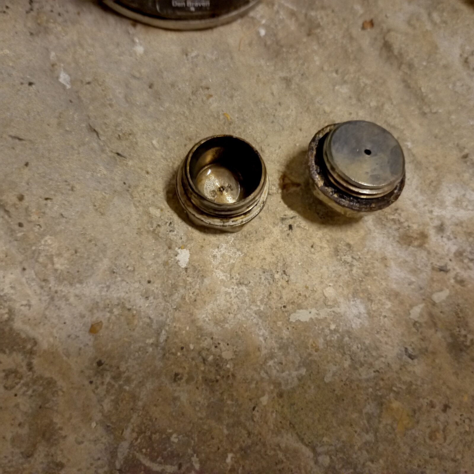

Thanks everyone! Last night I isolated the radiator (like Madrab said) and replaced the blanking plug and bleedvalve. It seems to have gone well!
But it turns out there was no O-ring on the plug (as ianmcd guessed), but some white paste (set hard), see photo. Is that still common to fail (and about a week after the inhibitor was topped up I heard air bubbles, though it might be a coincidence)?
