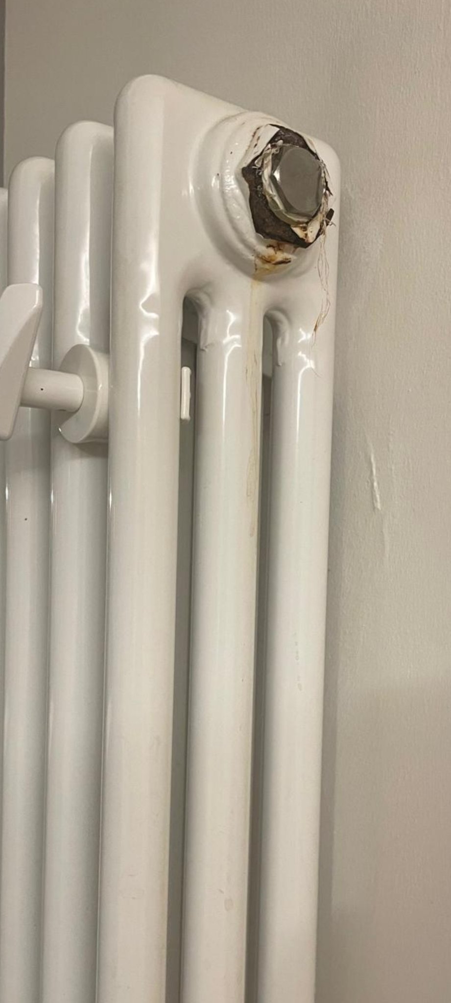

Radiator leaking air vent/rusted

Do you think this is best to swap the radiator or see if a new bleed vent key will fix. It looks pretty rusted

Need more information.
The older ones are part of the radiator.
Newer mostly are plugs that can become replaced like.
Edit
Looking at you picture. Replace radiator imo
Thanks yes I could put a new plug in but it looks like its rusted pretty badly all around it
Those columns are usually pretty heavy gauge steel so I'd see if it could be saved - Drain, then remove the blank and wire brush on a drill, clean it all up, remove all blistered paint and see what the tapping threads are like. If they're ok then grease the threads and then some rust converter, then a few coats of etch primer and then white enamel/hammerite.
May return after a few years though, depends on the prep.
If the budget's available then can always replace.
With the rust spreading around the vent boss like that, I'd lean toward replacement. A new bleed plug often won't seal once the threads are that corroded, and disturbing it can crack the weakened metal or snap the plug off.
Before deciding, do a quick integrity check: drain the rad down and gently probe the area around the bleed hole with a screwdriver. If the steel feels solid under the surface rust, a new plug plus thread sealant may buy you a few more years (as Madrab says, it depends on the prep and the corrosion may return). If the metal feels thin or crumbles, replace the rad.
If the metal around the vent boss still feels solid, a new bleed plug with a bit of PTFE on the threads can seal it up fine. Drain the rad down first, clean the rust off the threads with a wire brush, and wind the new plug in by hand so you don't crack anything. If the boss threads are crumbly or the metal flexes when you probe it, the radiator is done and replacing it is the only safe fix.
