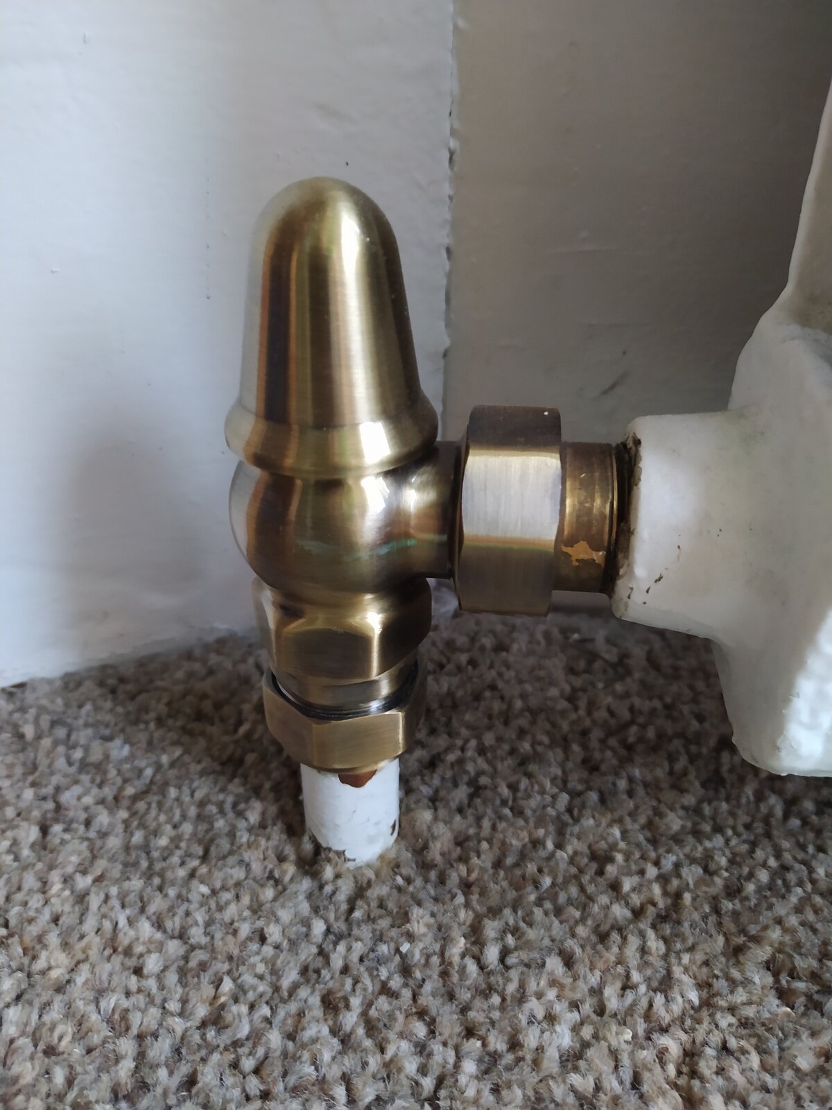

I have some 'traditional' style trv valves on my rads which I fitted last year. The rads had a 3/4 inch inlet, and it took me a long time to find valves that had a 3/4 inch fitting (there are 3 linked rads on a bay window, hence why they were 3/4). It's a union joint between the rad tail and the valve body.
I'm now changing the rads as part of a wider project to lower my boiler output, and as you'll know, the new rads have a 1/2 inch input.
So, and I think I know the answer to this, can you think of any way that I could use my current valves with the new rads?
Pic attached

1. Take the tails out of the old radiators and use them in the new ones.
2. Radiators are almost invariably tapped 1/2" BSP female, so the old ones should fit the new radiators.
3. If you are unlucky and the old tails are 3/4" BSP you will need to change the valves, unless you can find some 1/2" BSP union tails.

Thanks! I've had the tails out and they are indeed 3/4 inch - rare, but true.
I'm swapping older panel radiators with type 22s sized to allow me to run the boiler at 50 degrees, will help fight the cost of living crisis!
I'll have a look for 1/2 union tails, but fear they still wouldn't mate with the valves. I suppose I could always return them if they didn't!
They look similar to these, which appear to be 3/4” x 1/5” tails

If I understand you correctly, if the radiator tails, the male section that screws into the radiator tapping is 3/4" and not normal 1/2" and you want to keep the valves that you have. For them to fit a modern rad you will need reducing bushes, that will step down the 3/4" male end on the tail to 1/2" to fit the radiator tapping.
