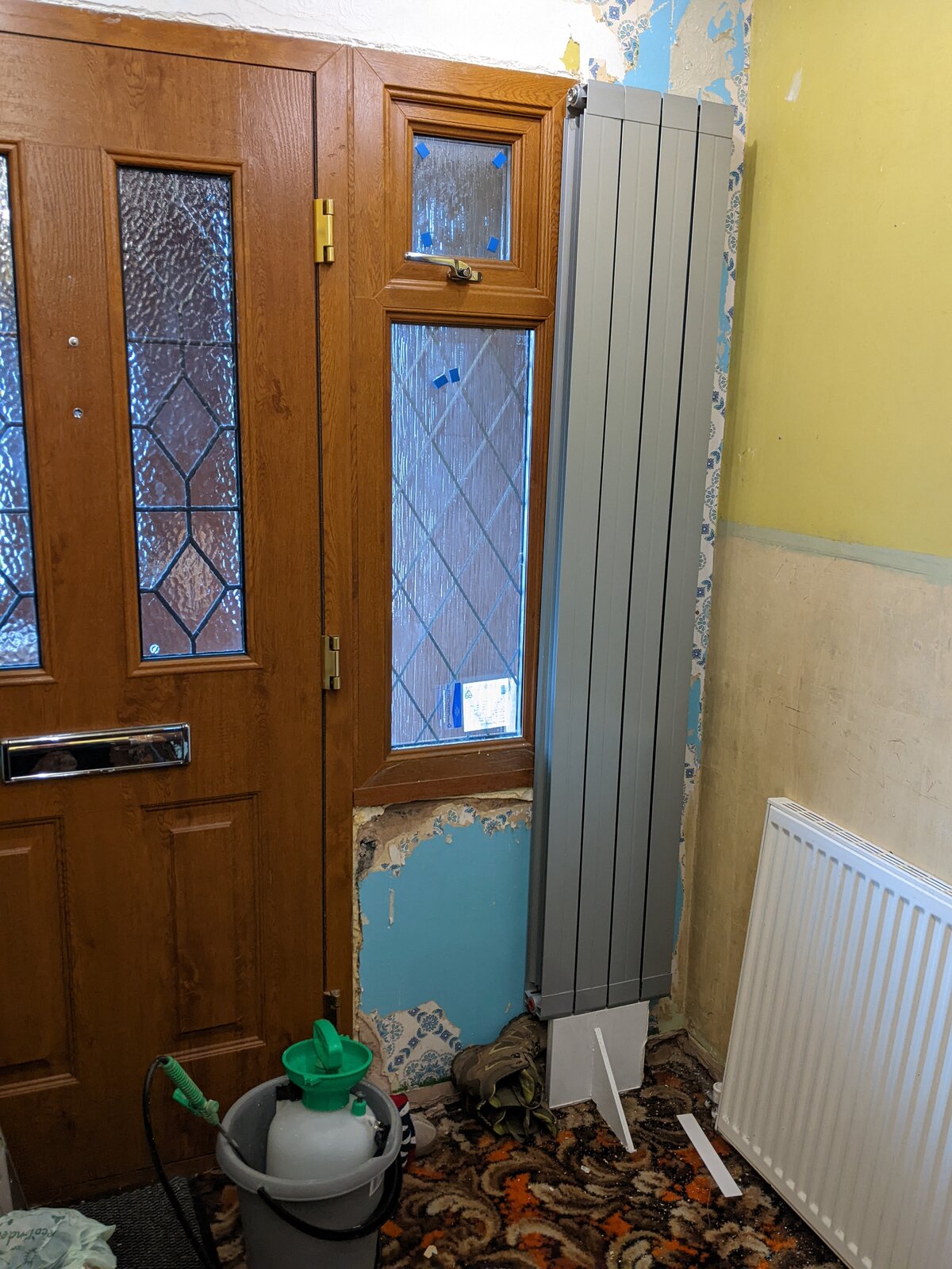

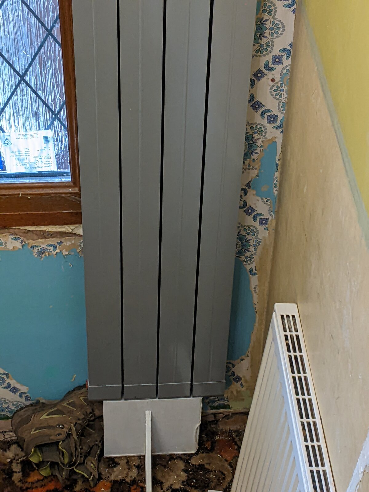

I'd like to fit this vertical radiator closer to the corner, but would need to leave a gap for the valve so there isn't really enough room.
Is there a compact double-elbow solution for mounting the radiator valves under the radiator, so I can move it closer to the corner? The 10mm Speedfit pipes will be coming down the wall behind it.
If not I'll have to put it nearer the bottom of the stairs, which I'd prefer to keep clear for future furniture removals etc.

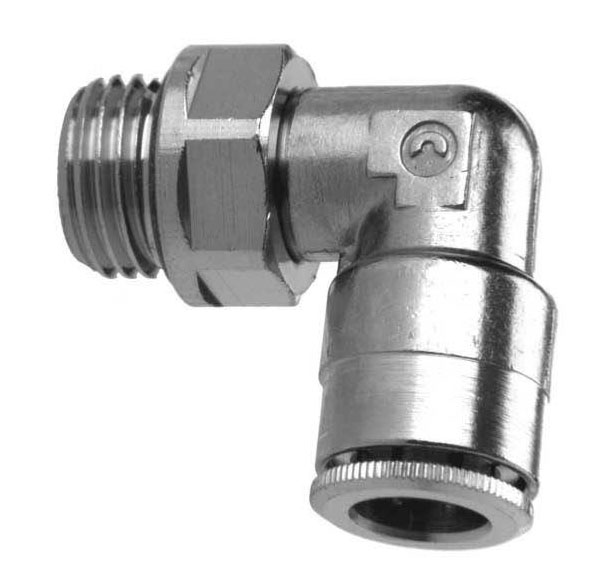

use one of these valves on wall side and have it more or less touching the wall should give you the room

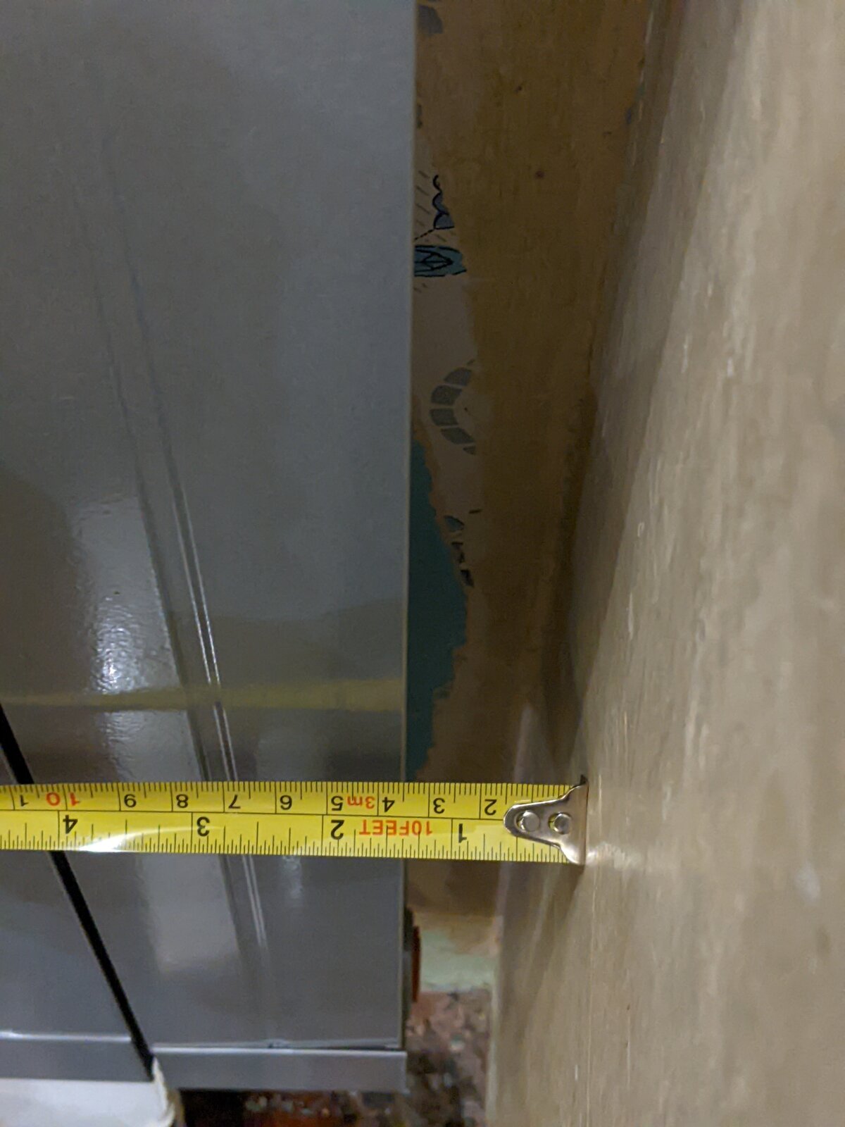

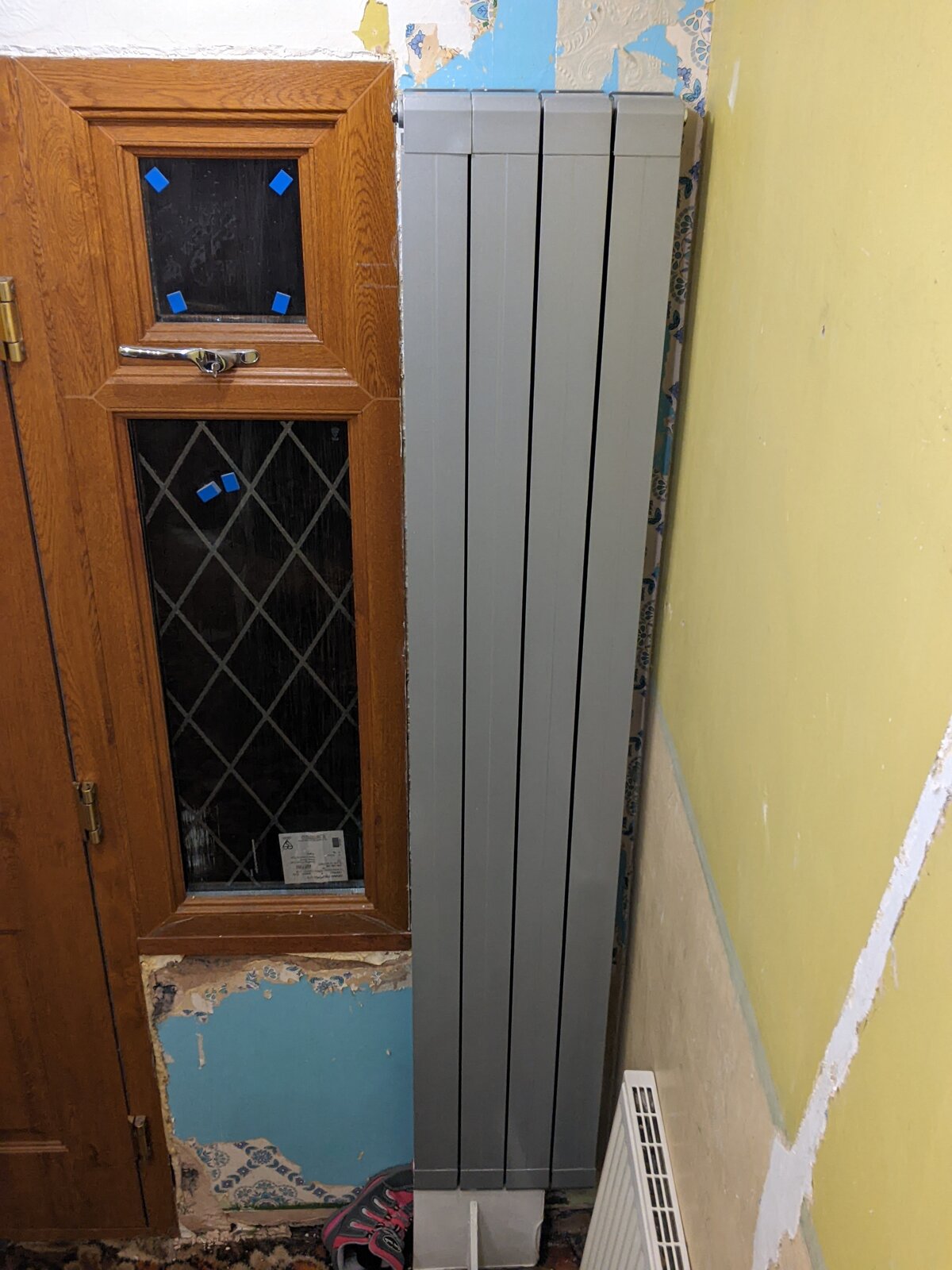

I think my previous photos were a bit misleading.
Here I've aligned the radiator with the edge of the window frame, there's only about 33mm between radiator and the wall:
Checking with another radiator, I'd need a gap of at least 65mm to allow fingers to rotate the isolating valve.

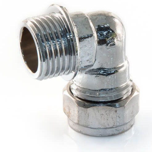

Is there something like this available to take it straight down, then underneath to the valve?
You could use:
1. A 1/2" x 15 mm chrome compression elbow such as BES 7625 PLUS
2. A short length of 15 mm chrome pipe.
3. A chrome 15 mm x 15 mm compression elbow. Screwfix 33526 might do, but I suspect its nickel plated not chrome. Toolstation do something similar - item 88121
If space allows you could use a 15 mm compression stem elbow instead of 2 and 3 above. The stem would have to be long enough to enter the compression end of item 1 above, and still allow the pipe to clear the underneath of the radiator.
