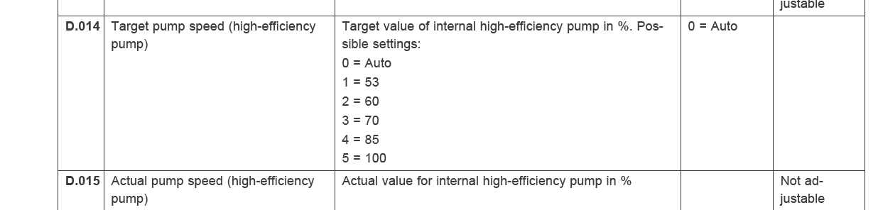

Anyhow check out your pump data. If its on Auto, then yes, one would expect it to be controlled by the boiler output so it will be interesting to see what D.015 reads, if, for eaxmple, it reads say 85% and assuming a 7M pump then that pump is effectively a, 7*0.85*0.85, 5.1M pump or a 4.4M pump if a 6M pump, if the speed is anything around 70% (3.4M) then wouldn't expect much noise but the internal bypass will still be open (partially) if set to its default of 2.5M.
If your boiler is......
637 (VU GB 376/5‑5 A) ecoTEC plus 0010018538 41-044-85, then you can check the target pump speed D.014 and the actual pump speed D.015
This boiler also has a adjustable bypass settable between 170mB and 350mB, default setting 250mB = 2.5M, even the max setting of 350mB, 3.5M always seemed quite low to me because this is before the boiler heat exchanger, some MIs also state that you don't require any ABV even with all TRVd rads, so I would set this to say index 4 for now, piping should be cold downstream of it (ABV).
