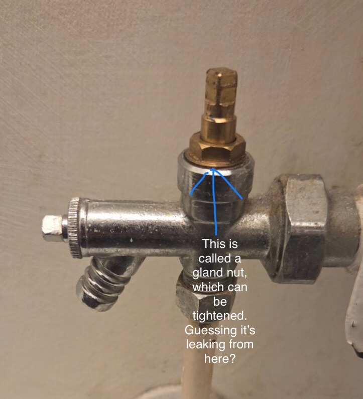

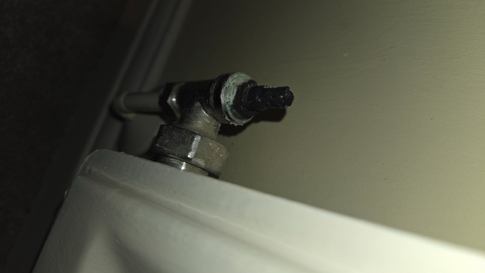

I can't balance them because when im closing the lock shield valves on most of them they start leaking.

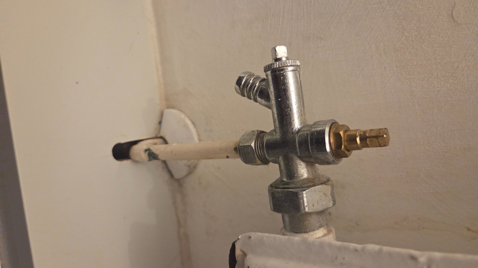

Here you go not sure i see any nut or is that the brass section at the bottom.

How many rads don't heat up currently ?
Close the TRV ( or wheel head if no TRV) on all rads that currently heat up.
See if any cold rads now heat up. Report back.
Ok so those being tightened has sorted that bit.

In the morning i will shut all possible off to work out if its balancing another issue going around is some of these wheel head valves are stuck as well.
