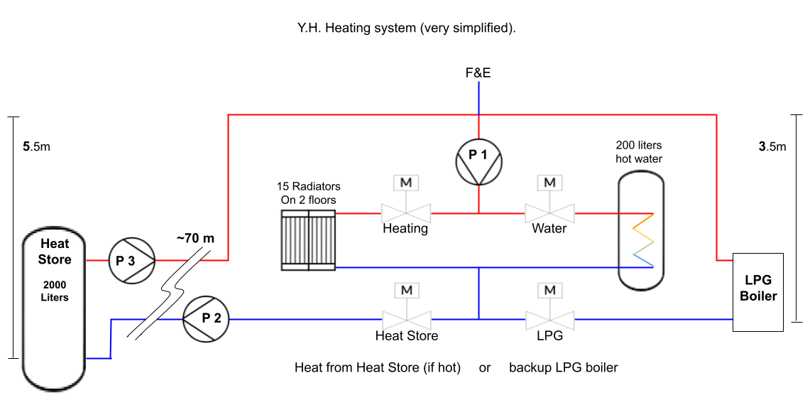

Basic layout below.
Either the LPG boiler and Pump 1 are running (everything works)
or Pump 1, 2 and 3 are running.
Motorized valves shut the other heat source.
How can I identify the fault?

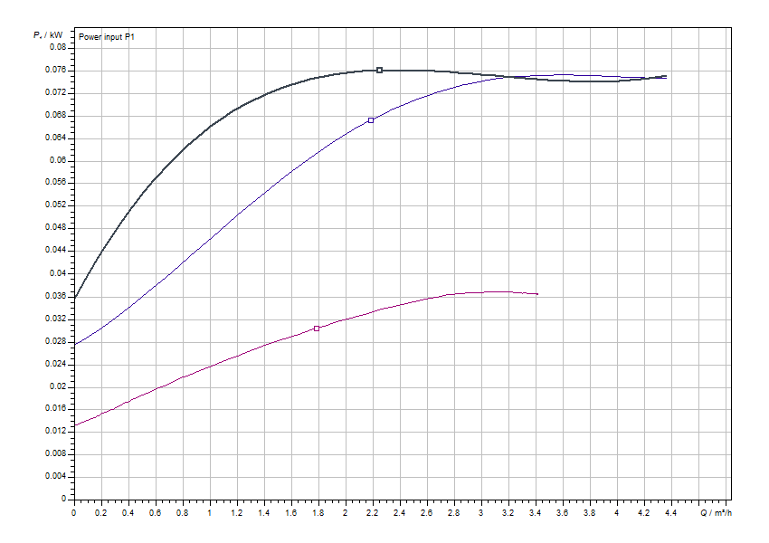

I don't know if the flow rate is appropriate. The pump curves for P1 suggest it's operating around 2m³/h so possibly the flow rate from the heat store is bringing warm water to P1, but not fast enough to keep up with the circulation around the house?

yh-heating-exisiting-design-png.332856

P1 = CC 2 or 3
cc1 makes the boiler overheat.
I've tried different modes, but makes no obvious improvement.
P2 & P3 on setting 3. Again, changing them doesn't make anything better.

A rads dT of 15C requires a flowrate of 28.7LM, 1.72M2/hr, 154M of 28mm piping has a dP of ~ 6.9M, add say 1M for dP across the rads = total pumping head of 7.9M.

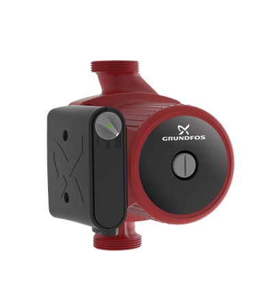

A rads dT of 20C requires a flowrate of 21.5LM, 1.29M2/hr, 154M of 28mm piping has a dP of ~ 4.1M, add say 1M for dP across the rads = total pumping head of 5.1M. The UPS3 pump below is a very powerful pump and even on its own should have no problem in circulating 1.29m3/hr (rads dT 20C) as it will supply this flowrate at 6M on CC3.
Can you find the pump curves for the other two pumps and post them.
I would suggest shutting the inlet/outlet isol valves on each pump and remove its head, give the pump ports a quick backflow from each side to prove the pump ports clear and push a tiewrap through the impeller vanes to prove clear.
Also that UPS3 has a very disproportionate failure rate and unfortunately does not display the power in watts, a very useful aid on any A rated pump, most makes now do and also didplay the flowrate.
On setting 1 (in any mode), the boiler overheats and shuts down.

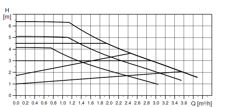

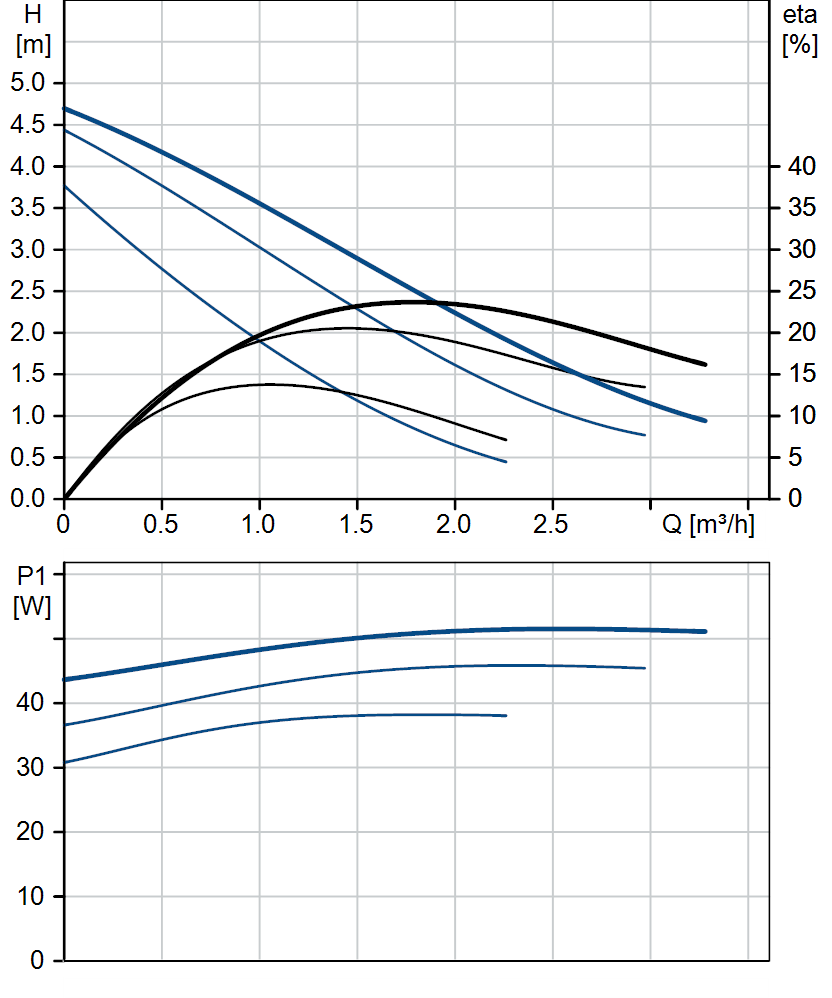

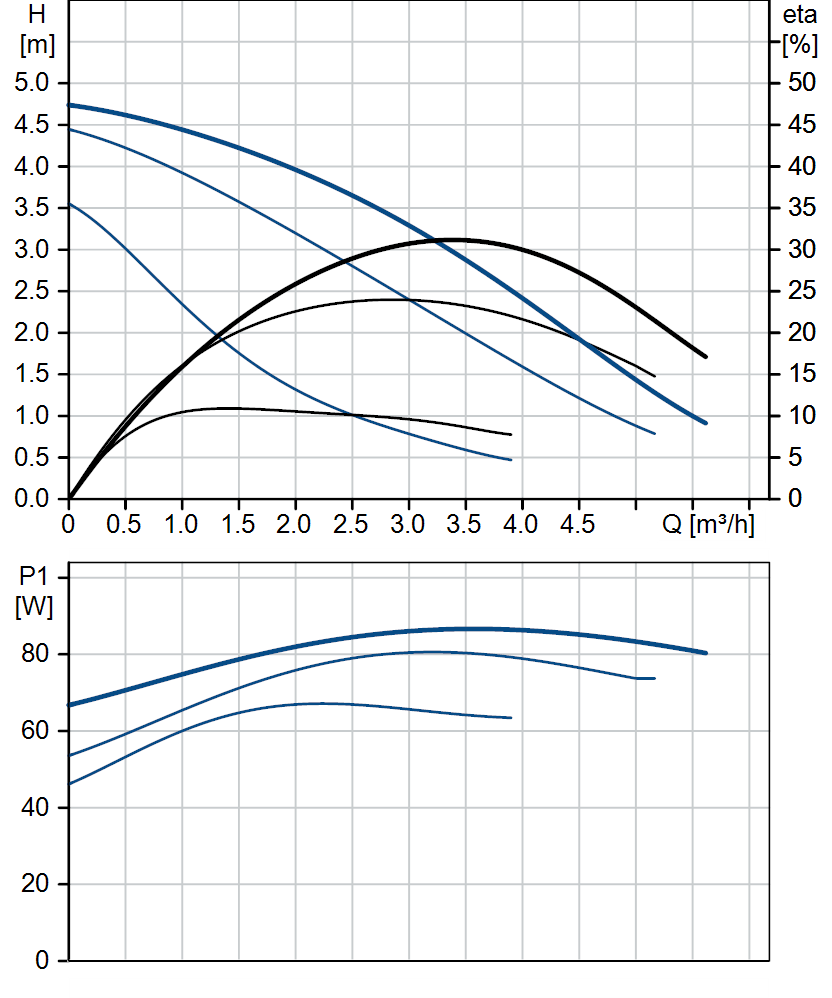

P3:
P2:

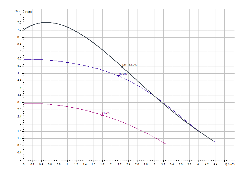

In desperation (the system failed before Christmas) I bought:
A Wilo Yonos Pico 25/1-8
I tried this in place of P3. It didn't make any functional difference.
I've tried it in place of P2. That hasn't helped either. It's currently still in place of P2.
