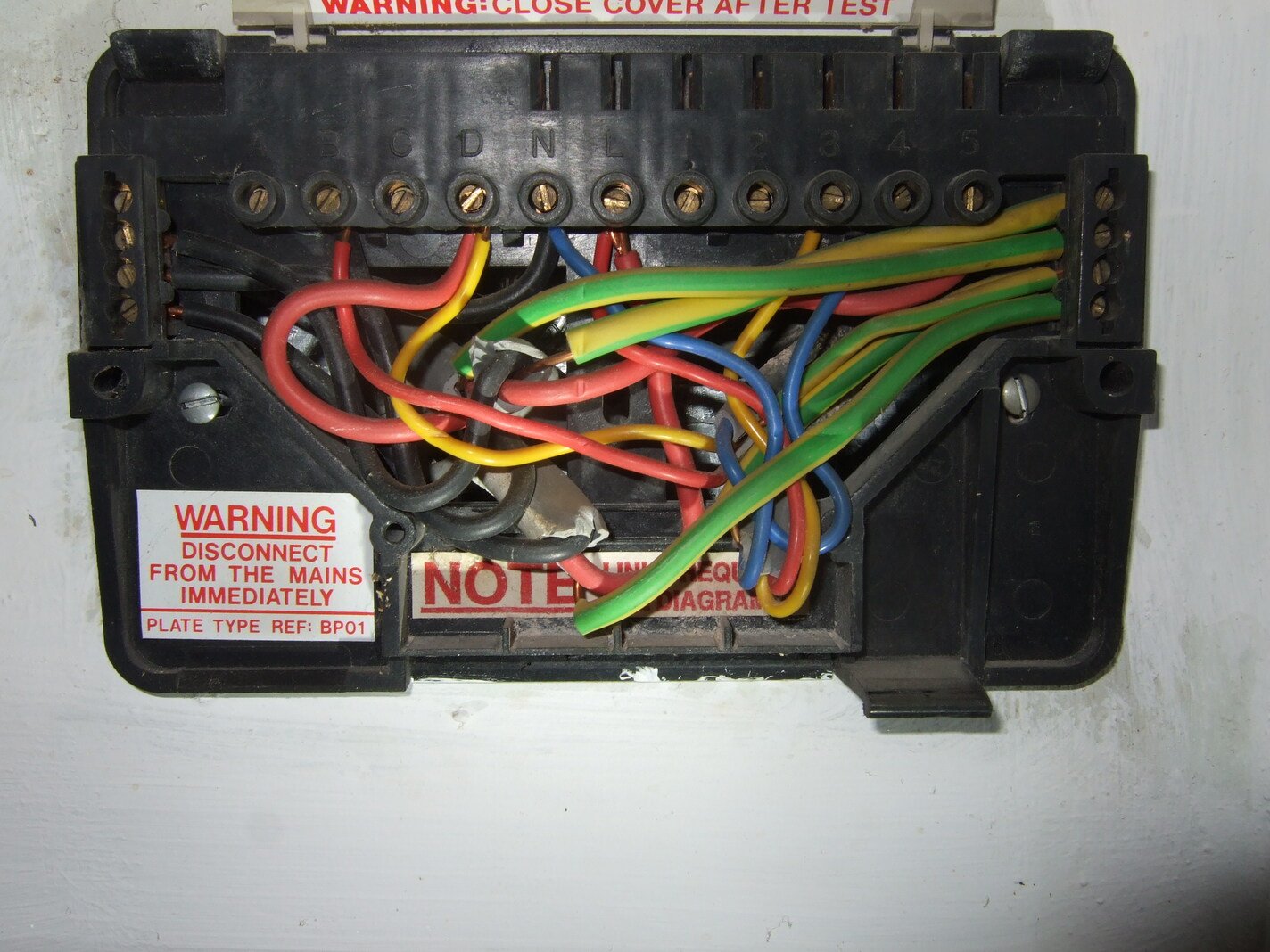

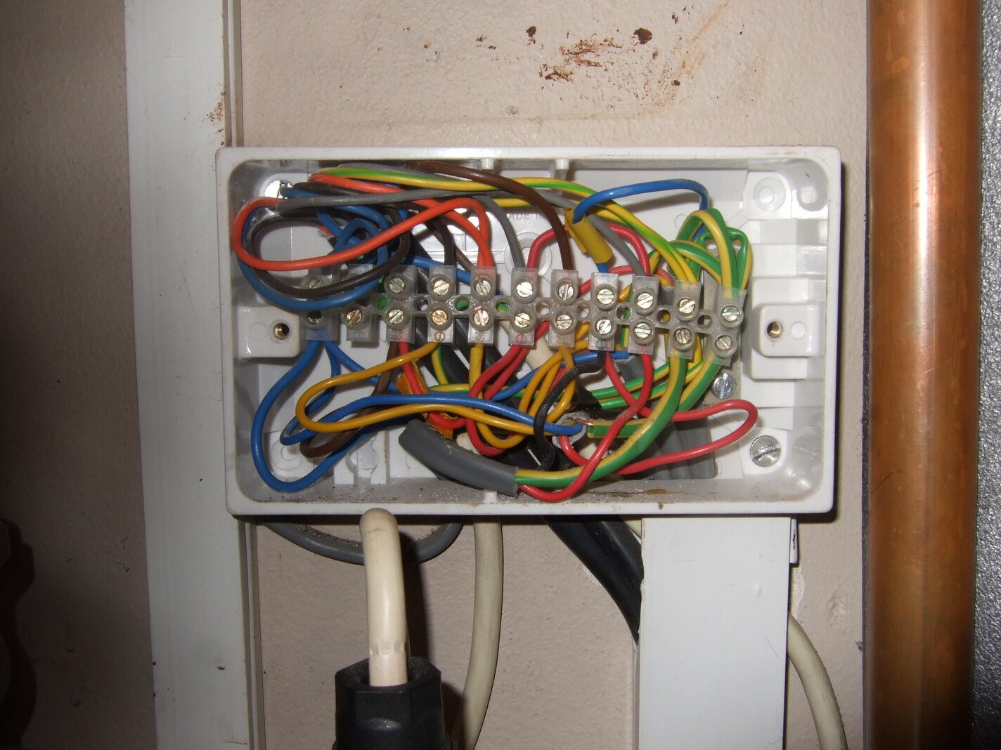

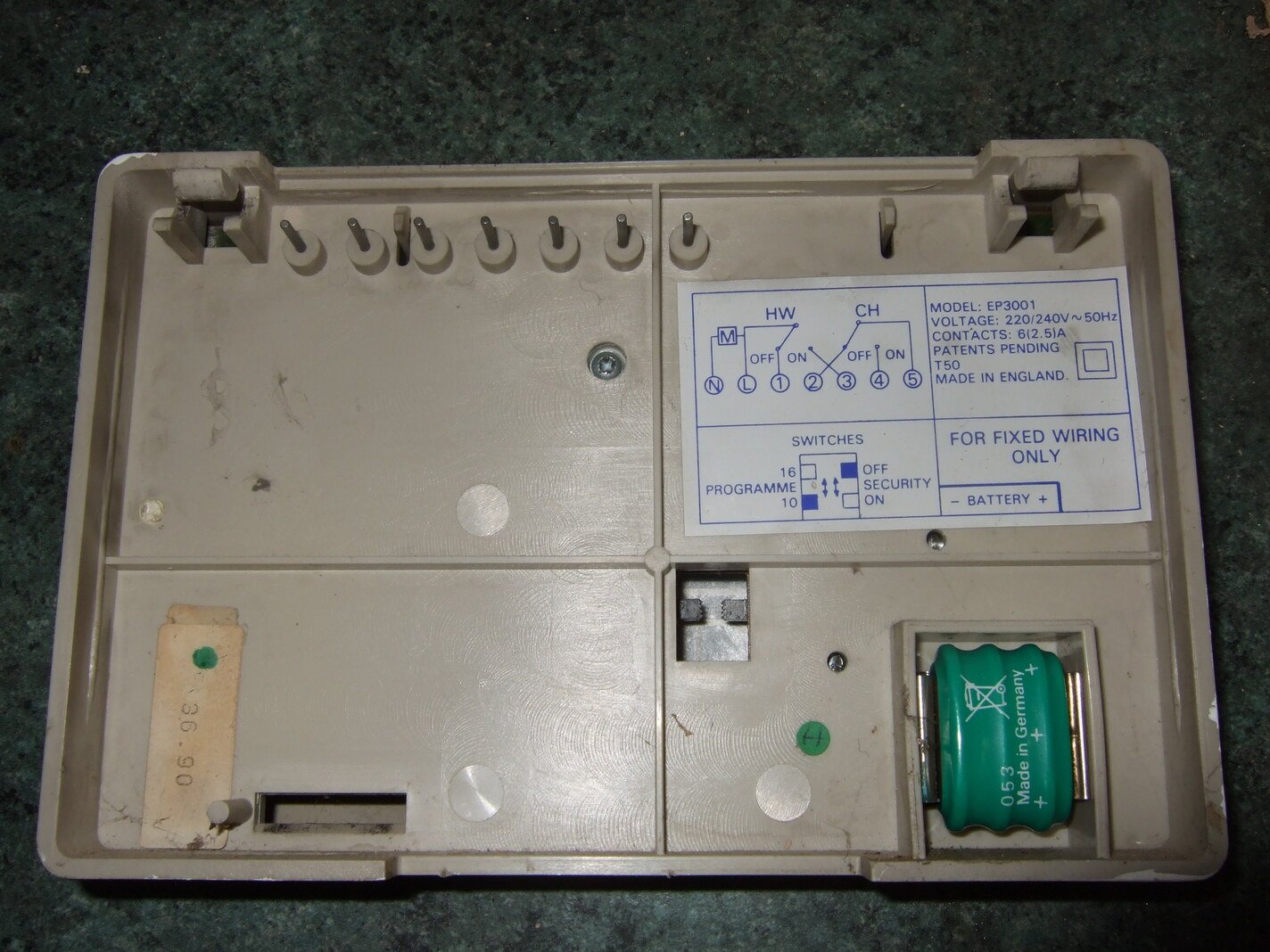

Photos showing wiring, there are plenty of wires but not quite a billion. There is a hand written note labeling the connections in the Airing Cupboard, looks like it matches the letters and numbers in the controller wiring

Motor in motorised valve is breaking down . change just the synchron motor
Do I understand this correctly: In normal running the motor is under power holding the valve open against a spring and the other two (auxiliary) wires tell the controller the state of the valve. After a couple of minutes the motor gives up and lets the valve shut and the auxiliary tells the controller which stops the pump and boiler ?
yep basically that the motor is breaking down when in use
You can check it
with clock demanding HW you will get 240v on the brown wire to valve which opens it
when the valve closes and boiler and pump go off check if you still have 240v on brown if so then its the motor
If your not getting 240v then you follow it back to cylinder stat then clock to see were your losing the 240v
