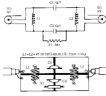

I went to a lecture on this, it is of interest to every radio ham. A lighting strike is going to take out equipment, there is no way to protect, so step one is to reduce the likely hood of a lighting strike, so do not mount on sharp corners like gable ends, or on soot lined chimneys, which is where most aerials are mounted. And do not earth.
The DTi did a book "How to improve Television and Radio reception" now out of print, but they did publish the plans for a braid breaker that would allow TV signals to pass but not DC so you will not get a belt from aerial but neither is it held at ground polarity so does not attract lighting.
Most radio rallies would have the kits of parts for sale, but this was a long time ago.
However TV plates do come in two types, internal which allows DC to pass to power digi eyes or mast head amplifiers, and those with capacitors in for use to aerials that have capacitors in.

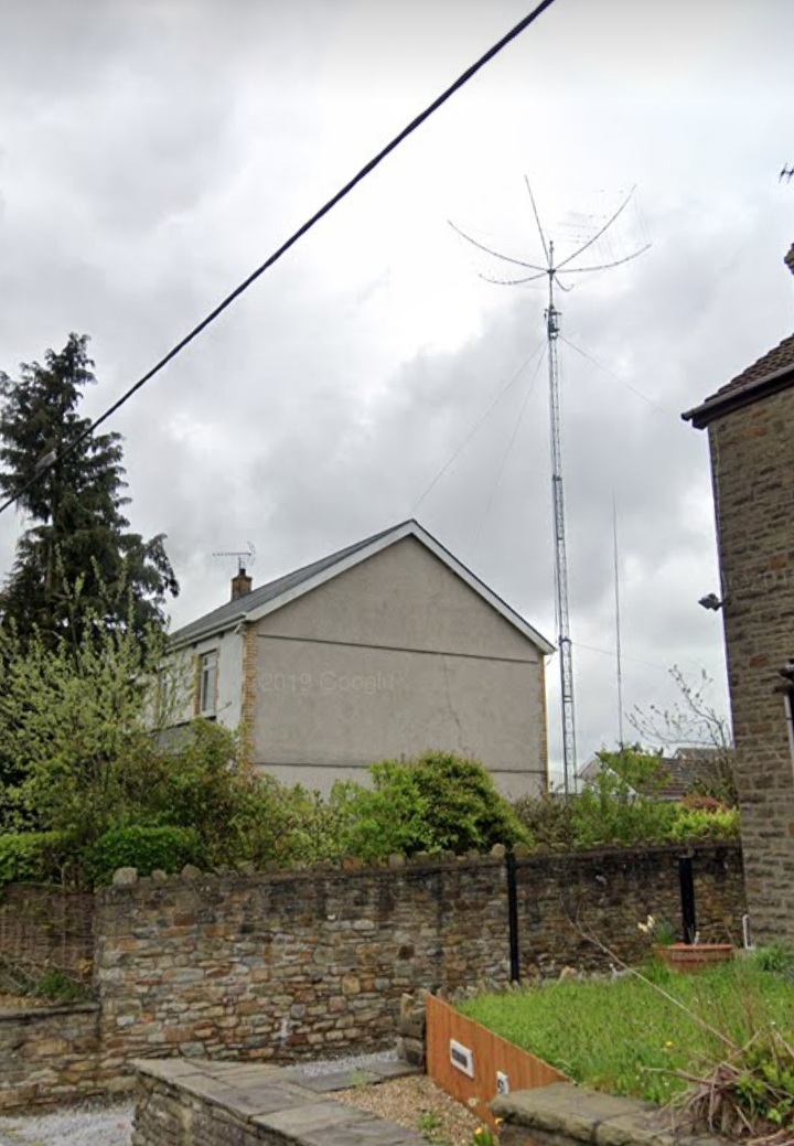

And a friend of mine has this small antenna in their back garden!
I've been meaning to have a chat about it..
