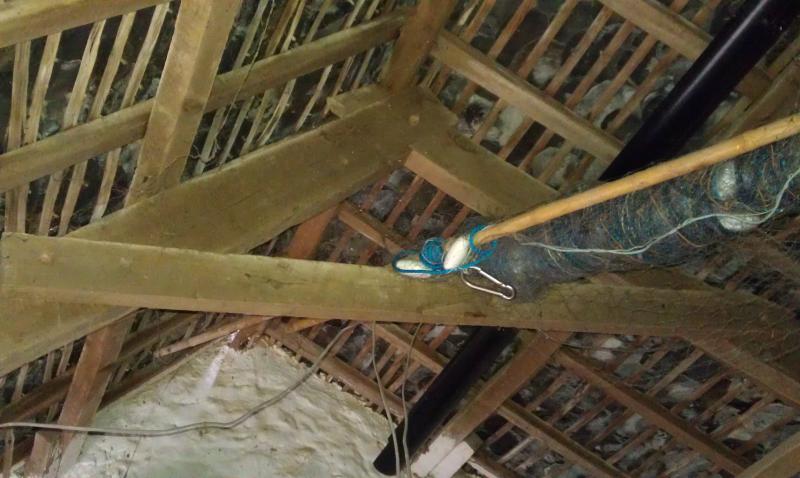

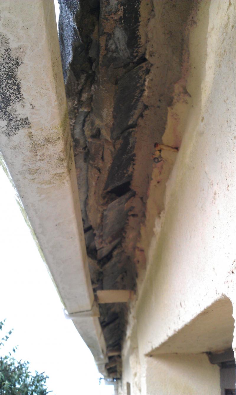

I am a little stuck at this point, here are some photos
1st one shows eaves detail (or lack of it) i.e slate just protrudes, no rafters showing etc
2nd the roof weighs alot :eek:
3rd and 4th shows existing timbers.
You will see no sign of wall plates, rafters just go into wall, however in another part of the building; were I hacked off, you can see wall plate with birdsmouthed rafters sitting square on inside face,,,another words they dont project to outside of the 700mm thick walls. So I assume the slates are just mortar bedded the rest of the way.

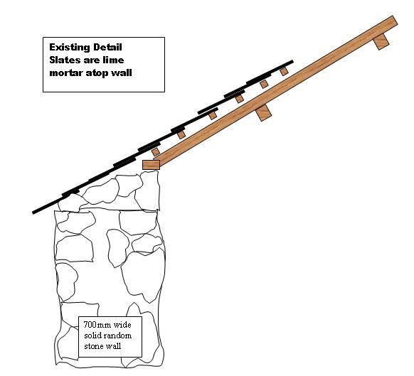

Hi
I thought I would sketch out exisiting and options to make clearer what I have and propose.
Existing:
Some Options:
[/img]
All have concrete ring beam, restraint straps, and truss clips on 1 & 2 but birdmouthed on 3 with a kickout timber nailed alongside to carry slates on?
Any suggestions?
Wow - interesting old roof, these 'ribbed' roofs are pretty rare now and you may have the conservationists all over this one! This system of vertical ribbing with metal wire and grouting is known as 'Sir Fonio' in North Wales (or 'Anglesey-ing' in English) as it was such a common fix on Anglesey coastal cottages that were originally roofed with low grade slate. Many can be seen on he coasts of Pembrokeshire too and the authorities there will not allow you to touch it without photographing & recording at every stage, and if replacement is deemed necessary then it has to be put back the same (or at least look the same) do you have the same situation where you are? would be interested to know how your going to re-slate it.
As far as you question is concerned I'd go for option 2! , but could you not just use a nice timber rather than the 100mm concrete block?

Re: Options, yes, Option 2 looks most likely.

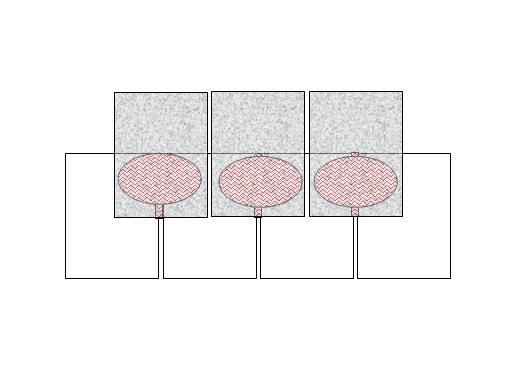

re:bedding in and not blocking perps here is a sketch with perps filled between two slates at heads and under the top slate, is this what you mean? i.e perps are clear on the exposed parts of slates but filled by bedding in on the hidden part of perps, yes?
[/img]
Also is it possible to do this method on a warm room with insulation over rafters?
Many thanks again
Yes, something like that, although the tails of the second course will be much lower down in reality as they will be double (possibly even triple) lapped.
And yes, this method is fine whatever is going on underneath. But it seems extremely labour intensive for something that can never be identified as being done (as you're boarding the underside) - it would be a lot less hassle nailing and would look the same.
