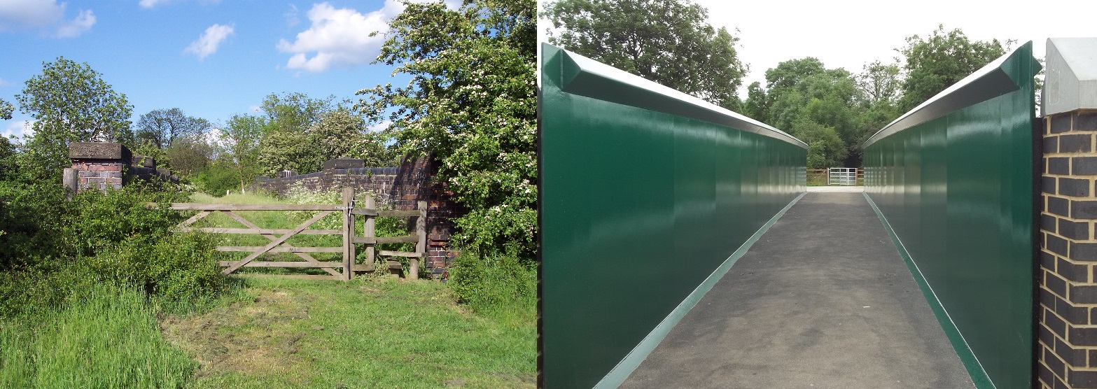

There are two bridges, quite old, one stone with a preservation order on it. I assume the track to underside of bridge clearance will not be adeqaute for the electrification, what is the usual solution they use - jack up the bridge, or lower the track bed?
Around our way, most of the bridges have been demolished and lifted.
I believe in Bath, there has been work to lower the track through tunnels.
But this is a new one on me - "Electric resistant paint"! :)
There is also a problem with old bridges - the parapets often have to be lifted, so people can't jump, or throw items onto the wires, that's why demolition is often preferred.
The railway line was electrified. Many Victorian bridges over the tracks were modified to provide clearance for the over head wires.
This was one of them before and after.
Interesting - My best guess is that it must be a super insulating paint, better insulation than the surrounding air.
