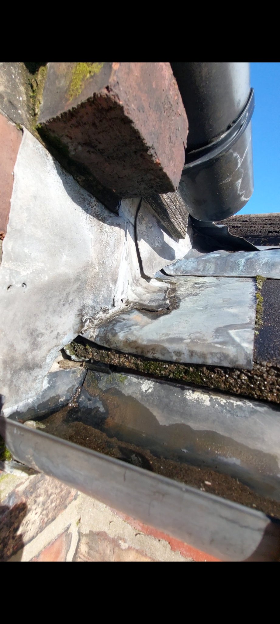

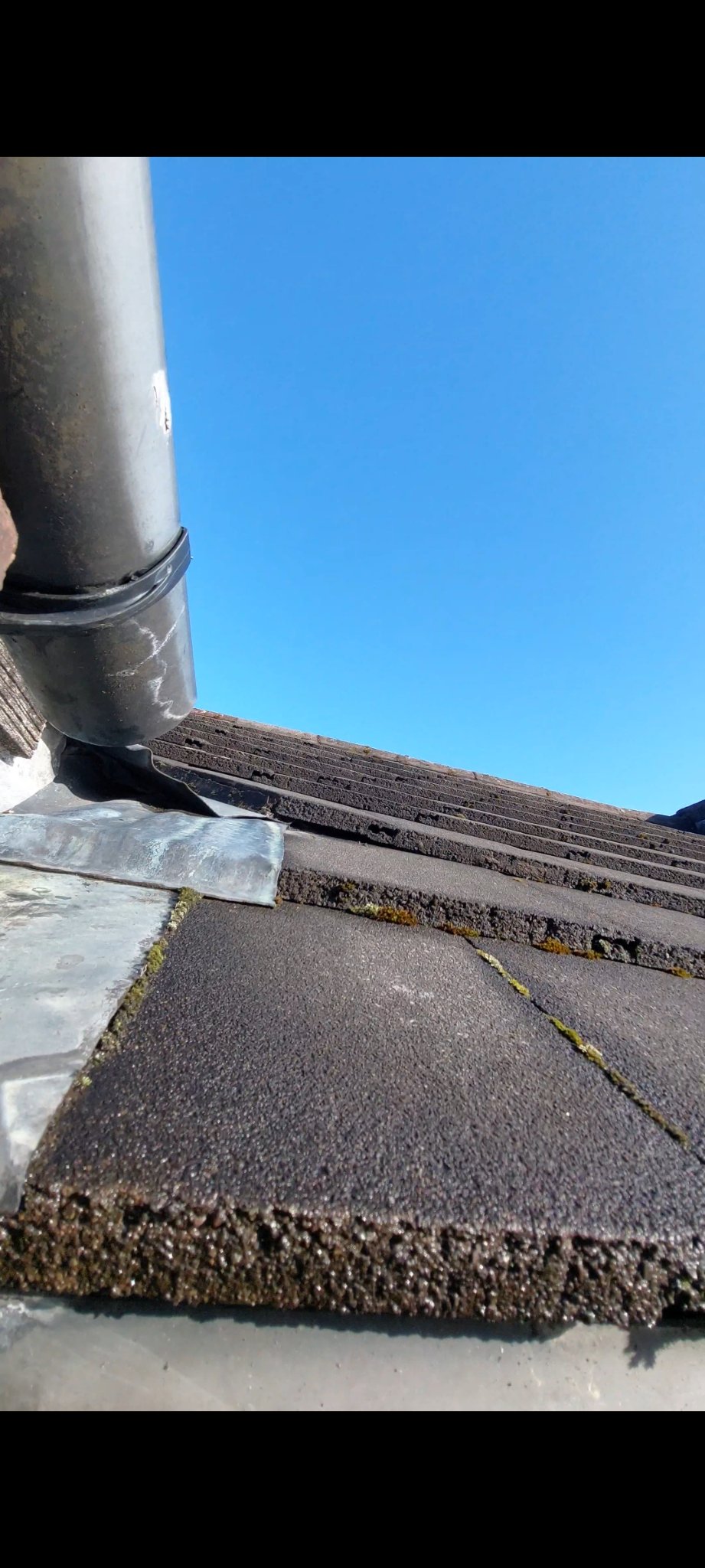

Hi , Can anybody see any problems here with roof. Small amount of rain through bathroom ceiling.
Post a pic from further out and indicate where the rain appears to be getting through into the bathroom.
So bathroom drips equivalent to the bottom left around the middle of the left of the tile. Thanks for replying

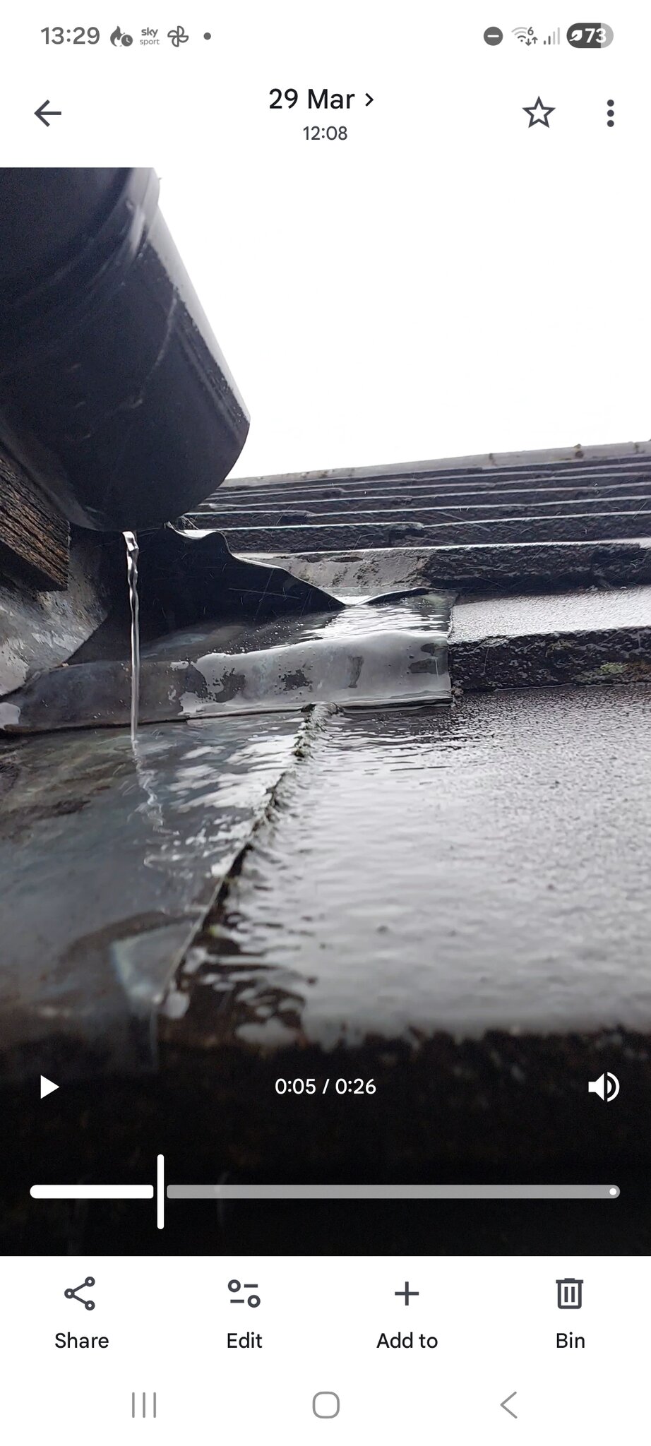

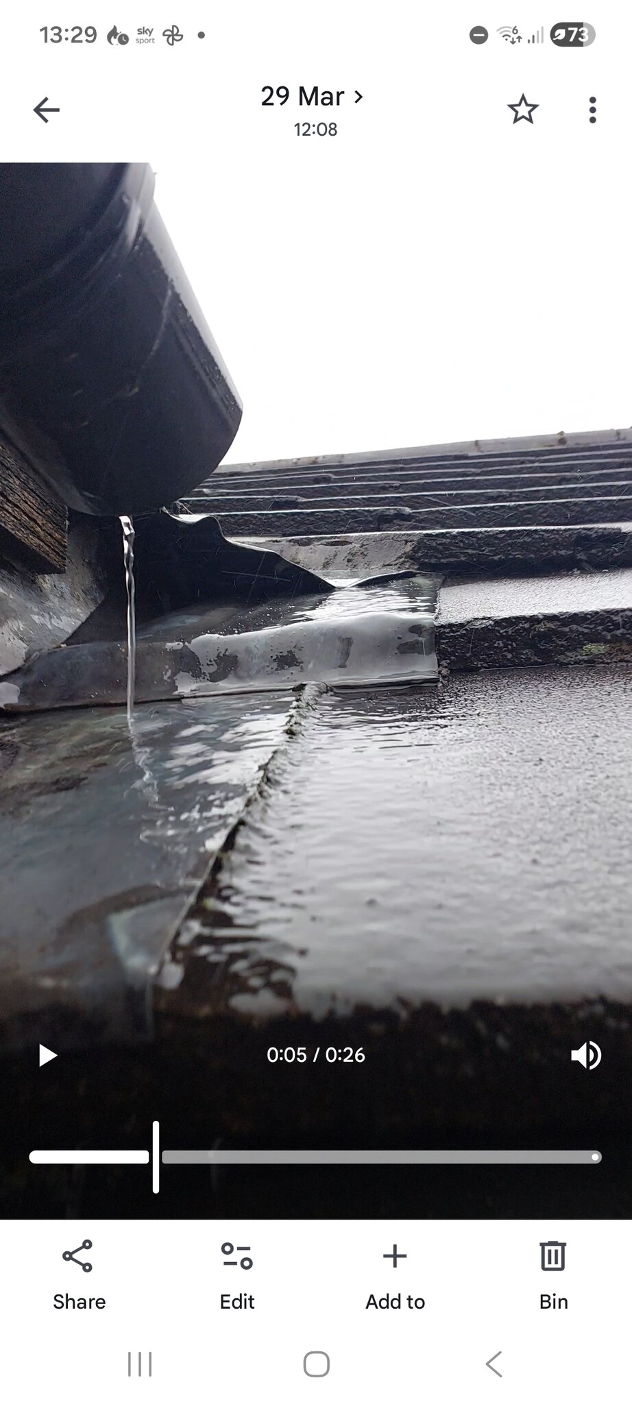

You still need to post a picture from further back, so we can appreciate the overall layout, but...
That slow stream of water, in heavy rain conditions, looks as if it might flow straight under that lead work.

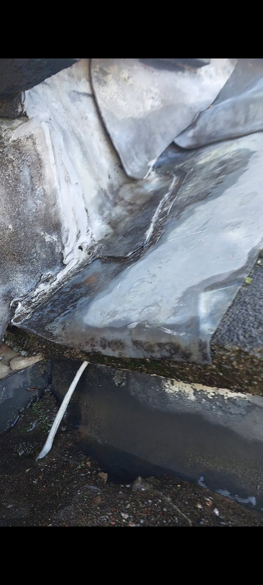

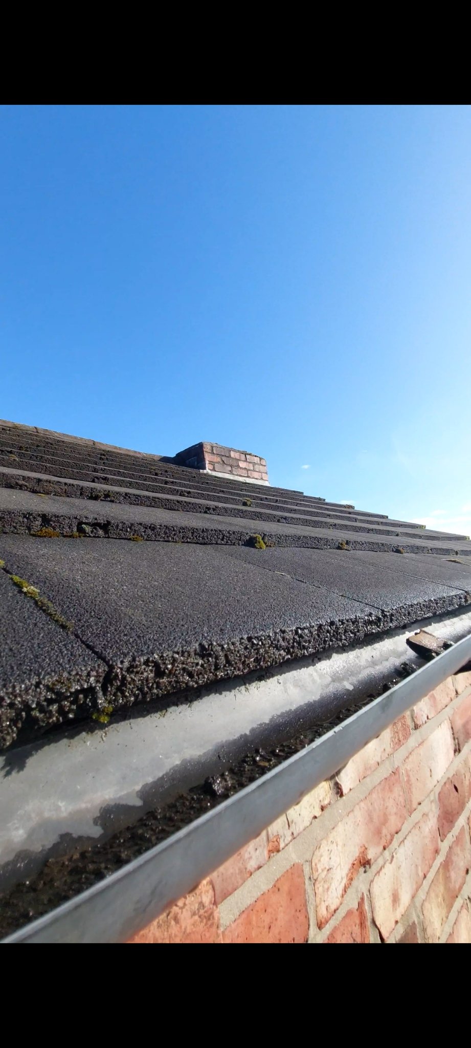

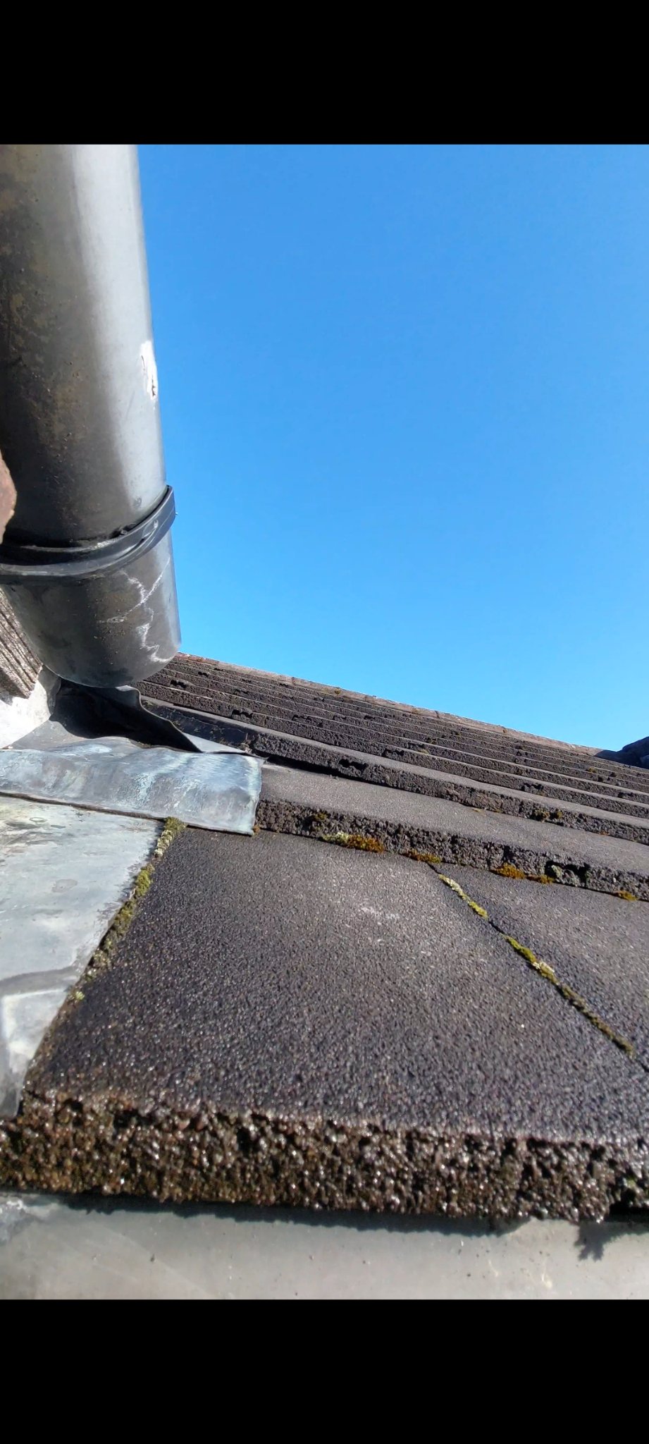

Which part of the lead work would it be getting under.? I was looking at the white sealant stuff on the left of pic 1 and was thinking maybe holes have formed and rain getting in that wayl. In the bathroom ceiling its basically the same position of the leak.

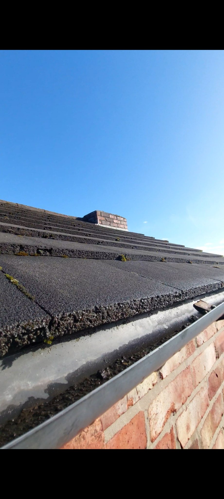

OP,
The abutment flashing is a mess.
Briefly, you would be better off with cover flashing and soakers.
But you would first need to remove all the visible flashing, & lift the abutment tiles to examine the conditions below the tiles.
I assume its a dormer with two valleys higher up - what condition are the valleys in, and whats the state of the far side of the dormer at the other abutment?
