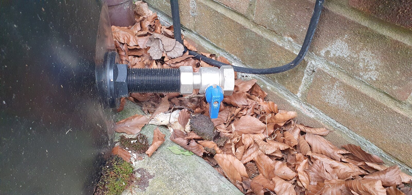

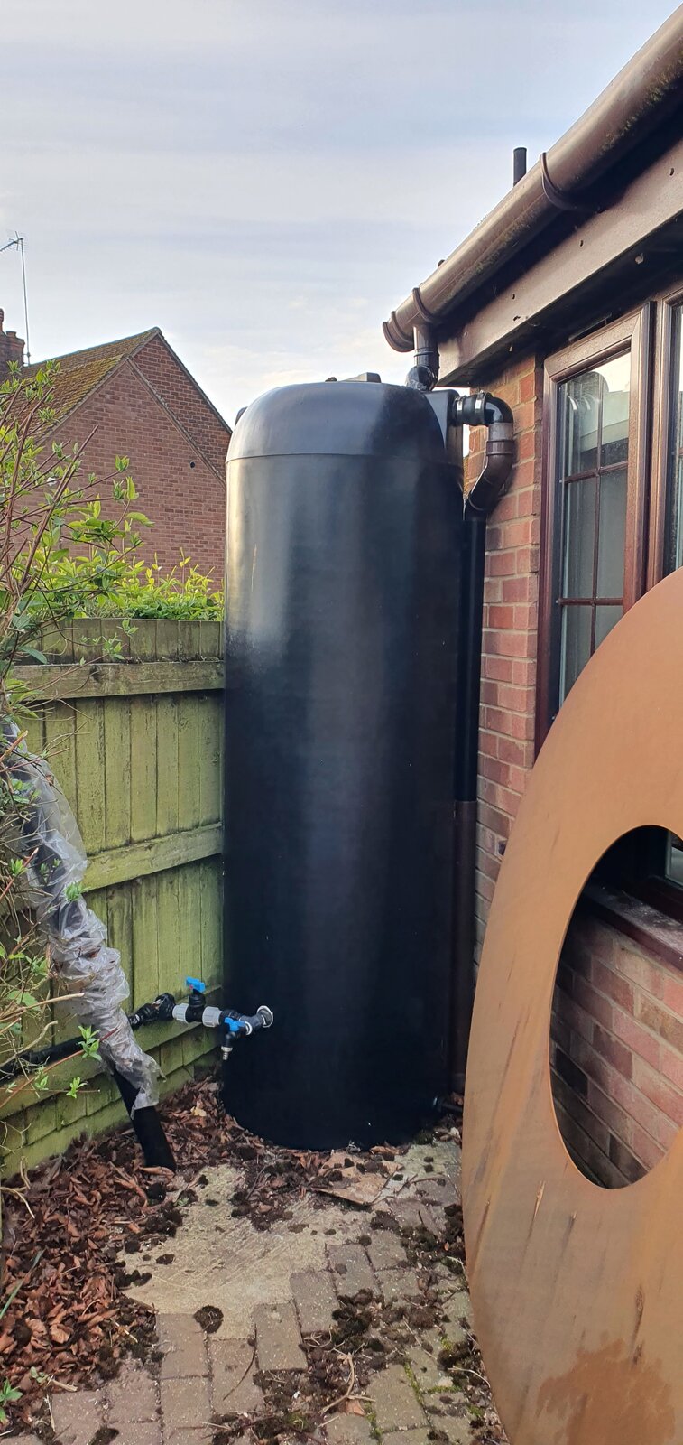

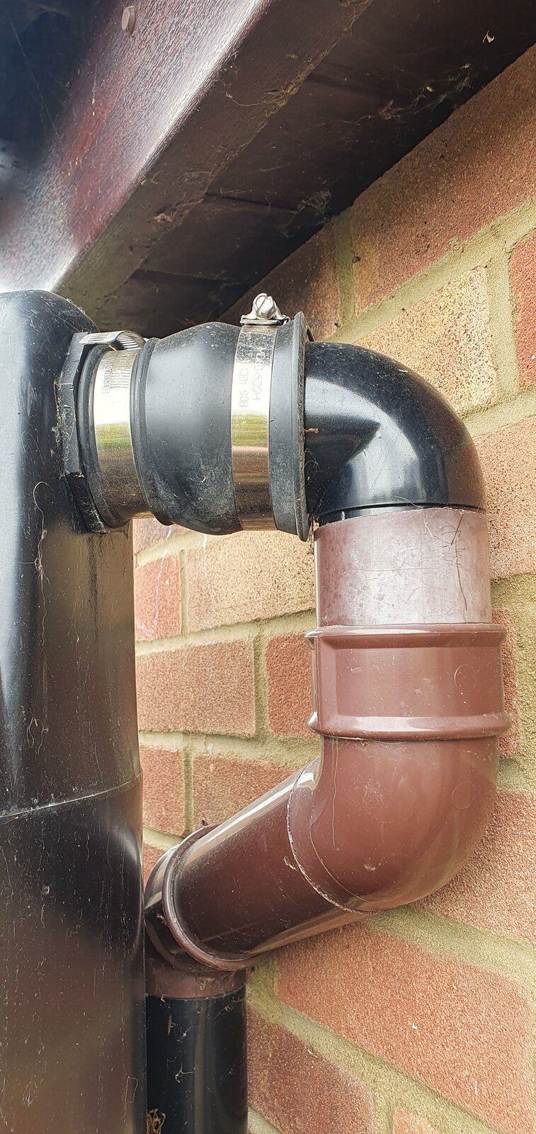

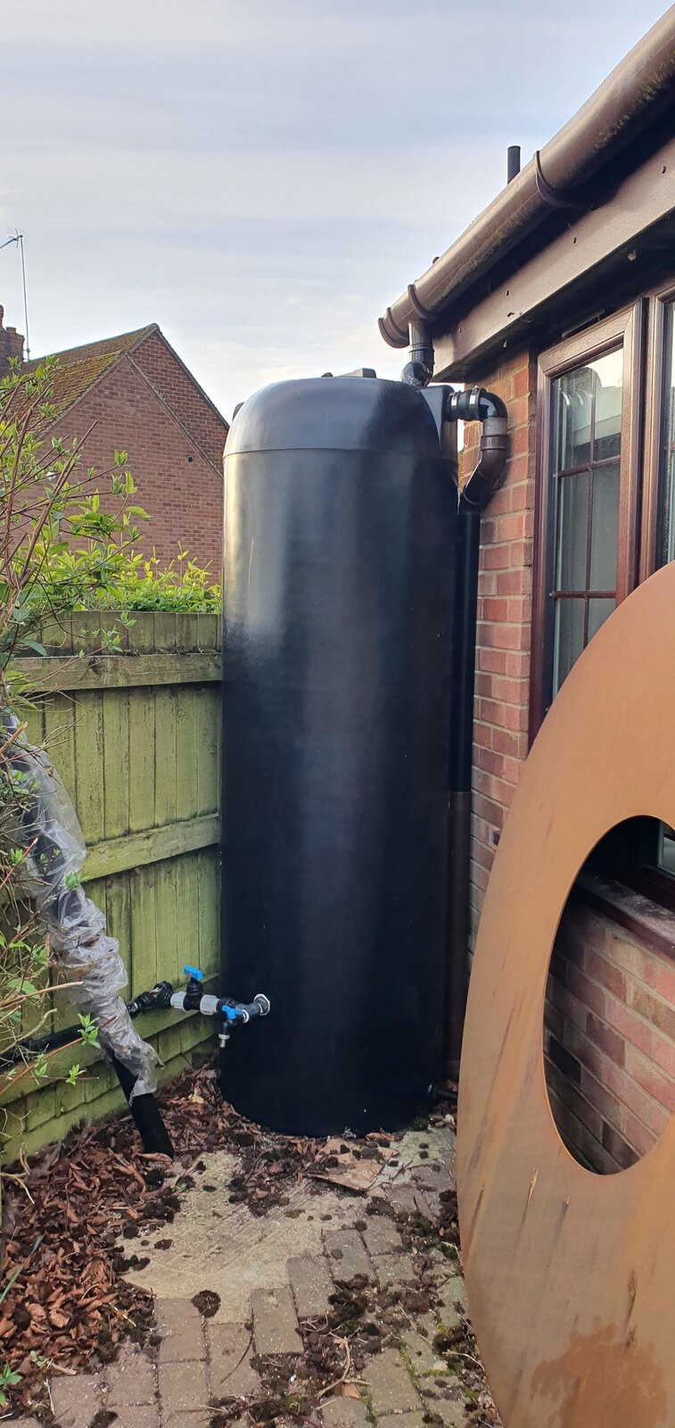

No, it's plastic, made by Enduramaxx. The pump is stainless steel.
Rainwater harvesting tanks have to go through approval processes to allow them to store water for use inside a building, flushing toilets, running washing machines etc. If you're just using it for watering the garden, you don't need an approved tank.
All very easy to do once you've got the right bits together.
A standard holesaw of the right diameter will cut the holes.
There's no audible noise from inside, unless the pump has been left on then there's a faint hum
