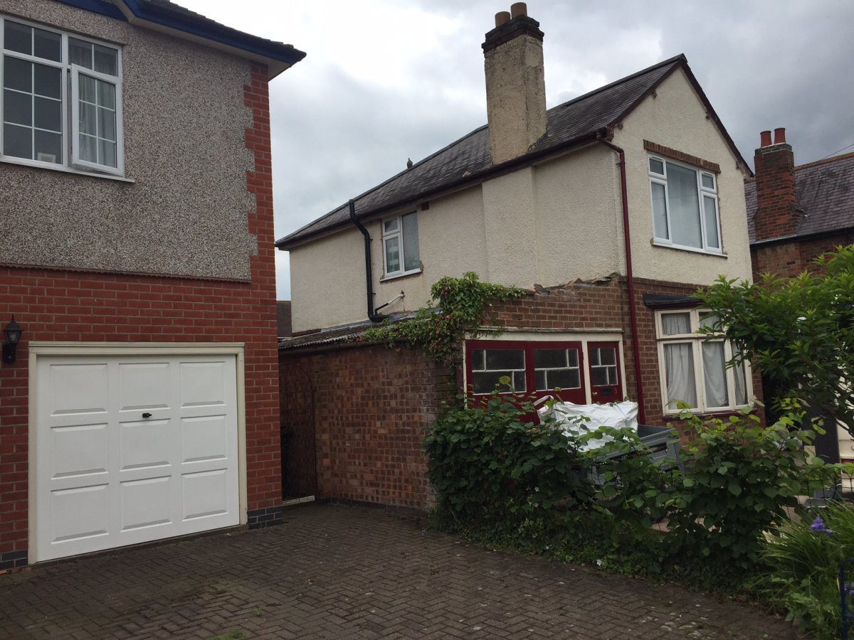

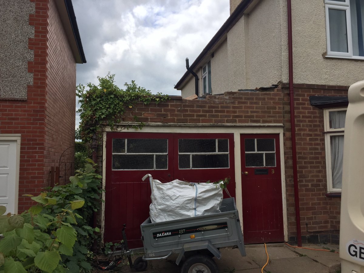

I have an asbestos roofed lean to style garage on the side of my house..
I want to turn it into a garden room and utility on the front ( with a big double door should we want to get bikes and what not in )
the roof is pitched onto a brick wall approx 2200 mm high ( including a 6 X 4 batton to which the roof joists attach
the other side is about 2.8
ideally we'd want the new flat roof at that height..
could we make a wooden frame to raise the height of the wall to the 2.8 high joist/rafters?
possible to put a thin series of windows along the top of the frame? I guess they would be about 500mm high and set 2200 off ground level?

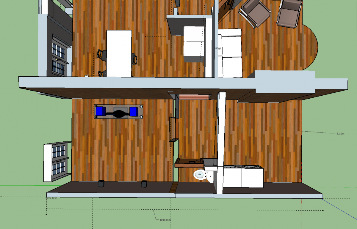

All things are possible but without some context (ie where the neighbours are, where the leanto is in relation to the front of the house and to the boundaries) it is hard to tell. Sketch the layout (I mean sketch- bit of paper with some rough dimensions of your house, your leanto, neighbours, road etc) then take a pic with your phone and stick it up here.
thanks for that
heres a sketch I made in the freebie sketch up. garden room to left ( will use as big as a french door / bifold as possible ) the utility at the from of the house with downstairs cloak possible shower room

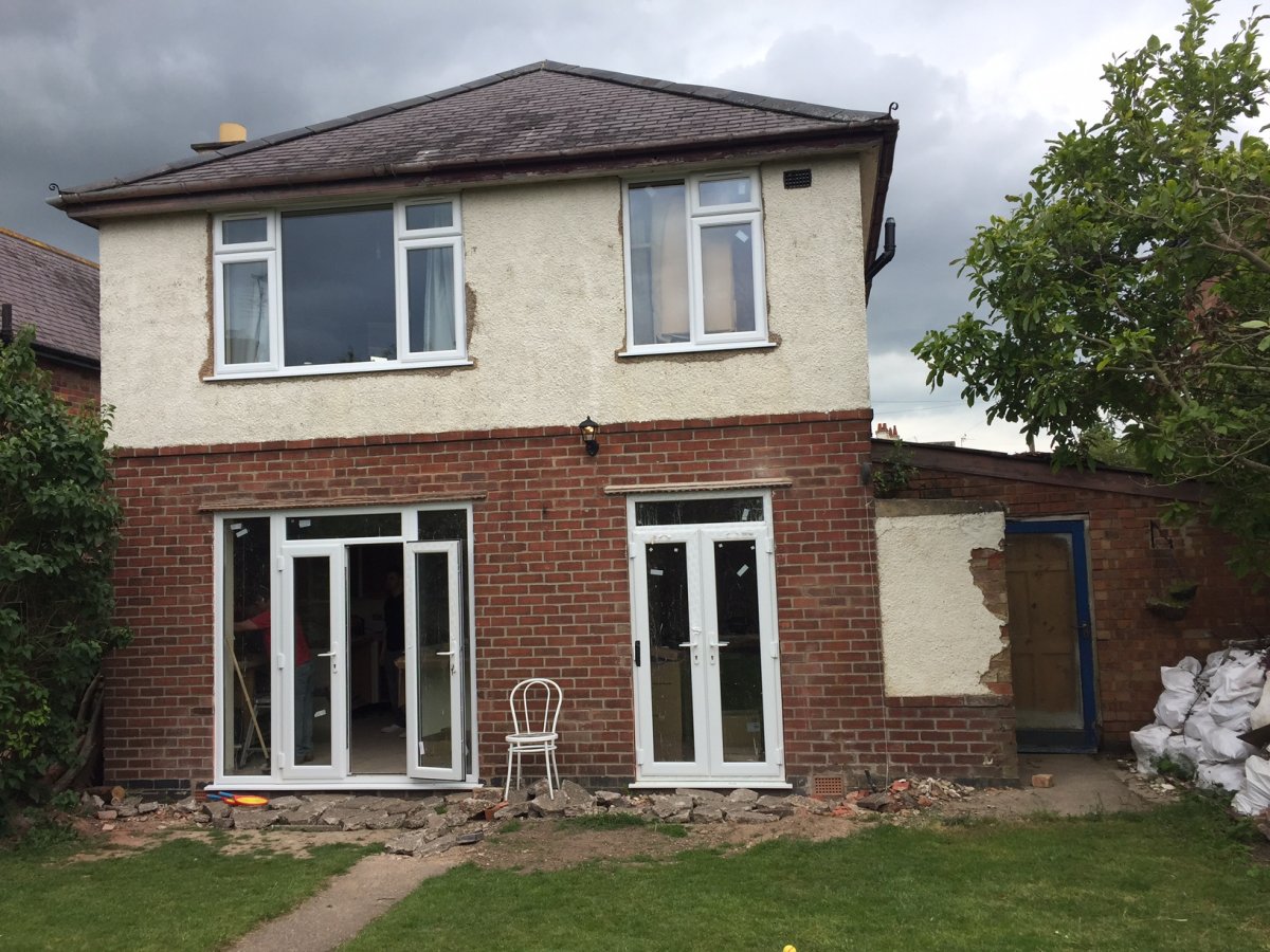

at the back of the house the lean to garage didnt extend the whole length of the house

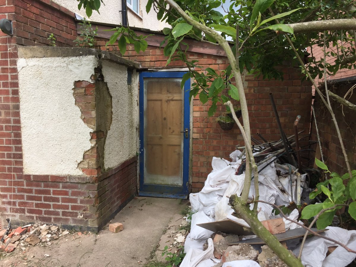

we think the Toilet which sticks out the back was part of the original structure and the lean to added on I would say at least 40 or 50 years ago. ( a previous owner loved ford capri's it seemed )
we plan to move the toilet and bring the extention up level with the back of the house - thats around 1600mm
we might utilise part of the wall of the toilet so we dont have to mess with the main house brick work?

Have a look at the Planning Portal https://www.planningportal.co.uk/info/200130/common_projects/17/extensions . A quick skim says you won't need planning permission but you will almost certainly need building regs. If you're doing it yourself then you can do it on a building notice (minimal paperwork involved), if you're lucky the BCO will advise you on all sorts of stuff. I'm not sure about your windows on top of the boundary wall- have a chat with your neighbour, see what they reckon to them. You might not be able to open them (unless they opened inwards)
From an aesthetic point of view I'd keep a pitched roof. Nothing stopping you setting the top of the roof just under the windowsill, long as eaves height is less than 3m you're still PD.
