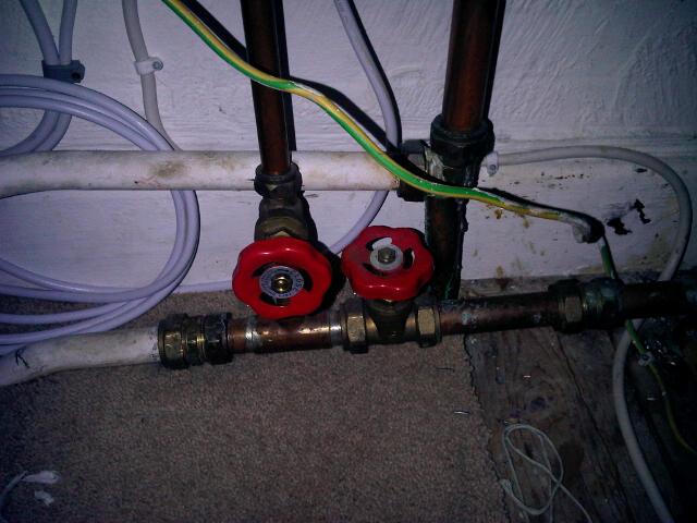

Adey's instructions state "best practice" is on the return after last rad but just before or after pump is"suitable". BG did the pipework you see in the picture.

I was recapping on what the BG engineer had altered when he replaced the pump. He altered the gate valve to the left in the picture above which appears to be a manual 'bypass'. This gate valve is in the pipe having the two zone valves just before it and joins with the return pipe.
I read another post which suggested that a manual 'bypass' should only just about allow flow through when both zone valves are closed so I closed the gate valve which was about a quarter turn open and lowered the room and cylinder stat so both zone valves closed. I then opened the gate valve very slowly until the heat of a flow could be felt the other side of the gate valve.
Since I did this earlier today, no more boiler cycling whether CH/HW or both are calling for heat. House also seems to be heating up more quickly as presumably more flow is going into the CH circuit. Presumably the HW would also be heating more quickly.

I know what you mean but BG should have fitted an ABV originally and we must be losing flow back to the boiler that should be going to the CH and/or HW circuit. Presumably there is no flow across an ABV whilst CH and/or HW need heat?
Just to complete this topic, I was wrong when I said I thought it was working - it wasn't.
Made a complaint to BG about the original piping not having an ABV and a senior engineer visited. They subsequently replaced what did prove to be a broken CH zone valve as well as replacing the gate valve 'bypass' with an ABV. The CH zone valve internal workings were proved to not be fully working every time despite all checks passing satisfactorily. It fooled the previous 2 BG engineers.
Since then, everything great! Boiler quieter and house warmer! Just need to recover from my OCD regarding the system now which I've suffered from for 2 years since the original muppets installed it!
