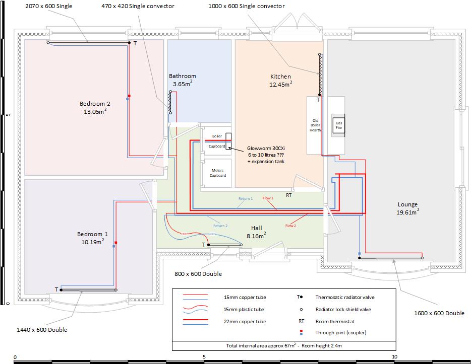

In the 4 years we've been in the property, I've never been able to get a temperature drop across either the boiler or radiators of more than about 2 degs C (except when the rads are heating up from cold) without the boiler short cycling more that it does anyway. BG engineer couldn't either and suggested the boiler (Glowworm 30CXi) was too big and this was probably the reason for lack of temperature drop and short cycling.
Below is a floor plan of the bungalow showing the central heating layout. The 22mm Flow 1 & Return 1 pipes run from the boiler cupboard along the hall to the lounge with a short loop near the lounge doorway then back down the hall (Flow 2 & Return 2) to serve the hall, bedrooms and bathroom.
Running the 22mm pipes back down the hall to serve the hall, bedrooms and bathroom seems odd, a waste of 22mm pipe and inefficient when these rooms could have been connected outside the boiler/meter cupboards. I wonder if the extra 22mm Flow 2 & Return 2 pipes and connection of the hall, bedrooms and bathroom to them were an attempt to mitigate an oversize boiler???
All the pipe insulation is the old lightweight soft sponge type that is either missing or falling apart and needs replacing. The 22mm pipes run along the hall are too close together, even for the existing insulation, so re-insulating them will be difficult unless the new insulation is severely squashed and forced into place. If the new boiler would not need the extra 22mm pipe running back down the hall, could it be removed making enough space for the new insulation and increasing efficiency?
I'd also like to rationalise the pipework where possible and replace the flexible pipes serving the hall rad with copper due to possible rodents under the suspended timber floor.
