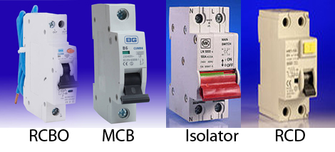

technically a RCBO is a RCD, with the MCB combined in it, but not sure if you're getting a MCB and RCBO mixed up? A RCBO will have a test button.
