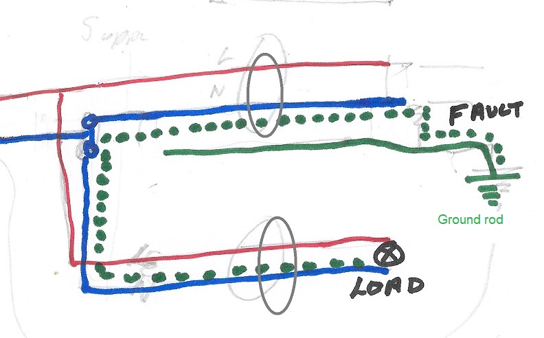

I think I have found why both RCDs can be tripped but only when the supply is a TT
The dotted green path is a sneak path to Ground

I think I have found why both RCDs can be tripped but only when the supply is a TT ... The dotted green path is a sneak path to Ground
I'm not so sure about that. The total current (normal blue path plus dotted green 'sneek path') through the N side of the lower RCD will surely be the same as the L side of the RCD (hence no trip), won't it?
Kind Regards, John

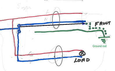

There is no load on the top RCD so no load currents through that RCD. The only current through that RCD is the sneak current ( dotted green )
There is no dotted green sneak path through the lower RCD.
The only sneak path is the black line along the top neutral to the fault.
The other neutral conductors carry normal load return current apart from the small amount missing upstream of the joint.
Indeed - so the top one will trip. However, as I said, I see no reason why the L and N currents through the lower RCD should differ, since they are simply the currents going into and out of the load, so that one shouldn't trip.
Am I missing something?
Kind Regards, John
There is no dotted green sneak path through the lower RCD. ... The only sneak path is the black line along the top neutral to the fault.
That depends upon what you mean by the "sneak path".
A small proportion of the current going (from the load) through the N side of the lower RCD will ('upstream') go via the other RCD and the N-E fault to earth, the remainder (great majority) going through the normal return path back to the tranny. As discussed, that 'small proportion' may be enough to trip the top RCD, but I still see absolutely no reason why the bottom one should trip.
Kind Regards, John
I was using your wording.
Yes but the Neutral current from the load is not increased because there is a leak elsewhere - so no sneak current at the bottom RCD; just the load current.
Agreed, but that small proportion is part of the load return current to the joint which is then missing from the back to tranny return path upstream of the joint.
