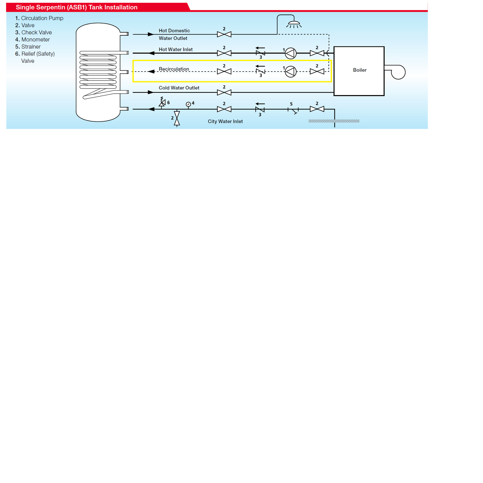

Hi,
I have 160 litre vented DHW cylinder. I am trying to put a re-circulation line from cylinder to farthest fixture which would be going through two bedrooms till it reaches the farthest fixture.
I have bought a recirc pump Grundfos comfort BA 15-14 BA which i would be putting on re-circulation line. I have attached schematic for recirculation line for convenience. Couple of questions:
- Do I put the pump pumping into the cylinder (in cylinder, just as shown in picture?) or pumping away to farthest fixture?
- Is it worth putting extra money on 50ft copper pipe when the recirc pipe will be going through to the bedrooms to get to the fixture? I was thinking of getting away with cheaper alternatives than copper. Am I right in my thinking or should I stick to copper.
- can I put PEX or normal PPR pipe for recirculation line? pros or cons.
- the outlet of recirculation line is 3/4", can I put a narrower pipe 1/2" for recirc line?

Pump on return
Pipework needs to be copper or MLCP (plastic with a aluminium core)
We use tectite metal with tectite classic fittings and correct insert ,mainly because it's standard 15mm and 22mm and not 16mm.
Do not use standard plastic barrier pipe its not designed for the constant temperatures on re circulation systems.
Thank you. Understood pump on return. The length of the recirc line is 50ft to the hot water recirc inlet, Whereabout on the re-circulation line should I be putting the pump at the start of line from farthest fixture or near to the HW cylinder.
Install it near the cylinder. You can use plastic pipe provided it's not running continuously although MLCP / copper is a better option. Make sure it's well insulated. I'd use a motion sensor to control it so it only comes on when that room is occupied

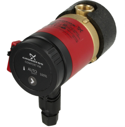

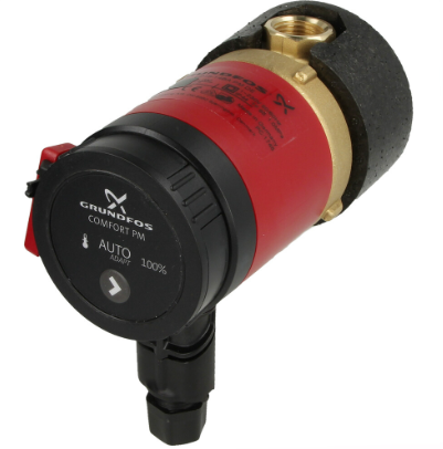

Which motion sensor to use for Grundfos comfort series pump?
Ive used these before. They supposedly find your patterns to give you the right performance.
However people do tamper with these things and maybe cheaper less intelligent pumps get fitted as replacements.
However you seem up on this so you should be ok.

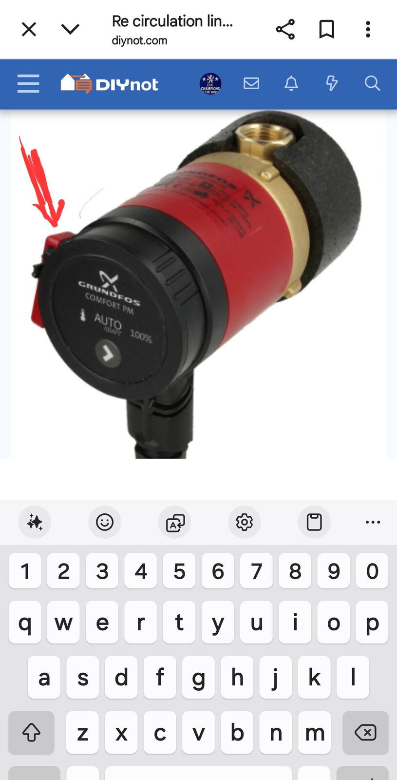

Thanks. The pump didn't come with the sensor, where can I source the sensor for this pump?
Its all as one.
The sensor is coiled around the end. The red bit on the side is the sensor. It should pull out.

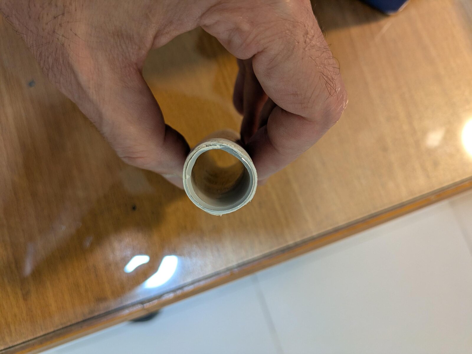

From my experience its the plastic fittings and not the pipe that's the problem.

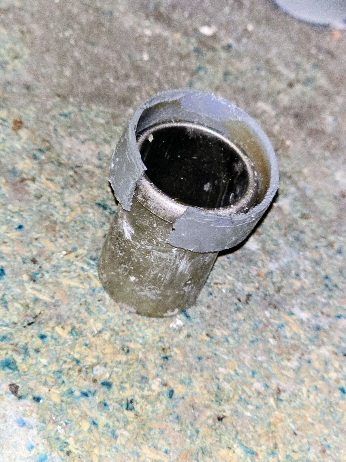

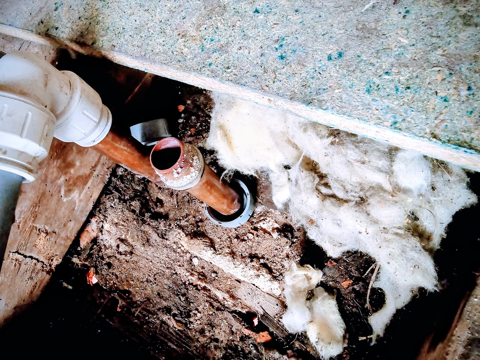

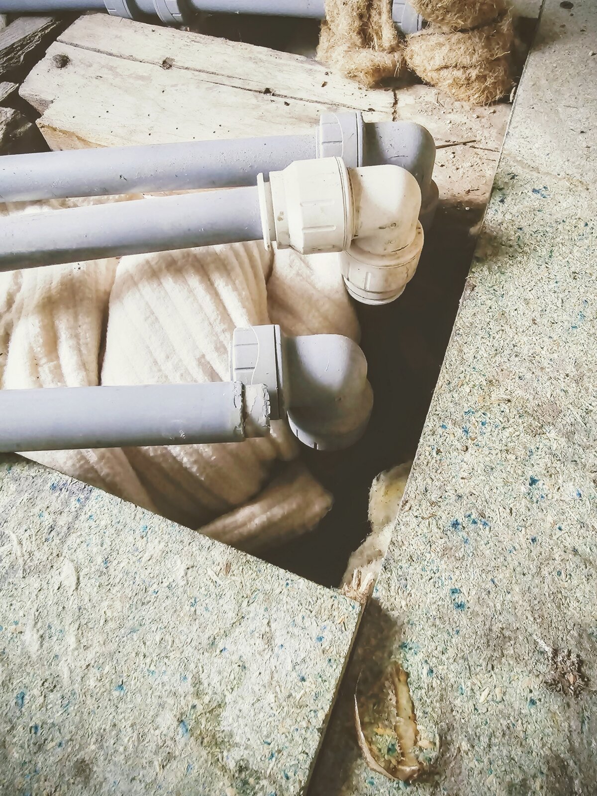

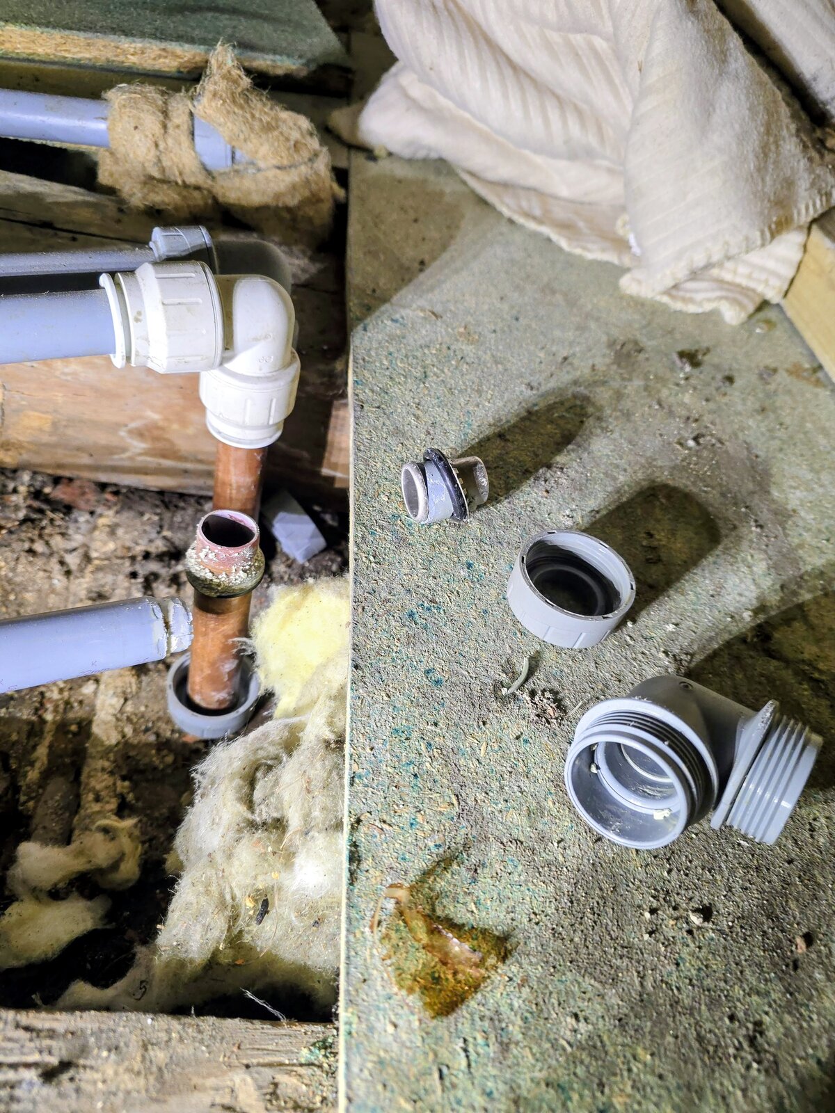

On secondry circulation systems it is the pipe that's the problem.
Standard barrier pipe is designed to carry hot water then cool again. On a recirculation system that's run continuously it never cools and the inner part of the tube can strip out.
When the plastic pipe manufacturers stopped its use of barrier pipe on recirculation systems probably 10 years ago we switched to MLCP
have had zero problems.
You are right. It was just that the pipe I found failed inside the fittings.
