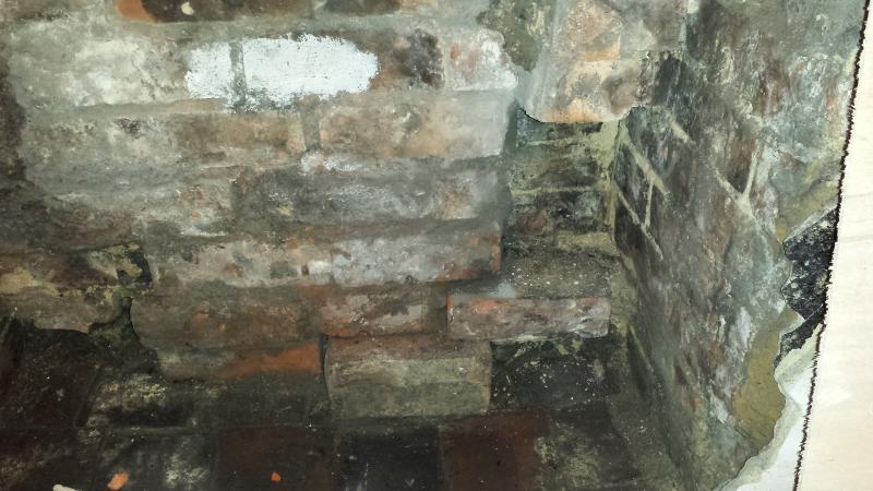

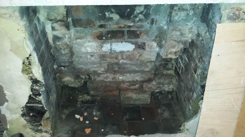

similar kind of thread to the chap who has posted recently, re-opened up a fireplace over the last week so that we can install a woodburner for the winter. Got a couple of questions so I know which direction to proceed in, mainly to do with the back of the fireplace.

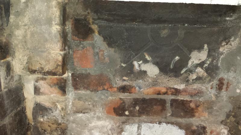

Basically I'm happy with the sides of the fireplace, but the brickwork for the back of the fireplace just doesn't seem right or correct. As you can see there are bricks missing as well as bricks jutting out, mainly on the right hand side. Where there is missing brick there is another layer of brick behind it, which upon measuring are further out than the outer wall of the house. I know fireplaces were generally 2 skinned when in terraced houses so slightly confused with what appears to be an additional layer if brickwork.
I've had a look up the chimney to see how far it goes but struggling to see for certain if it stops or carries on up, so just after some advice on if this kind of thing is common.
My other question is regarding the final finish ready for a woodburner. I am in 2 minds whether to keep it as brick of cover the brick if it doesn't scrub up. if I decide to cover the brick I have been looking at thick sandstone hearth tiles for the hearth and was wondering if they would be ok to use on the back and sides of the fireplace? I don't really fancy having it plastered and painted so thought thick tiles would look nice.
Keep going until you hit the flat wall at the back. All that brickwork is from an old back boiler used with coal fire.
hi Jeff, cheers for the reply.
I had a look earlier and that brickwork in the picture only goes up about 4 foot then slopes into the wall at the back so I know it's not supporting anything. The only concern I have is this:
On one side just under the top of the fireplace is some brickwork that goes from front to back into this third layer of brick which has a slope going up into the chimney (not very far I might add, maybe about a foot into the sidewall of the chimney). My guess is that this was used to direct smoke up the flue but don't want to get rid of it if it's going to be needed for the woodburner.
My feeling is that it won't matter if it's not there as I know the woodburner will have a flue in the top anyway, but I could be wrong.
