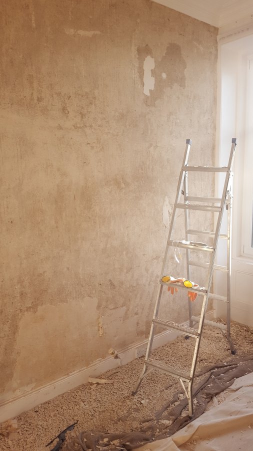

Here is a picture. Most of what you can see is the backing. At the bottom by the ladder you can see a little bit of the old finishing plaster that I haven't removed yet.
to my eye it looks like gypsum plaster, by the colour and the trowling marks. Did it fall off when you used a steamer and overheated it?

I didn't steam it, just sponge with cold water and scraper - and I was quite gentle. Parts of the plaster were off the wall even under untouched wallpaper. i.e. you could push the wallpaper and see/feel the plaster beneath move a bit. Once stripped those bits came off immediately, but gently pushing the scraper on the edge of what remained caused huge junks to easily peel off.
It may be that it is much more recent, I believe teh house was renovated about 10/15 years ago.
If it is gypsum, then I guess I could just use bonding to fill in the deeper holes and then finish plaster? Or do you think I could do it all with multi-finish?

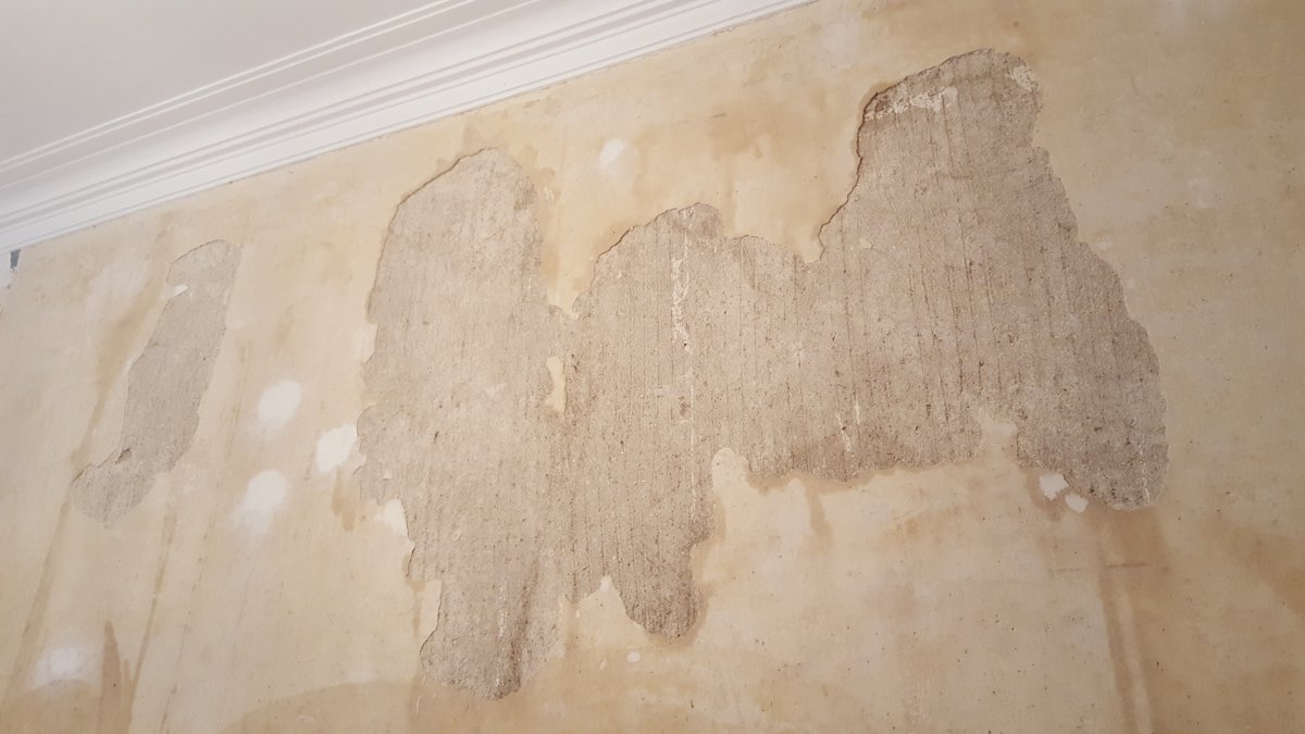

This picture is slightly closer from before I peeled it back. For scale I think (from memory) that the lines/grooves are about an inch apart.
you can also recognise gypsum by the smell when wet, I think it is. The lines in the backing coat are scratched in with a "devil" (think of a scrubbing brush with a row of nails instead of bristles)
I think you will find it easier to use a backing coat and a thin skim of finish, or it will crack. It is easier to get a thin skim flat.
