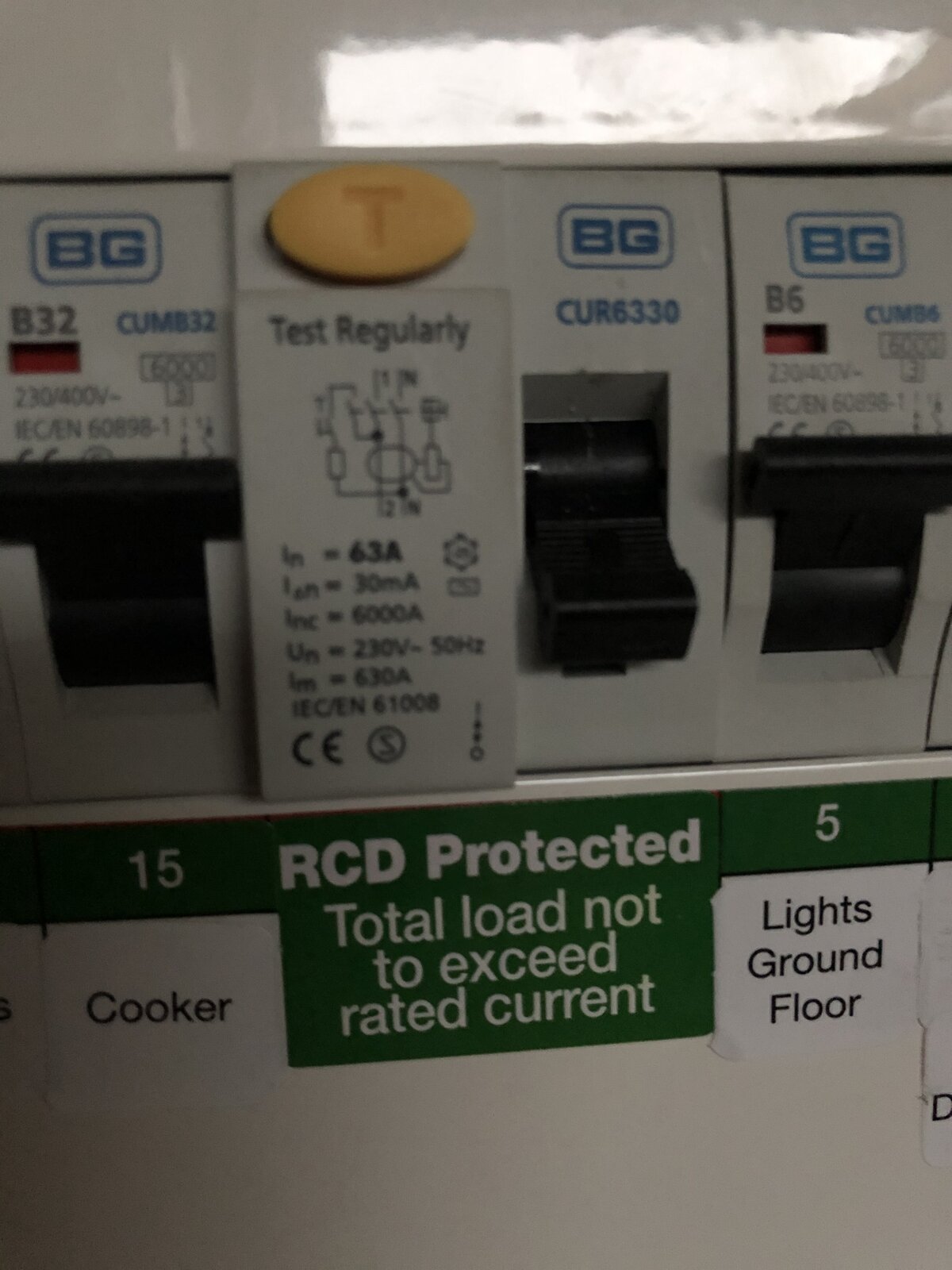

Does anyone know why the attached RCD keeps tripping? It’s for the plug sockets. Not tripped for a good few weeks then this evening tripped about 4 times at about 1 or 2 minutes apart now seems to stabilise again.

As it is for sockets, the obvious first thing to try when it is tripping often is to unplug everything plugged into that circuit. If it still trips, you need to investigate the fixed wiring, if not then the problem is something which you have unplugged. It may require several attempts to be certain you have found the problem.
The actual problem will be either a leak from live to earth, or neutral to earth.

Yeah that. Are there any outdoor devices (security lights, cameras, hot tubs, sheds) fed via that RCD. Don't go thinking it has gone faulty- that is possible but it is much more likely to be responding to a fault condition.
That RCD will be feeding other circuits as well as the 'plug sockets'- a wider pic would help
