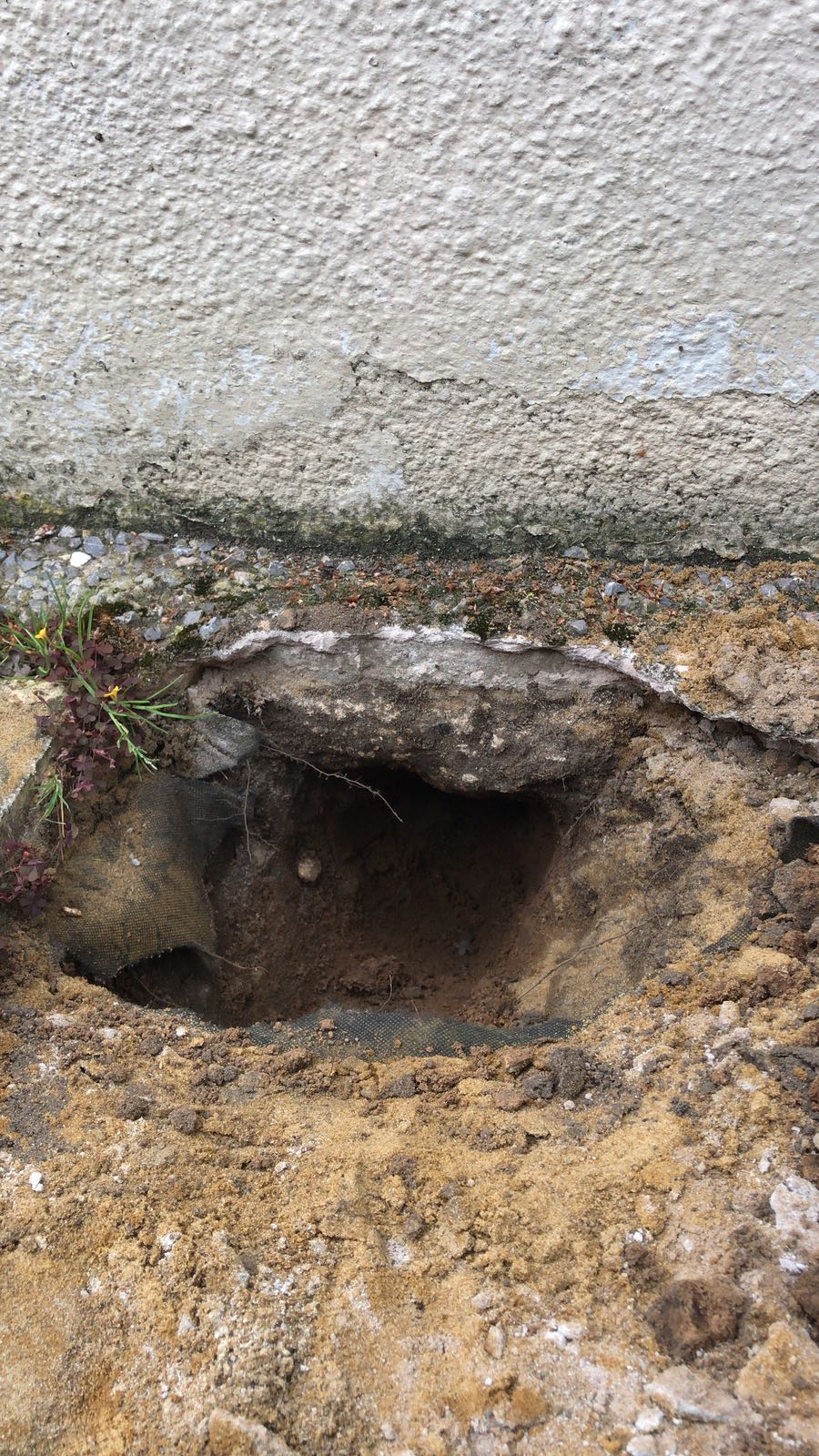

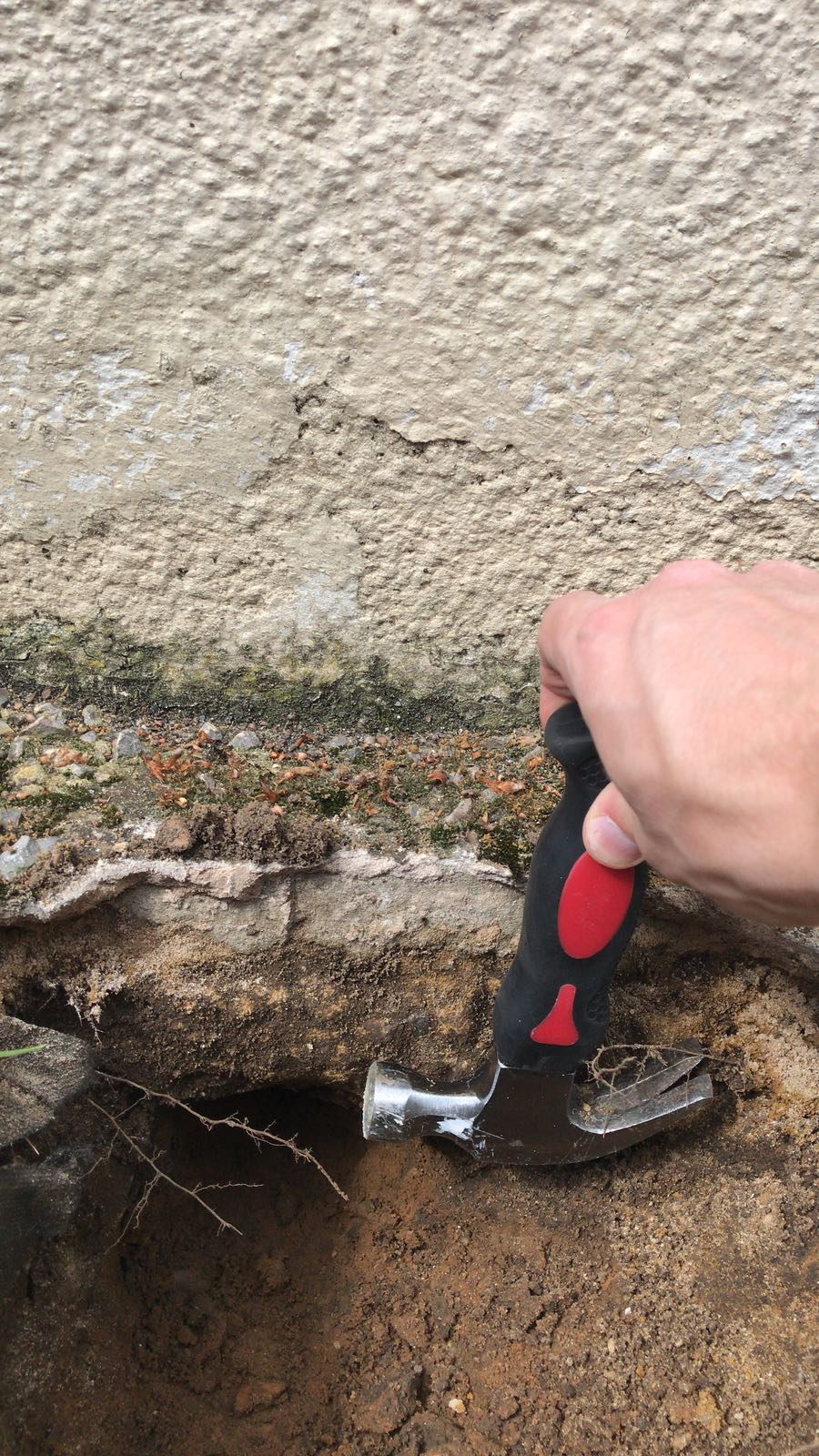

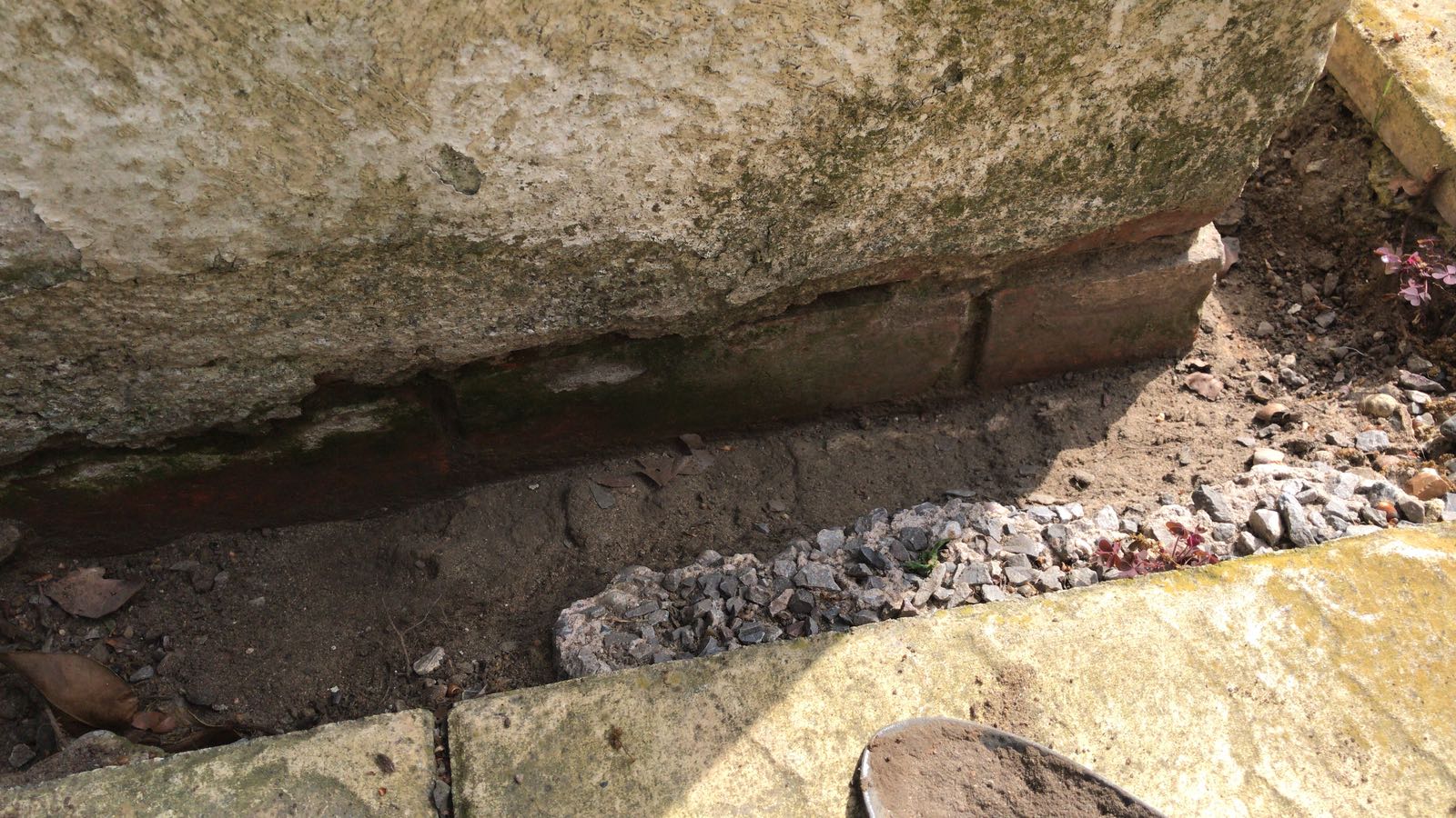

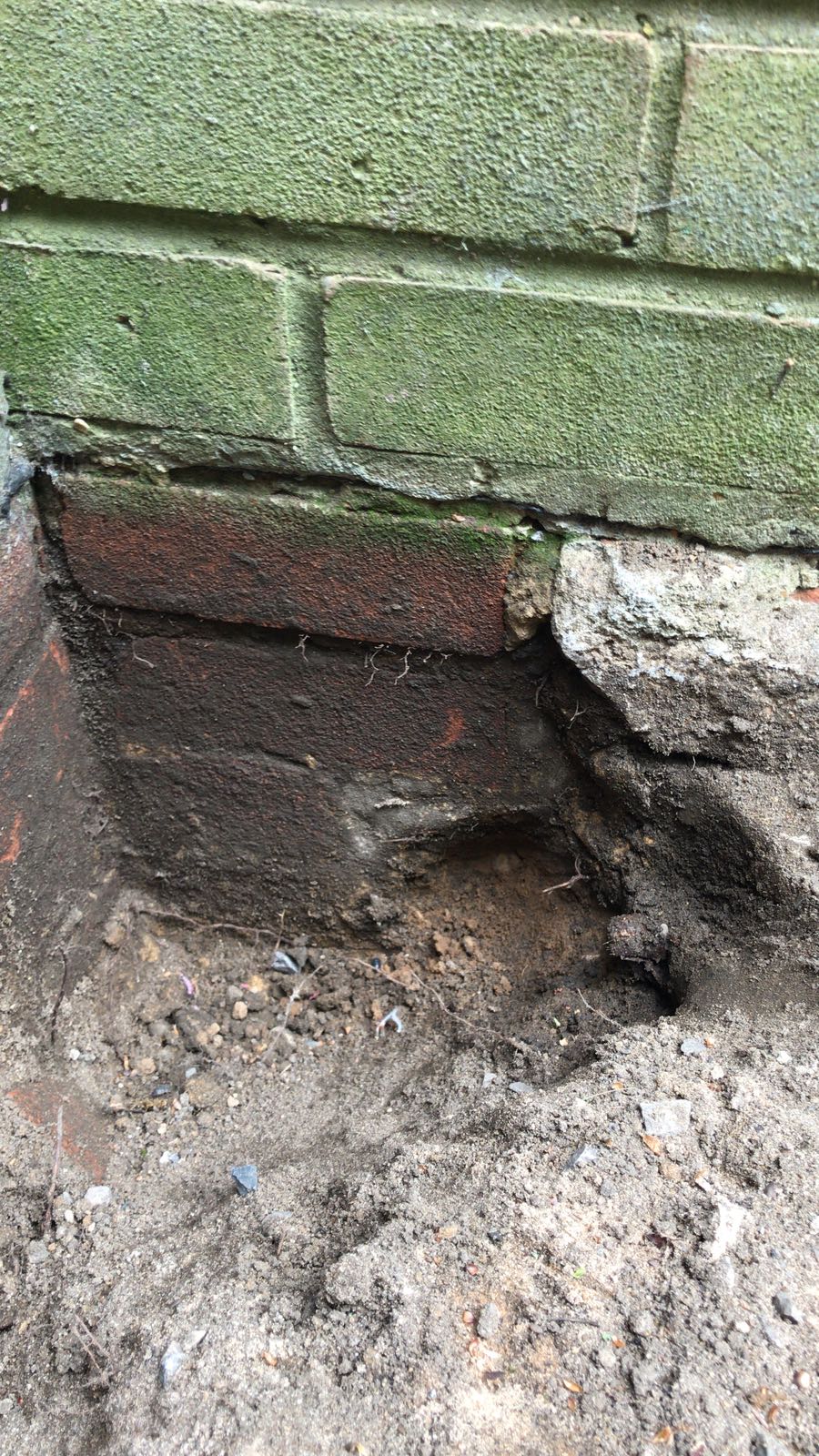

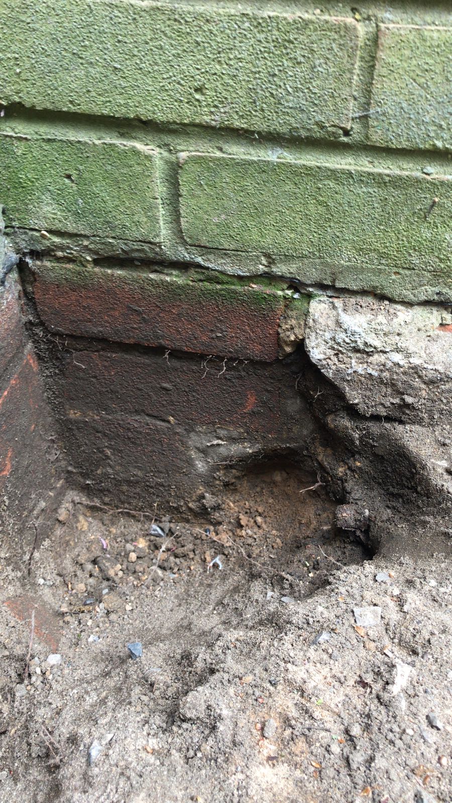

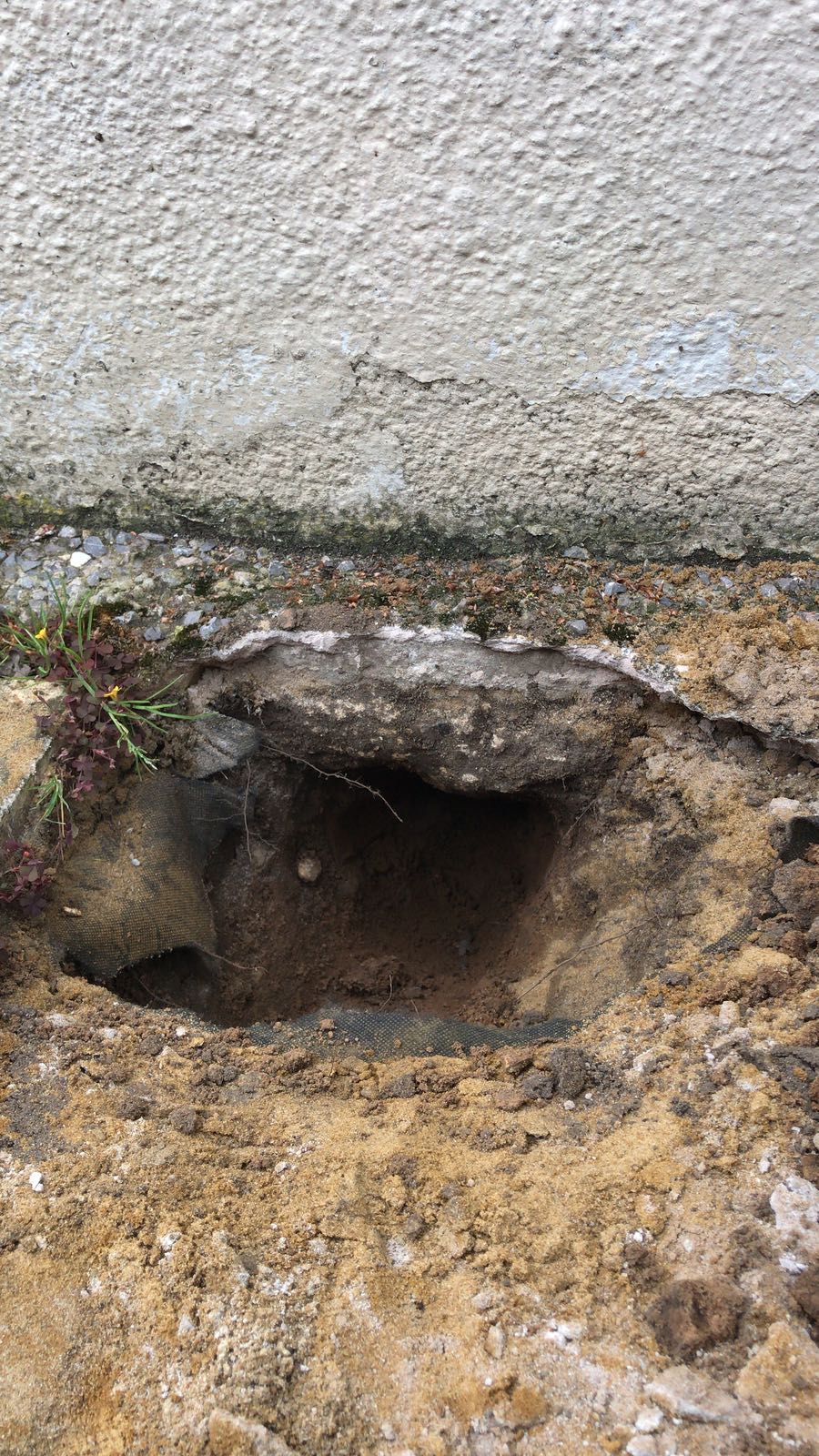

Reviving my thread as I’m curious again. Photos attached this time of where I have done small test digs..
One corner. The left wall is the garage. The wall on centre of frame is the bottom of the extension. At first I was reassured I was seeing bricks deeper into the groin but then the appear to end just two bricks below ground level
Hole I dig with a trowel under the extension. The concrete around the edge I think is added after the extension, it doesn’t seem I have an equivalent on the other side
Small hammer for size comparison
Brickwork underneath the crabby rendering. This is an old photo, I can’t recall if the flat concrete under the bricks is still there or not. I chipped some out in the past as it was like 2cm thick and appeared do be added after the extension
Looks like junk, but as you say it hasn't fallen down so presumably the soil is holding it up OK.
I guess your approach depends on whether you need to eliminate future risks or not - probably whether you're going to live there for ever or tart it up and flog it on at some point.

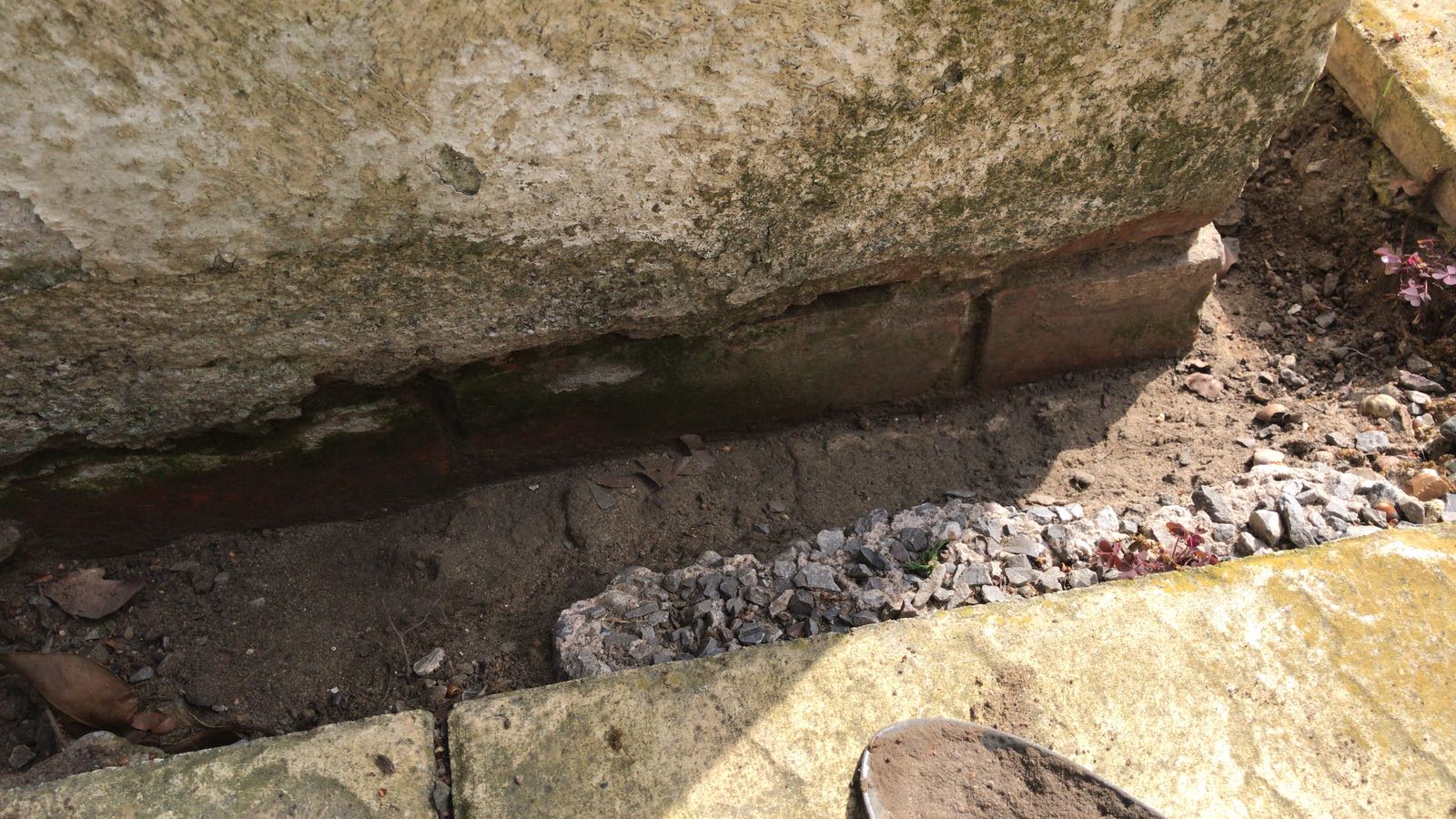

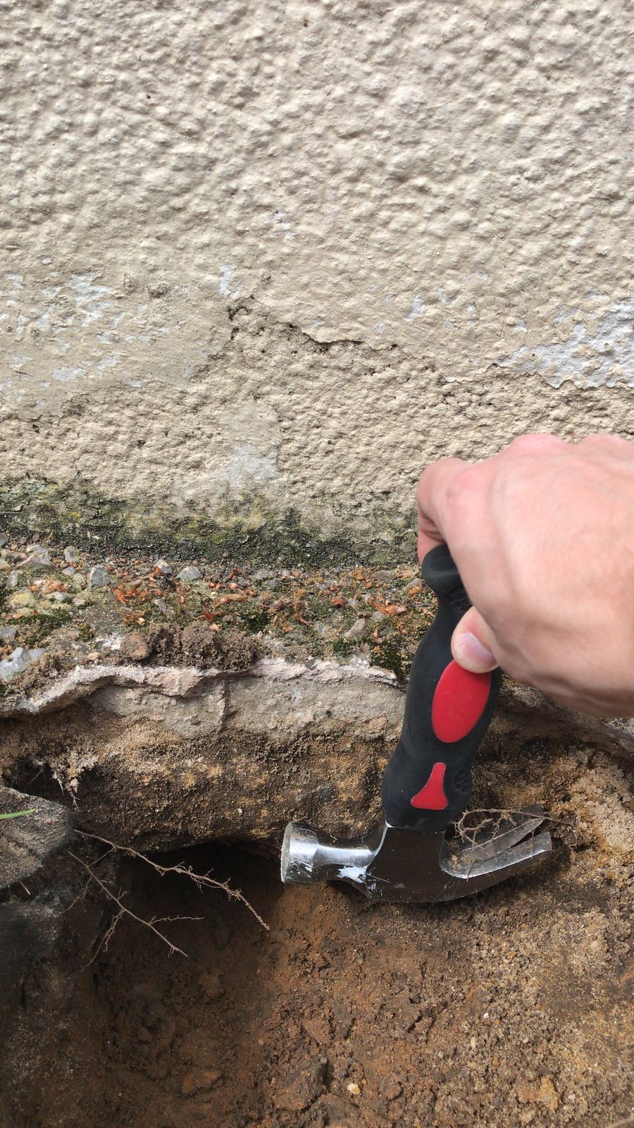

Reviving my thread as I’m curious again. Photos attached this time of where I have done small test digs..View attachment 379183
It's a low-end structure built upon either a slab or shallow strip foundations. Initial thoughts are the ground looks good, but that could change.

My main reason for asking is that I want to relay patio next to it. Which would involve digging down 10-20cm or so beside it for the sub base or drainage channels to be laid.
I’m paranoid that disturbing it more would cause issues. But then I imagine the garden has been through many changes in the last 60 years and this has (supposedly) been standing since then.
There is some rough, wobbly rendering around the bottom third, only at the front, which I suspect is covering some sort of bodge or issue..! But I’ve been here for 9 years and I was concerned about it from the start, and I’ve not seen any changes to its structure in that time
