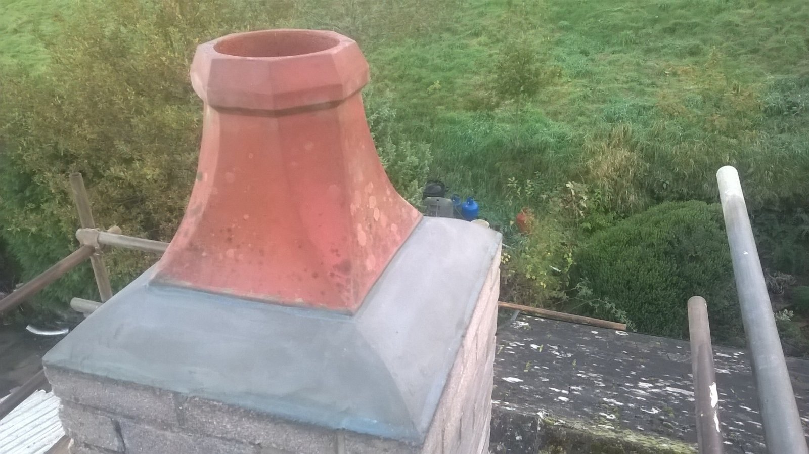

I mix my flaunching render with more Sbr than water,sbr slurry all pot contact areas ,inside and out and after flaunching wipe the pot joint with brush dipped in sbr, and I use sulphite resisting cement on chimney repairs.It may seem over kill but seeing the damage first hand that tar can do, I like the belt and braces approach
Thanks litl can you advise the mix and type of sand? I am sure I heard somewhere that plastering sand is a good choice as its kind of in between soft and sharp sand but I may be wrong on that. Nice job in the pic, gives me something to aim for lol
I dont know if the sand makes a difference if using Sbr but I use 3.5 plastering sand to 1 Sulfacrete, not to wet to avoid slump, the tacky sbr slurry on brick and pot surface will help the bond. if you use Sbr wash your tools pretty quick

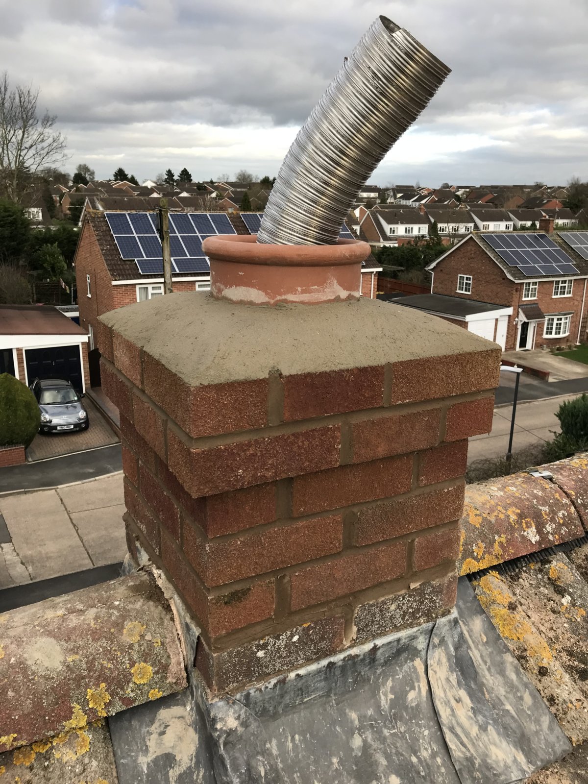

All done, just need to sort the flue out at the top, not perfect but I don’t reckon it’ll be going anywhere and hopefully not leak. Thanks again for the advice
