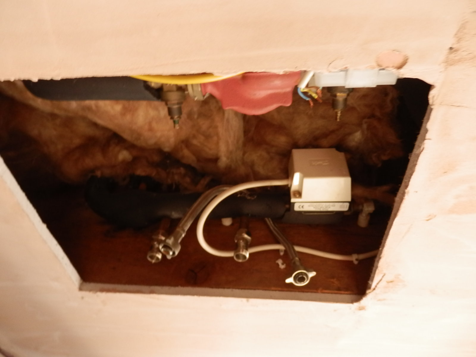

We have a hot water solar panel on the roof. A couple of days ago the pump was making a sqeeching noise and I thought the pump was broken. I disconnected the pump and planned to look for a new one but also wanted to check the function and removed it. On the bench the pump worked fine and I refitted it, but despite the panel showing a higher temperature than the hot water cylinder the water was not getting any warmer. Even though there was a dribble of liquid coming out of the pipe I think the system has run dry and needs refilling / recharging.
How best can I refill the system???
When it was fitted the company put a T with an isolation valve under the garage roof. The T has a 15mm connection.
The solar panel is on the same level as the hot water cylinder.
Has anyone refilled their solar panel using a pump?
Are there any DIY / pumps available for this kind of job?

The pressure gauge, expansion vessel and blow off valve are in a different location. It reads Zero. I do not know where the fluid has gone, but we have always had some escape from the valve.
The panel temperature readings are up to 80°C. we have some shade from neighbour's trees now from the west.
What is that filling loop for ?

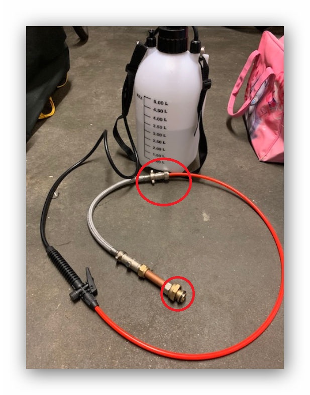

Thanks for the advice on Navitron. I got some helpful pictures but would like to know what the parts use are.
I did not get far asking for the parts involved though.
Can anyone tell me what connectors they would have used on attached picture?
