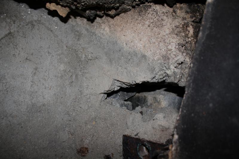

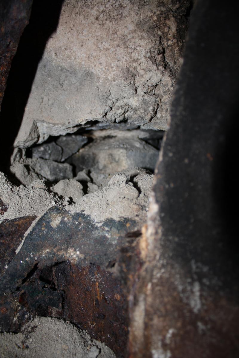

i then took off the side plate where the boiler was and this was when i found the cavity and the sandy material began to pour in. The close up shows the cavity a bit closer with loose fill, but its not very clear, im in the process of removing the back plate now which will hopefully improve visibility.

this obviously means i need to repair the void present on the right side:
so with this knowledge, the space in which the fire sits is not big enough to open as a small inglenook anyway so i will need to replace the original victorian style fire.
in terms of a repair on the void, can i patch this with some brickwork in the void and then render it with something fire-resistant?

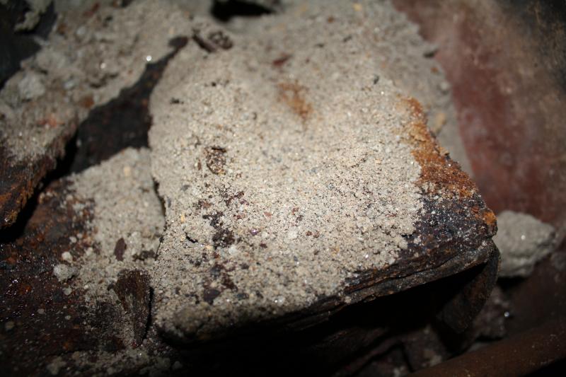

Also, im still in the dark as to the nature of this loose material behind the back/side plates:
im still working on the presumption that it is the insulation material behind the fire plates (presumably once some kind of mortar mix which has disintegrated? but could it be harmful to me if i clean it out? im still dubious about getting too stuck into it until i know what it is.

Vermiculite and cement :idea: tends to look like Asbestos :eek: :eek: BUT it aint.

thats a relief! thanks
