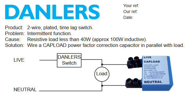

However running the switch wires as shown can cause capacitive and inductive linking, using load capacitors can help, load-capacitor.jpgbut not sure that is really a good idea? Some times we have no option. The use of switches which use a small current through the switch to power the switch has exacerbated the problem, with LED bulbs having a shimmer when switched on, and either staying on dim or flashing when switched off, where no neutral at the switch I have moved to Tapo (TP-Link) which has a battery in them to get around the problem.
I am not sure how your humidistat switch is powered, but if no neutral then likely it puts a small current through the load, and the big question was it designed to work with LED, so many switches of that type were designed to work with tungsten lamps.

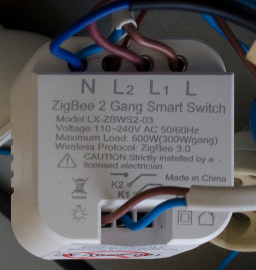

If not your own house clearly you need to do what the customer wants, one needs to be careful with double pole switches, they look so like intermediate switches. I have needed to use a relay with central heating system, the problem is where to mount, some will fit in switch back box, but this one DSC_6061r.jpg I used to work a landing lamp to give smart options, would need a very deep back box and a neutral, I fitted it inside the lamp, but since we don't know what humidistat switch you have tried to use, or how you tried to wire it, I can only talk in general terms and hope it gives you some ideas.

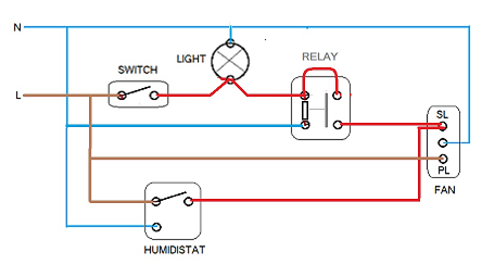

Are you able to recommend a relay? I can fit it in the loft so there will be plenty of space for it. The fan is a standard inline fan with timer. The humidstat is the Manrose 1361. I spoke to Manrose technical support and they said that it's a common problem, all humidistats will have the same problem with sending power back to the lights causing LED lights to flash even when switched off. The best they came up with is to disconnect the switched live to the humidistat therefore making it a humidistat only with no timer. But the client wants it to be activated by the light. A relay seems a bit more elegant than a capacitor

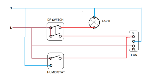

I've presented this to the owner but she isn't keen on a DP switch unfortunately otherwise yes I would agree that that's the answer. A DP switch is that bit heavier to switch, she's got flush screwless brushed chrome switches and I can't find one that isn't chunkier and that requires a more positive press.

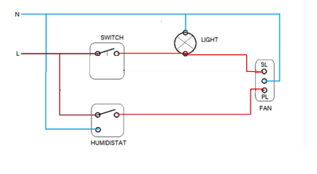

I've also presented the option of simply having the overrun controlled by the fan rather than the humidistat. I thought this was a good alternative because the humidistat works without the switched live, making it a humidistat only with no timer, so the switched live from the light could go to the fan rather than the humidistat so that the fan provides the overrun timer instead. The fan therefore receivesa switched live from the light and the permanent live terminal will have the feed switched by the humidistat.
But this will mean that the fan will only be activated when both the light is on and the humidity is raised, although it will continue to overrun when the light is turned off as long as the humidity level is still raised.
Ok. You can get DP pull cord switches.
That's always the case in that normally a humidistat just triggers the timer until the humidistat switches off.
No, that's not the case. The fan will not work with just the PL energised.
making it a humidistat only with no timer, so the switched live from the light could go to the fan rather than the humidistat so that the fan provides the overrun timer instead. The fan therefore receives a switched live from the light and the permanent live terminal will have the feed switched by the humidistat.
Ok. I think.
That is true.
It will but it will then turn off after the set time even if the humidity is still raised.
Hence asking for recommendations for a relay
Any suitably rated relay will do. I cannot recommend any.
Agh. I'll confess I've never needed to fit a relay and there are endless choices on the market so was hoping for some guidance?
Looks like I'm going to have to go down the relay route because whilst this remote humidistat only requires a permanent live and the fan and the humidistat are operating as I described, it unfortunately doesn't meet the client's expectations as it doesn't clear the air after a number 2 unless humidity is raised and the light has been switched on.
@PinkE
I have no idea which makes are better than others but you only need the simplest of relays which operates a one-way switch; i.e. connects two separate contacts together; when activated.
Just letting you know this was super easy when it came to it, thanks. I was just nervous having never worked with a relay before. Everyone's happy, thanks for talking me through it.
