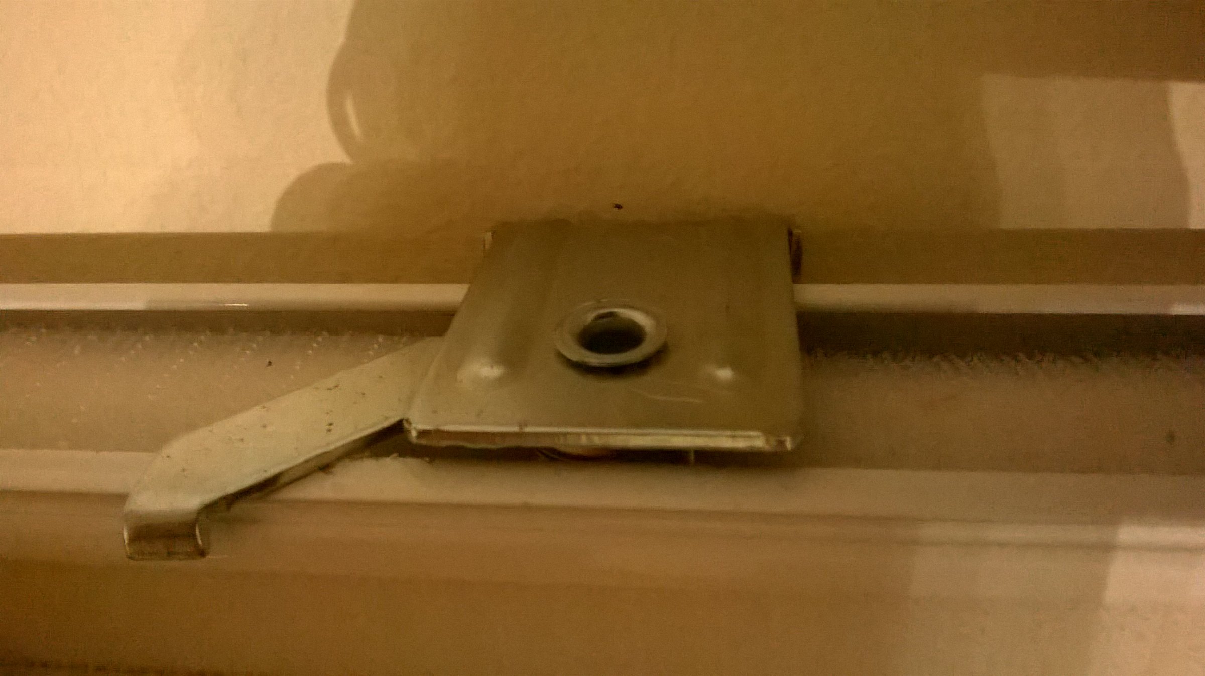

Hoping someone can help me please. I am trying to remove a blind so i can paint behind it, but i cannot see how to take it off. The blinds are on a right angled bracket and i cannot access the screw on the bracket into the wall - the blind is in the way. So from the top i have taken a picture - this seems to be the only way to remove it, but it doesn't seem obvious and I don't want to mess it up. Does the round bit need to be 'levered' up?
Please can someone advise me? Thanks!

I know what you mean about the plastic pegs - I have some other blinds where these are used. But on this blind, I don't think it's the peg type. I'm sure the key is the removal of these brackets....

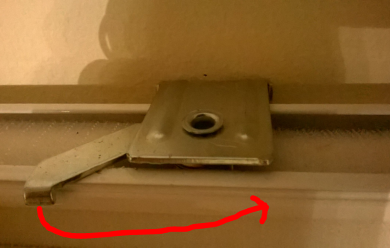

The little arm to the left is a locking mechanism. All you have to do is put your fingernail under the tab at the front (or something stronger, if needs be), pull it forward and swing it to the right, which will set the blind free.
Ok great, thank you - and great diagram too! Will give it a whirl tonight.
