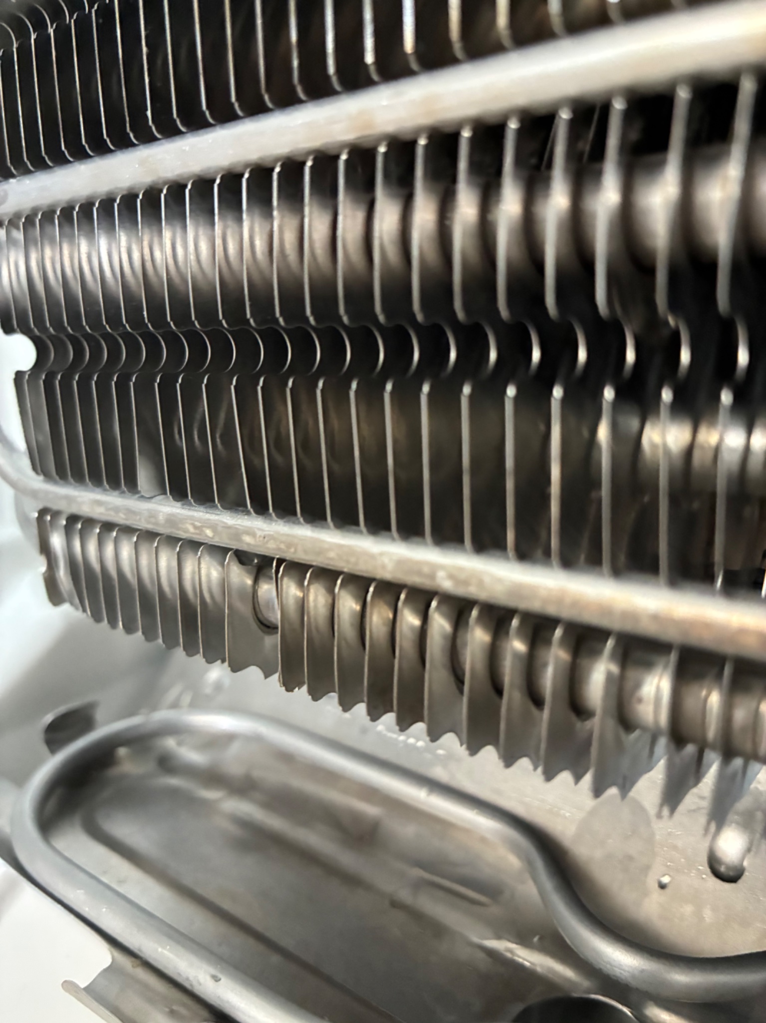

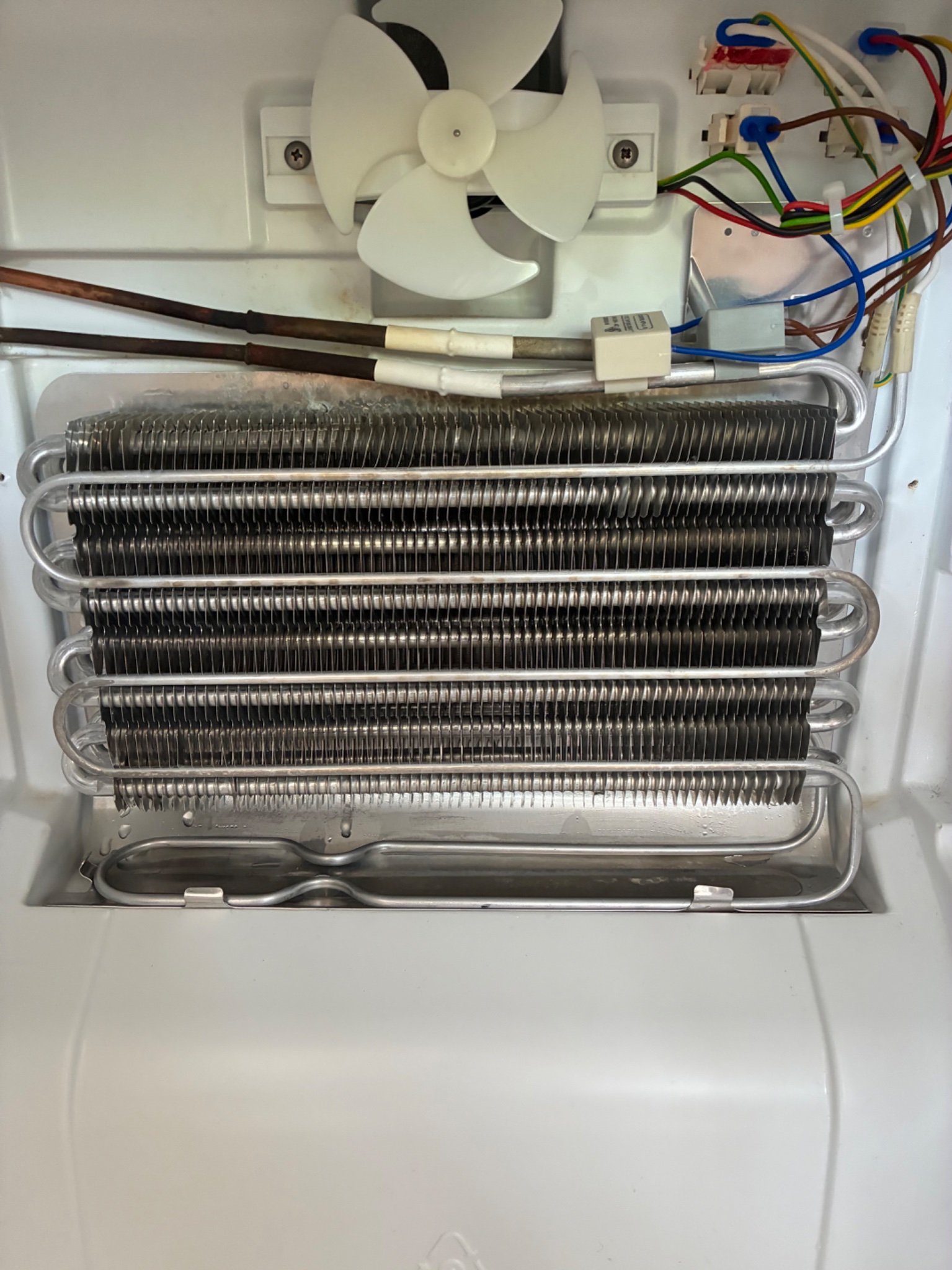

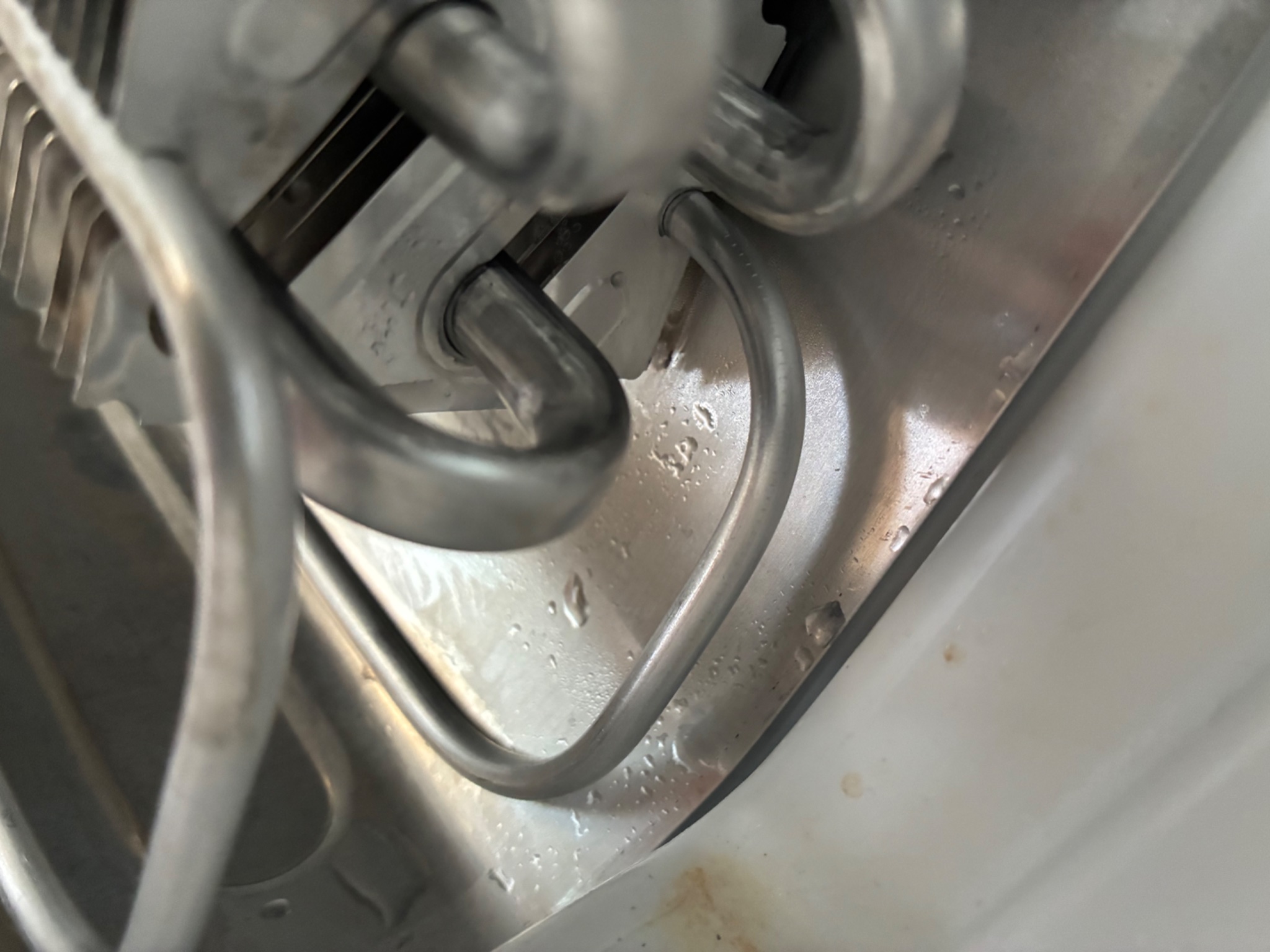

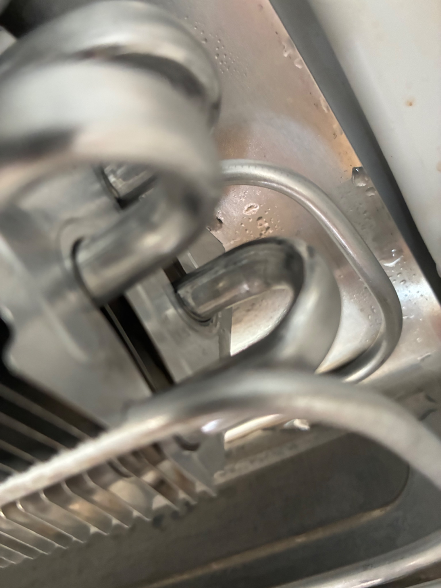

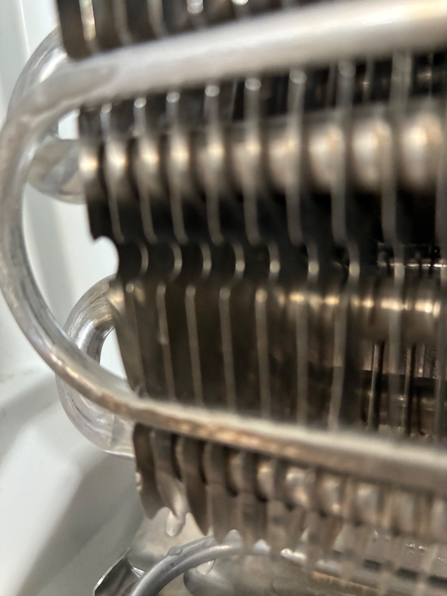

Hi there
Anyone know how to remove the freezer defrost heater on a Zanussi integrated fridge freezer - model ZBB28650SA
I had hoped that once I’d defrosted the ice from convectors that had built up, I could just pull it away from the convectors - but that doesn’t seem to be working.
I can see there are three clips on the bottom part of the heater element attaching it to the metal base - but I’ve removed these and it makes no difference.
Also, I can only easily get the the element on the front face of the convectors - no idea how I remove the element from the rear of the convectors?!
Any advice appreciated. Some pics attached.

I don't know the answer.
Surely the pipes running to it from the behind are rigid?
Edit: sorry, only just noticed that the pipes running up look flexible.
The convectors completely ice up over a period of a few weeks and its needs continual defrosting to restore normal freezer function.
I tried testing continuity with a multi meter too and that suggested it may be not be working / or not working as it should.
