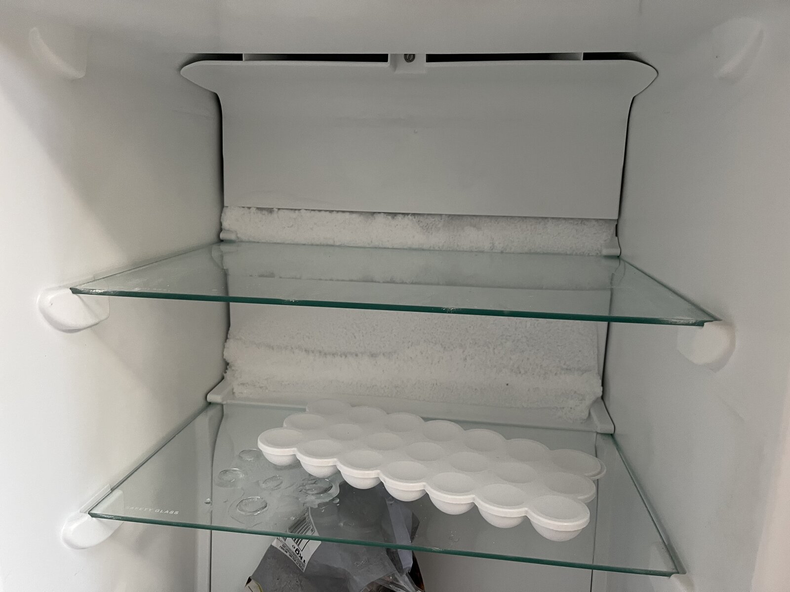

Had the Zanussi seven years. Noticed recently freezer not getting cold enough and some food defrosting. Top shelf seems to be the worse. Fridge working ok.
Attached picture of freezer compartment.
Any ideas what's going on? Or should I think about getting a new fridge/freezer?
Appreciate any help/advice.
It looks like that panel at the back of the freezer comes off pretty easily, it would be worth taking that off when you defrost it, I bet it's solid behind that.
