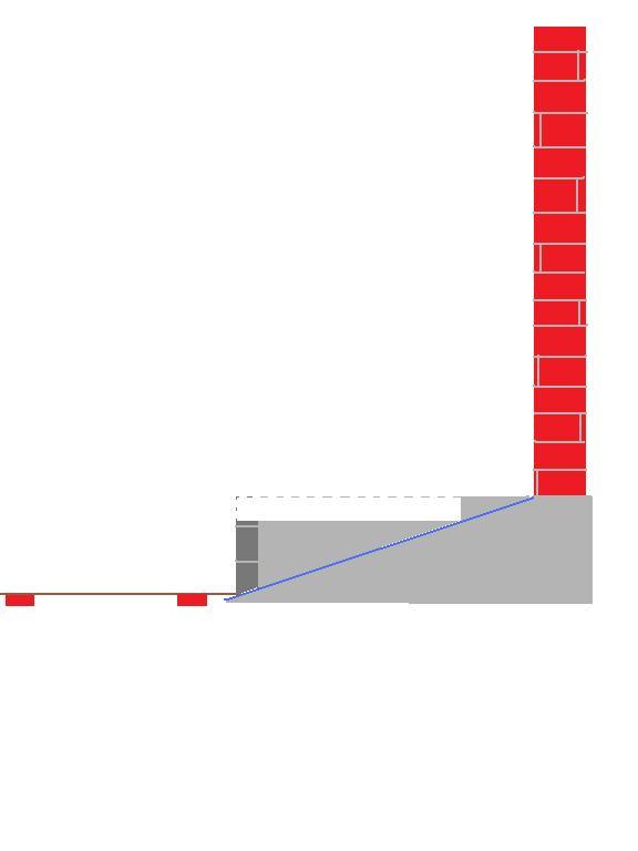

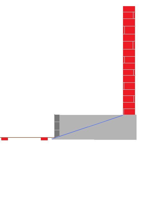

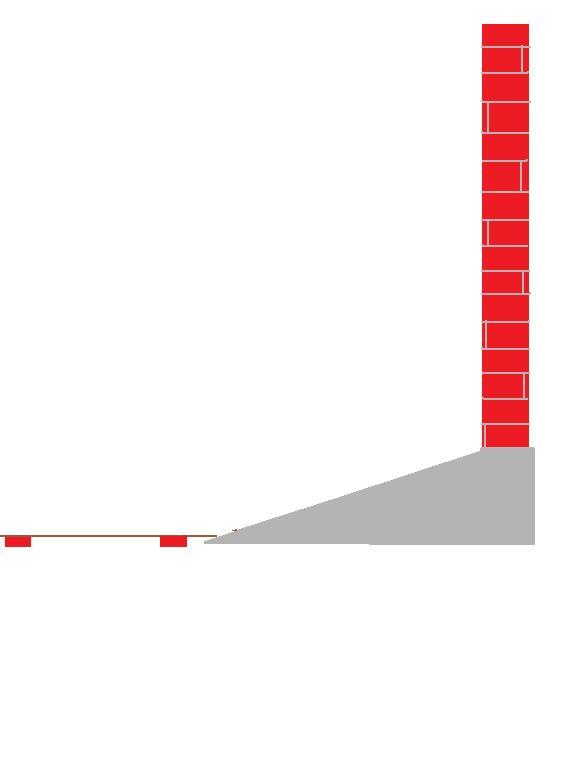

I'm doing a cellar conversion and I need to remove a "slice" of concrete from the floor. I'll try to explain.
The original cellar construction had a sloping "floor" to take account of the house being on the side of a hill. I've tried to show here:
Later, someone came along and levelled off that part of the floor (I presume because that makes it more usable) by adding a polythene sheet, building a little retaining wall and back-filling with concrete.
I want to lower the top of it a bit. I am willing to live with a "step" at the back as it will be behind seating anwyay. I need to lose about 10-15cm height.
I'm not sure how to go about this. My thinking is to angle-grind the line near the main wall where I want the step, angle-grind across the front of the retaining wall, perhaps grind a criss-cross pattern into the concrete to aid breaking, and then set about almost carving it out with a cold chisel. Ultimately then level the new surface with some more concrete or self-levelling compound or similar.
Is there a better way? That's going to be a LOT of very hard work.
Thanks!
-Mark
That's how I'd do it, but if a large area I'd be thinking of hiring something with a bit more grunt. How wide is this section, maybe you can get a floor cutting saw in there, which would cut full depth.
It's about 3m wide and about 1m deep.
Just googled for a floor cutting saw and it looks like it's worth further investigation - thanks!

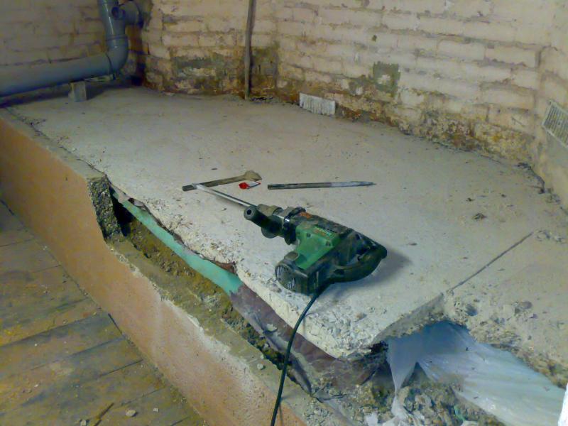

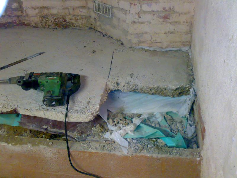

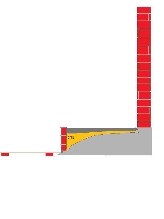

OK, bit of an update on this.
I took off part of the wall and it turns out the actual construction is a bit different to what I thought. It's something like this:
The top layer of concrete varies quite a bit in thickness but it's broadly around 10cm. I actually need to remove it and redo it, because the damp proof sheet (shown in blue) is rubbish - it's a load of old building sand bags and bin liners, and there's a big damp patch. Ideally I'll rebuild it a bit smaller, possibly from wood rather than concrete. Anway...
I have got a concrete breaker to take apart the top layer, but it's really really hard work. I got a brand new pointed bit, drilled three holes, and it's now completely blunt. An hour of really hard work later I have removed about 1 square foot of the concrete.
There simply has to be a better way - at this rate we're looking at 200 drill bits and about a week of solid work. Not going to happen.
Any suggestions?
Am I using the right tools? Pointy bit rather than a chisel or a flat one? Is the breaker big enough? How long would one expect the bit to stay sharp? I could cope with getting through a few bits but 3 holes is ridiculous...
Thanks!
-Mark
the breaker is more of the sort of breaker id expect to use for brickwork etc. you need a decent size concrete breaker. Looking at that concrete it would go through it in no time.
Thanks Thermo. OK, so I'm looking at one of the sort of stand-up ones?
Actually I just tried the low-tech approach: sledge hammer and crowbar. Got twice as much done in 5 minutes as I did in an hour with the breaker - it helps that I have hollowed out a lot of the sand from underneath so the concrete can "fall away".
Doing the lot is still going to be hard work with a sledge hammer - do you reckon it's worth getting a bigger breaker, all things considered?
Thanks for the reply!
if its hollow underneath a sledge hammer and pry bar under it will do well. If not you want a decent jack hammer, although youll need an electric one because of the ventilation. Best to work a line across the concrete about 8-12 inches from the free edge. It should just start to crack away from the main mass as you go then. Once you get going its fairly easy.
