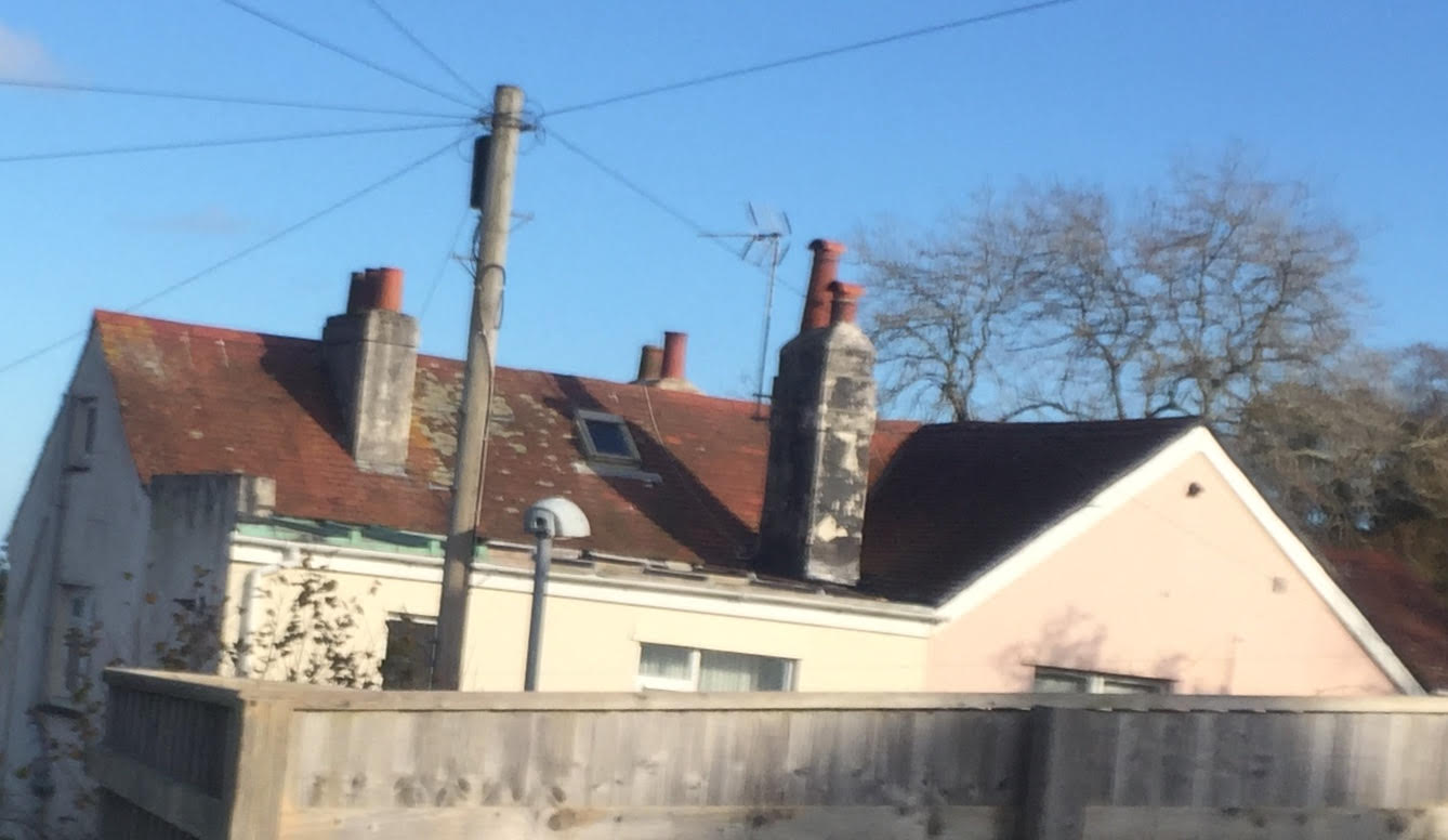

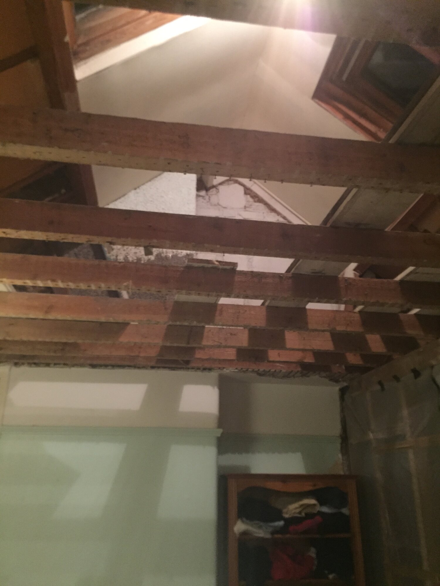

I am exposing the roof space in the master bedroom in my little 2 bed semi-detached house.
The Purlins in two corners are not meeting an end wall but they are supported with vertical props, and there is no evidence of roof sagging.
For the pitch that meets the flat roof RSJ, the ceiling/rafter ties are simply sitting toenailed onto the RSJ.
For the pitch that meets the exterior back wall, the ceiling/rafter ties appear to be joined to each rafter.
Therefore I believe the ceiling/rafter ties are preventing roof sag
Q: I am going to finish insulating and boarding the roof, then painting everything including the ceiling ties white.
Or I could:
1) Pair-up the centre ceiling/rafter ties bolting two together to reduce the number of spanning beams from 6 to 3. Advisable?
2) Raise all ceiling/rafter ties up to 1/3rd rafter length above wall plates, and add collar ties in top 1/3rd. Risky?
Appreciate your thoughts!
