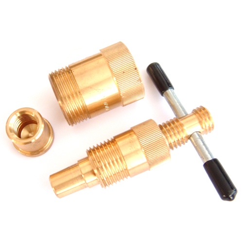

Ahh, olive splitters. They're OK but you need one for each size and still need access to the olive. I use these as they have yet to fail to remove an olive yet (that hasn't been strangled and destroyed the pipe) and does both 15 and 22mm.
Jon
I also use these
and in all situations where the nut can be pushed free to reveal the olive they are the gentlemens' relish, the dachshund's danglies, the bog's Dollocks.

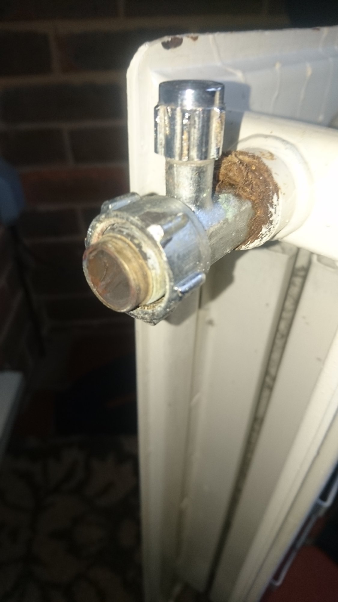

1st look at the state of the valve tails they are the old type with a nut instead of a pop off plastic cap
2 nd they are crudded up with crap, which you can clean up and re ptfe threads, but is it worth it.
They look battered and knocked anyway. You can buy the drain off valves separate and cheap.
If your adamant to reuse all you do is get your adjustable spanner between nut/ olive and square edges ( which is screwed into rad)
And use the spanner as a crowbar . The olive and nut will move to the point it falls off... Job done
No cutting .. No olive cutters etc.
I've never known one valve that had beat me and it's all finished in 30 seconds.
Because the tail is brass with chrome the olive doesn't deform like on copper pipe so you can always get it off.
Ps- a hammer will never do it because your putting force on to a point ! But using a spanner the force is equal on both sides so it comes off easy
