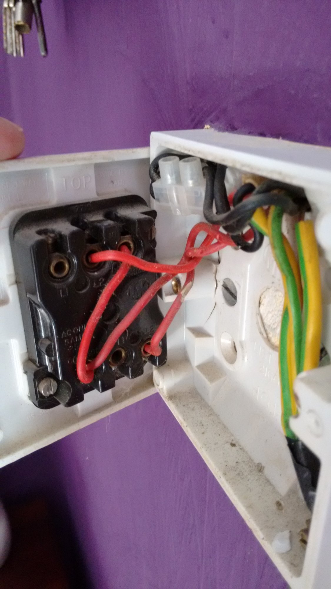

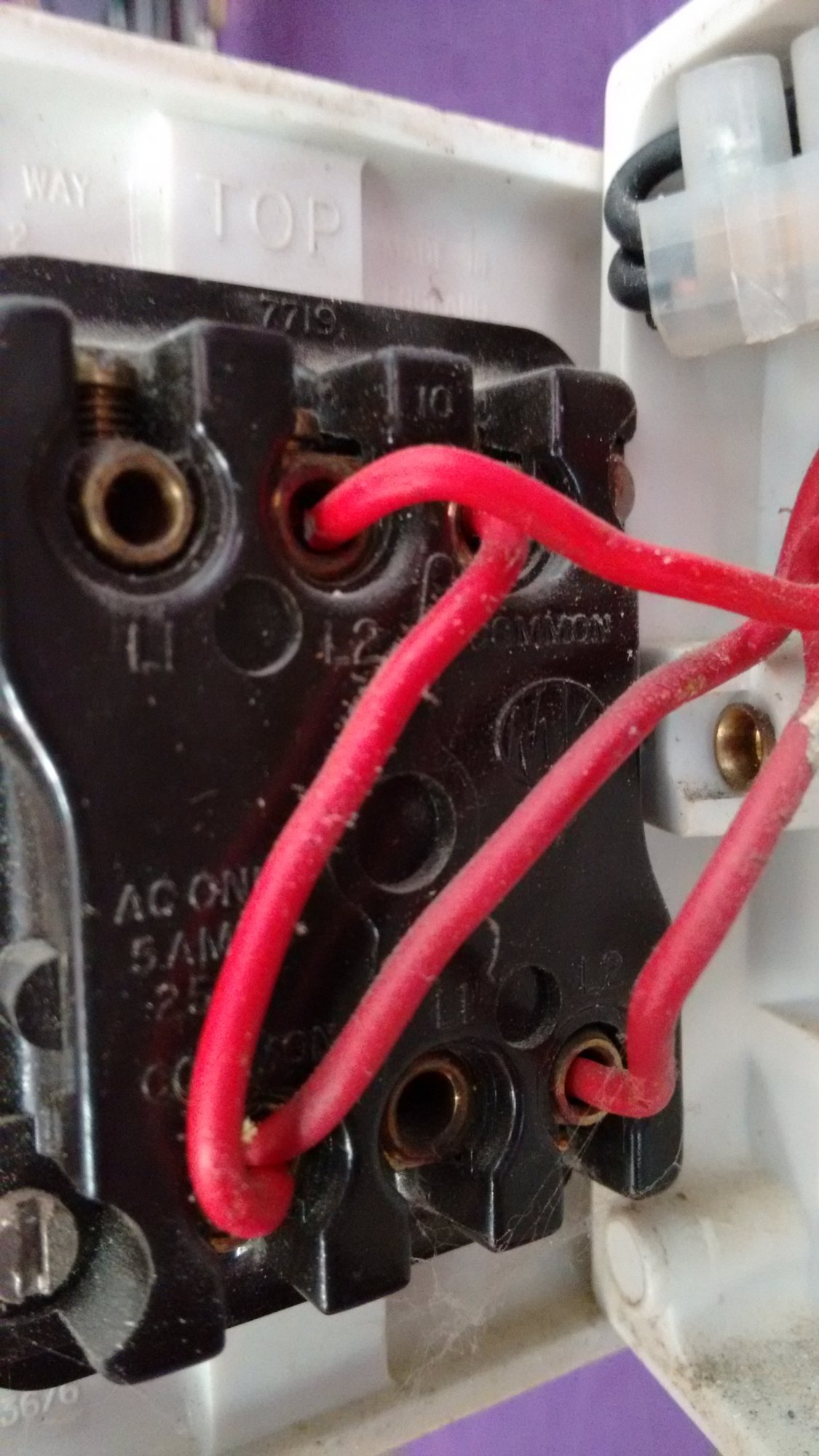

Here are a couple of photo's i've just taken, if a multi-meter is required i will get one tomorrow.
The left switch (nearest the wall in the photo) is the one that is no longer required.
So in com of the left gang and com of the right gang, you have a red that links permanent live across the two gangs, this can be removed. Before removal safely isolate circuit and you must prove the circuit is dead, prior to working on it. Removing this link should? then remove power to the external light.
It would also then be wise to disconnect the red switch live L2 of the left hand gang, if the cables are in sets of twins and earth, you can then disconnect the neutral (black) that is associated with switch live of left gang and the earth that is associated with this. I would then test the circuit continuity of these cables between switch position and external light/junction box. If continuity is proved they can either be removed or terminated safely. I would normally terminate them all together in same connector.
If this proves to be satisfactory the two gang can then be replaced with a single gang switch, copying what you have on the right hand gang, and keeping the remaining neutrals (blacks) and earths (green/yellow) terminated as they are, unless you install a metallic switch, the earths must be connected to the earth terminal on switch.

By taking that photo i follow and understand what you are saying. I will be replacing with a cheap plastic 1 gang switch from screwfix.
After doing this i can take the cable from the outside light and remove up to the junction box and make safe in there, so should in the future i want to reinstall an outside light i have the means to do so.
